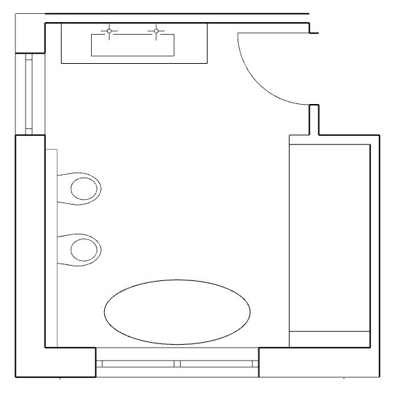

On a whim, I tried something completely different—please don’t laugh:
My thoughts:
- The shower has a “walk-in” style while still having a door—possibly inward or pivot opening?
- With the enclosure length of 230cm (7 ft 7 in), the door, which is the part requiring the most cleaning, should get little to no water splashes?
- Would a towel holder or warmer on the north wall of the enclosure make sense? Then you wouldn’t even have to open the door to the colder exterior to grab a towel. 😉
- We shower infrequently, so the freestanding bathtub mainly offers the advantage of easier window access due to its shape. Of course, it also looks great, and maybe there’s an affordable model that doesn’t require selling several organs.
- The toilets still feel a bit isolated in the space... But as ypg already pointed out, it’s just the two of us, the bathroom is often used by only one person, and there is still a guest toilet.
- The washbasin remains on the north wall as before. Maybe forgo the tall cabinet next to it and make it as wide as possible (180cm (6 ft)).
