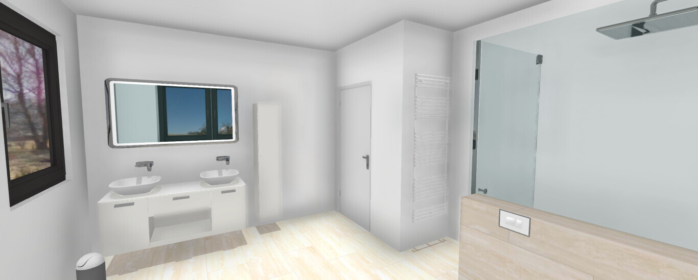

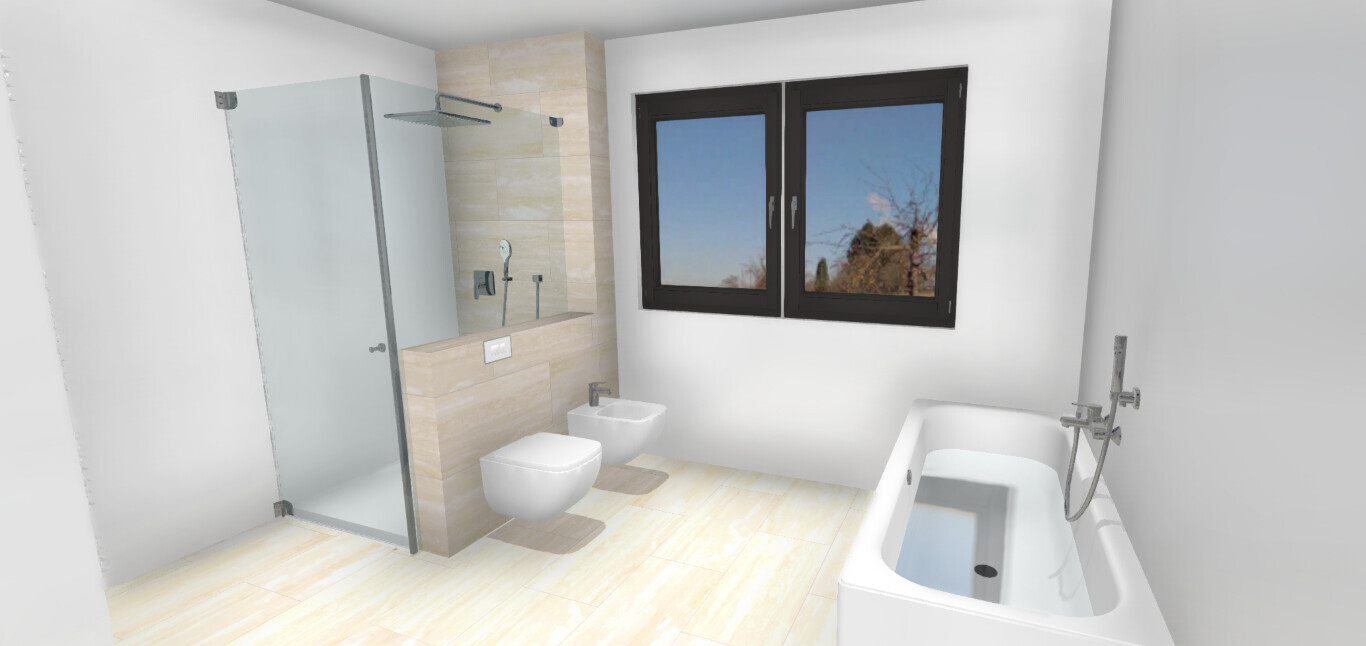

3 Jul 2022 01:14
I quickly recreated the design from #4 in the planner; it looks pretty good:
Modern bathroom with glass shower, toilet, bidet, bathtub, and window
Bright bathroom with double sink, mirror, window, and shower.
The bidet and toilet are now placed along a 140cm (55 inch) wall, probably a bit tight. If necessary, the partition wall or shower tray could be extended by 10–20cm (4–8 inches), although this is actually unnecessary because of the door 🤨
Regards,
Hausbaufaehig
Tigerlily3 Jul 2022 08:21
Hausbaufaehig schrieb:
I quickly recreated the design from #4 in the planner, it looks pretty okay:
Agreed, visually okay, but too tight regarding the toilet/bidet area!
30cm (12 inches) + bidet 40cm (16 inches) + clearance 30cm (12 inches) + toilet 40cm (16 inches) = 140cm (55 inches).
An additional 10 or 20cm (4 or 8 inches) would be the “distance” from the toilet to the end of the half-height wall. I can’t judge how that looks visually without a photo edit.
However, that would make the wall unnecessarily long. In terms of space, you have enough room to move on the right side of the toilet (when seated). How wide is the passage to the shower?
I would place the toilet next to the window since you spend more time sitting there, and having the window nearby offers more privacy.
Consider whether you really value the advantages of a bidet (we had one for a long time and found it practical for quickly washing feet or soaking/rinsing a swimsuit; otherwise, I can’t think of other benefits). A shower toilet is much more comfortable to sit on and offers various more convenient washing options; we tried one in a bathroom showroom’s customer restroom and were convinced afterwards. Regarding price: we never missed the drying function, the basic version is fine.

I would prefer the original design number 4. Since you have a second window, you don’t need to access the window above the bathtub as often. I wouldn’t like design number 2 because I don’t want to sit on the toilet with my back to the door.
I also like the design from post 4. I don’t think it’s too tight. You can just try it out. If necessary, you can extend the wall by 10cm (4 inches).
kbt09
3 Jul 2022 09:48
I also really like the design from post 4. The windows are all easily accessible, and yet the room still has a clear structure.
