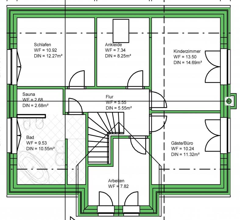

Hello dear house building forum users,
I am the "newcomer" here. I have been using the forum for a while for ideas and tips.
I am from Hamburg and will be building a house in April.
Like everyone else 🙂 we also have a problem with the bathroom layout.
We don’t really like looking directly at the shower when entering the bathroom.
Also, I don’t find the toilet placed directly in front of the window very appealing 🙂
Maybe one of the clever users has an idea? We are a bit too close to the situation to see clearly.

Two-dimensional house floor plan with entrance area, rooms, and doors in the green frame

Image now enlarged again 😉
2D floor plan of a house with bedroom, children's room, guest room, bathroom, hallway, and sauna

According to the architect, this is supposed to be a shower.
It is probably a cave shower.
emer8 Feb 2014 09:29
I would consider extending the wall along the staircase. This would mean that the bedroom is no longer accessible from the hallway, but the walk-in closet can serve as a passageway. Possibly also move the bathroom door to a different location.
emer8 Feb 2014 09:32
This means that the bathroom door will also be located on this wall.
