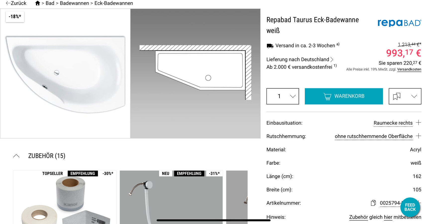

You could try recreating this. You might be able to do without a full glass wall and perhaps even make the bathtub larger.

I would avoid these rectangular bathtubs. In a bathroom, tactile and soft shapes work better than angular ones.
I can recommend something like this as a “space-saving bathtub.” I had one from Kaldewei installed in a terraced house bathroom, and it even worked for two people because it was deeper—about 46 cm (18 inches) instead of 42 cm (16.5 inches). That makes a big difference with small tubs. You sit, but you are properly covered by water.

The bathtub shape is also very interesting; hopefully, we can find a similar one to try out. Fortunately, our current model is much more rounded in reality than shown, and I added the extra space at the head area afterwards to make it even more comfortable.
