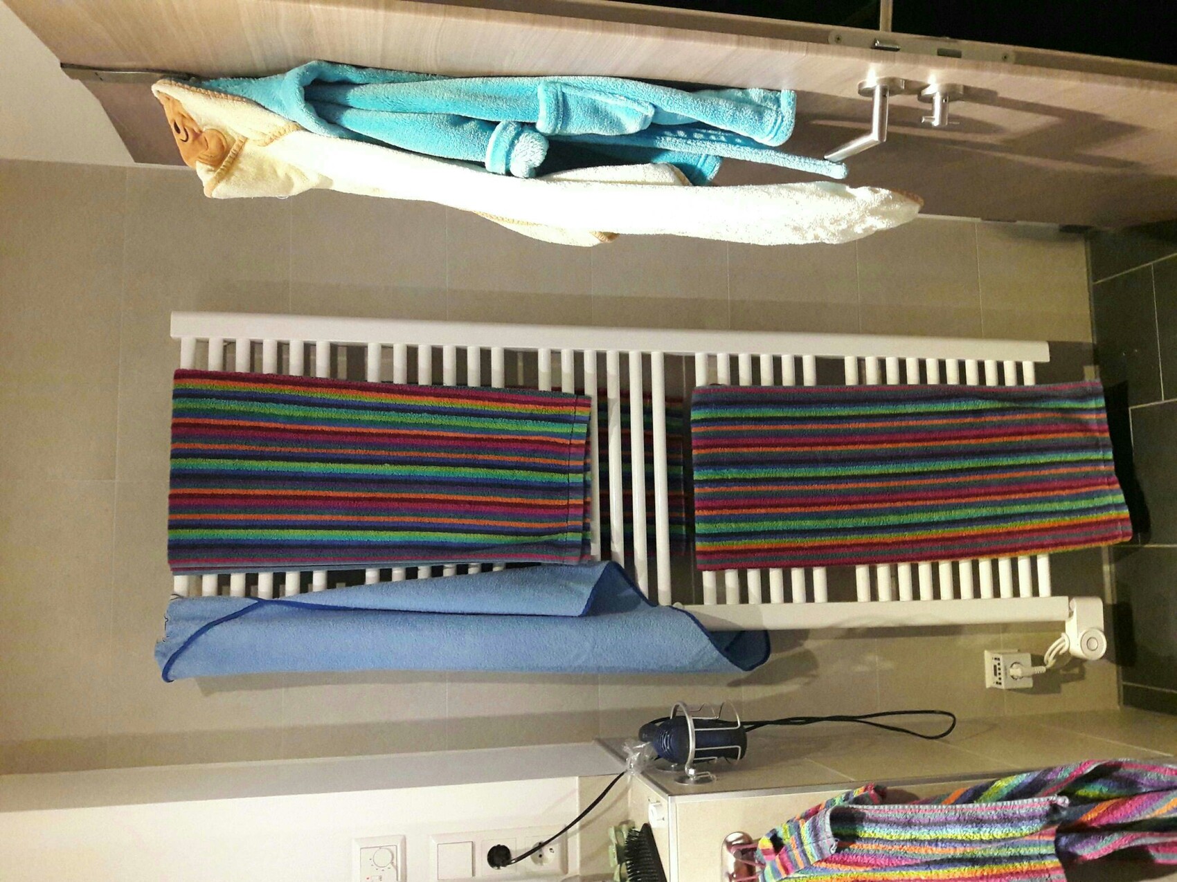

If you are expecting small children and the cartridge allows it... place the socket and control unit higher up.
