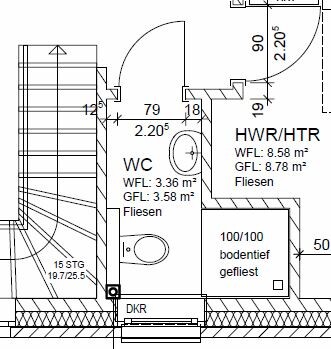

I would like to ask a question on this topic as well:
We have a shower in the guest bathroom on the ground floor, and we are considering installing a heated towel rail with an electric heating element on one of the walls to hang towels. Would this make sense? We also have underfloor heating throughout the house, which is heated by an air-to-water heat pump.
If it does make sense, where would be the best place to position it?

Thank you in advance for the answers! My main concern is the functionality of the towel holder since we will need some kind of fixture for it anyway in the small bathroom. This way, we could install a towel radiator at the same time.
@toxi: Honestly, I’m not sure if the bathroom will have its own thermostat. As far as I know, each room gets a thermostat. I’d have to check on that.
The position is basically already set, as there is hardly any more wall space available. We were just wondering if it would make sense to install the sink next to the toilet? Not sure if that’s practical.
But we will definitely plan for a power outlet for a towel radiator on the free wall! A towel radiator with an electric heating element can probably be installed easily afterward, right?
