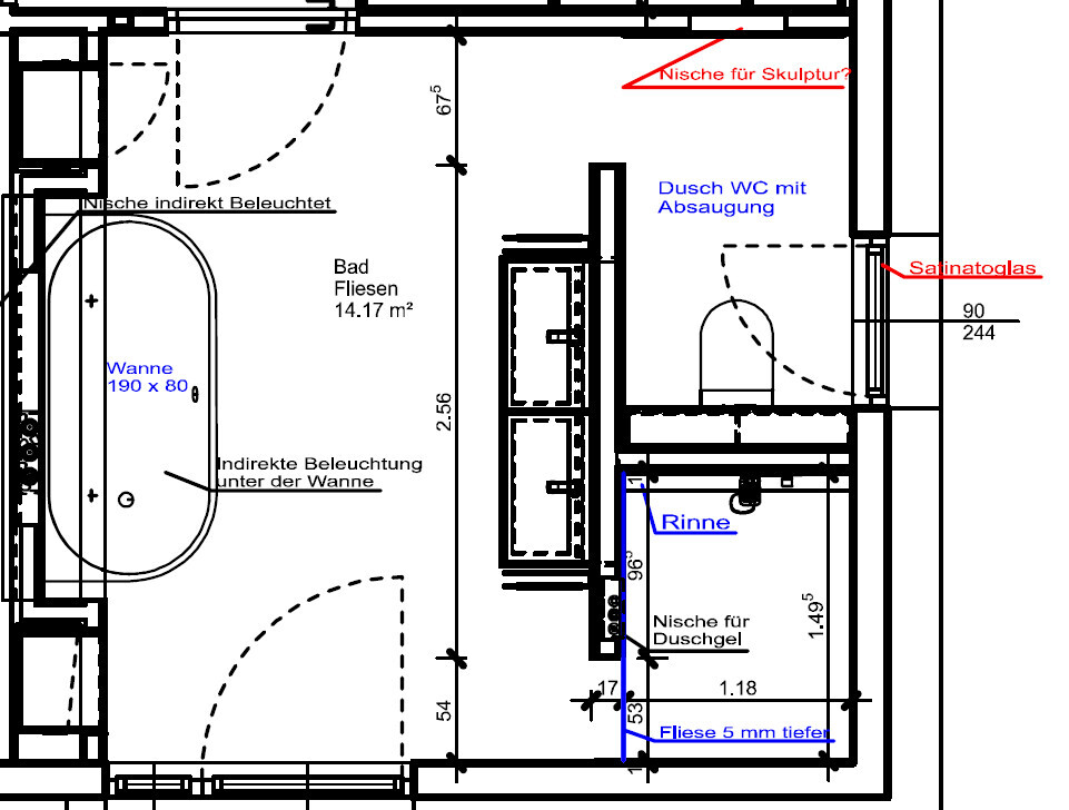

Dear forum,
We have just purchased a new apartment that is part of a newly built complex. Unfortunately, we can’t seem to find the perfect bathroom layout. At the moment, it feels like we have too much space in the center and, instead, a small shower.
Do you have any suggestions? The window on the right side, as well as the balcony door and the entrance door, are fixed (the window definitely, the doors with minimal flexibility) – the rest is still open for planning.
Thank you for your ideas!
Stefan
Bathroom floor plan: bathtub left 190×80cm (75×31 inches), shower toilet with extraction right, niche for shower gel, frosted glass
Ibdk146 Nov 2021 14:42
I actually think this is fine as it is. Of course, you could move the T-wall a bit further to the left according to the plan, but I don’t think it’s really necessary. What would bother me is the bottom stop of the balcony door. When it’s open, you can’t access the shower. The other way around, it would be less in the way.

Neither. Usually, you don’t really want four people showering at the same time...
Hangman6 Nov 2021 16:10
1.5 x 1.18 meters (5 x 3.9 feet) is huge. Any sumo wrestler would be jealous!
The note about the balcony door swing direction is worth considering.
6 Nov 2021 16:12
Overall, it’s a nice room and a nice bathroom. However, I would be concerned about the 53cm (21 inches) passage to the shower. Measure the width of the man (shoulder to shoulder). It might only be possible to enter it sideways.
Ibdk146 Nov 2021 16:20
And if the woman has broader shoulders ;-) But yes, it is a bit tight regardless of how broad the individuals are.
