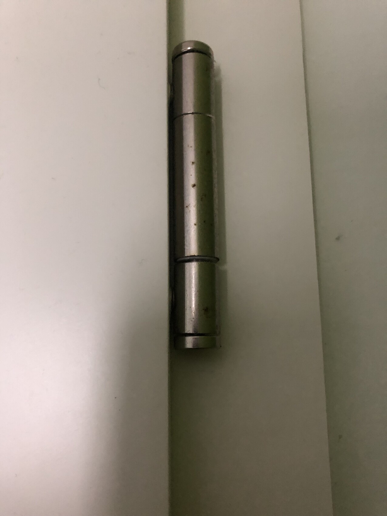

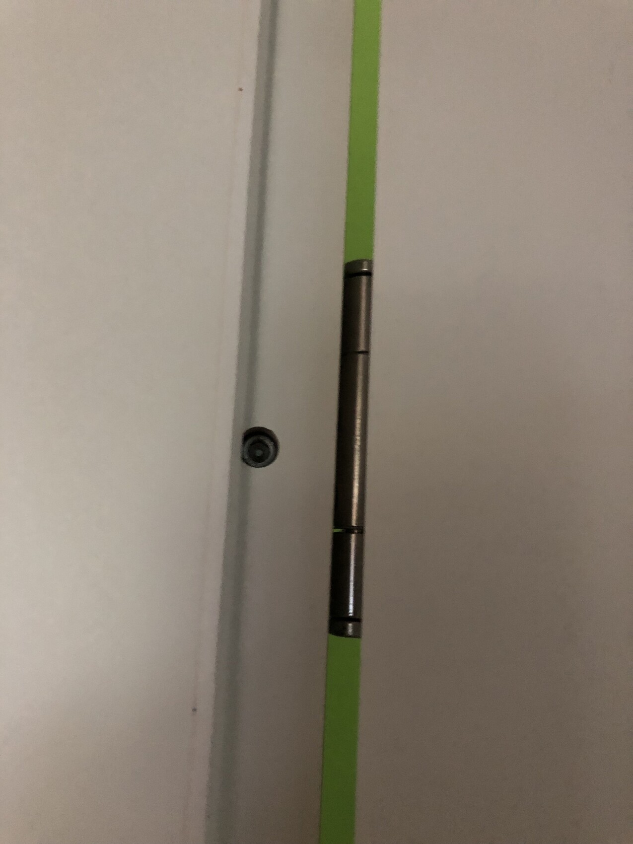

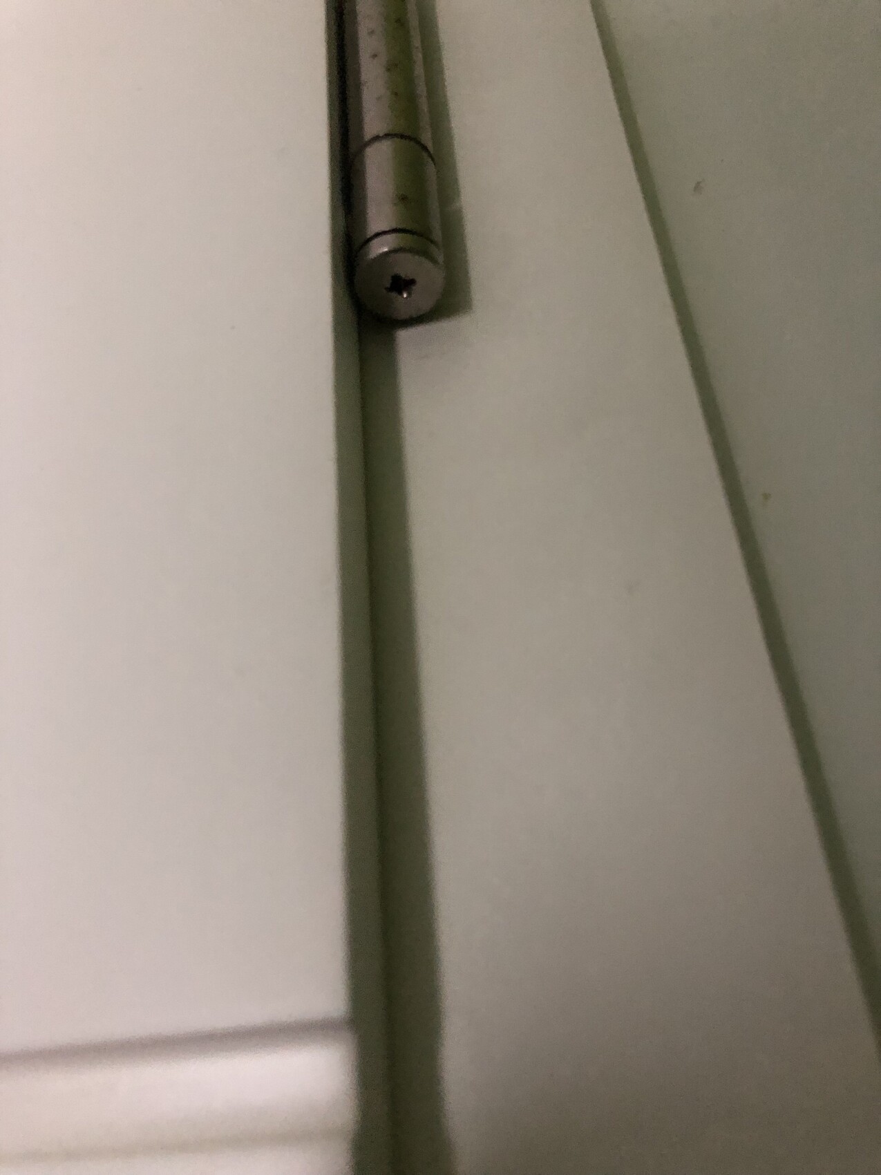

Hello, every summer the bathroom door rubs at the bottom. Can you give me a tip on where to adjust it? When the door opens, it rubs in the middle area, then it opens completely. This only happens in summer and only with the bathroom door.

You can probably unscrew the top cover at each hinge. That’s what you do. Underneath, there is an Allen screw that lifts the hinge. You turn that. The door will lift slightly. Put the cover back on, done.
