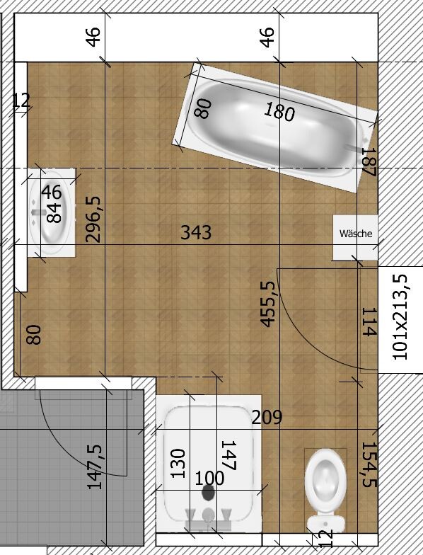

we are currently planning the layout/design of our bathroom.
What do you think about it? Do you have any suggestions on what we should do differently?
All measurements should be included. If anything is missing, just let us know.
The dashed line marks the 2-meter (6 ft 7 in) line. The 1-meter (3 ft 3 in) line starts after the 46cm (18 in) carrier wall.
Thank you
Grundriss eines Badezimmers mit Badewanne, Waschbecken und Toilette
Malz1902
21 Feb 2017 08:17
Forgot to mention, on the plan above, between the two 46cm (18 inches) measurements, there is a double casement window measuring 1.14 m x 1.18 m (3 ft 9 in x 3 ft 10 in).
