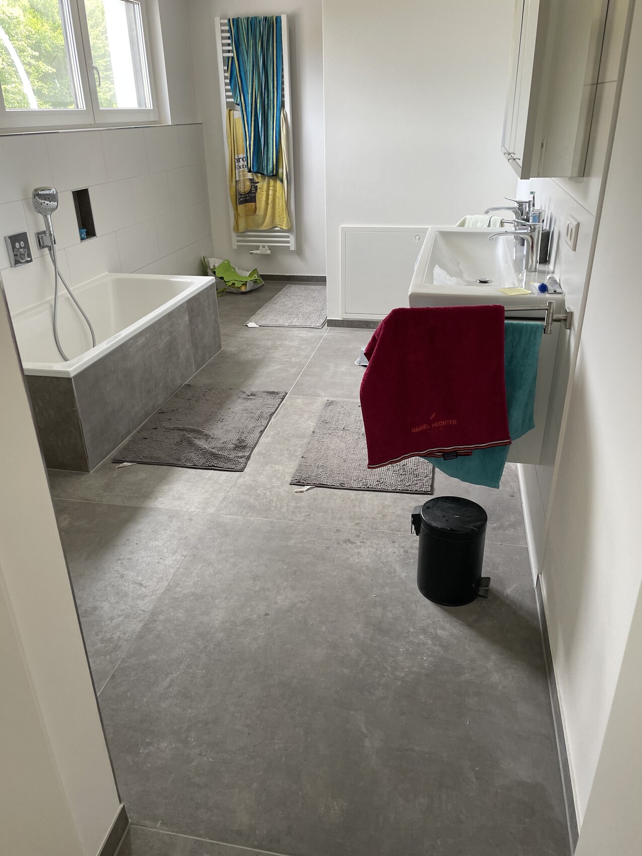

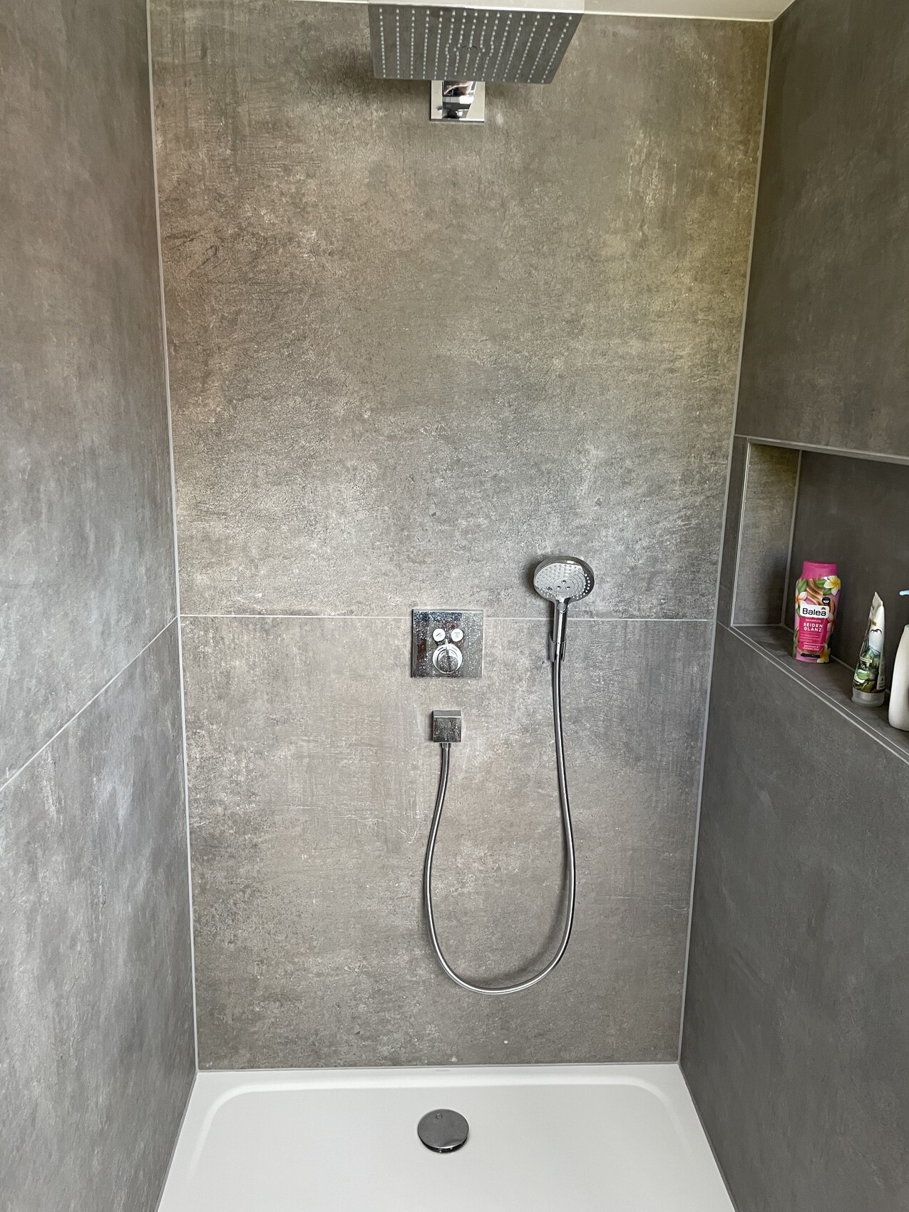

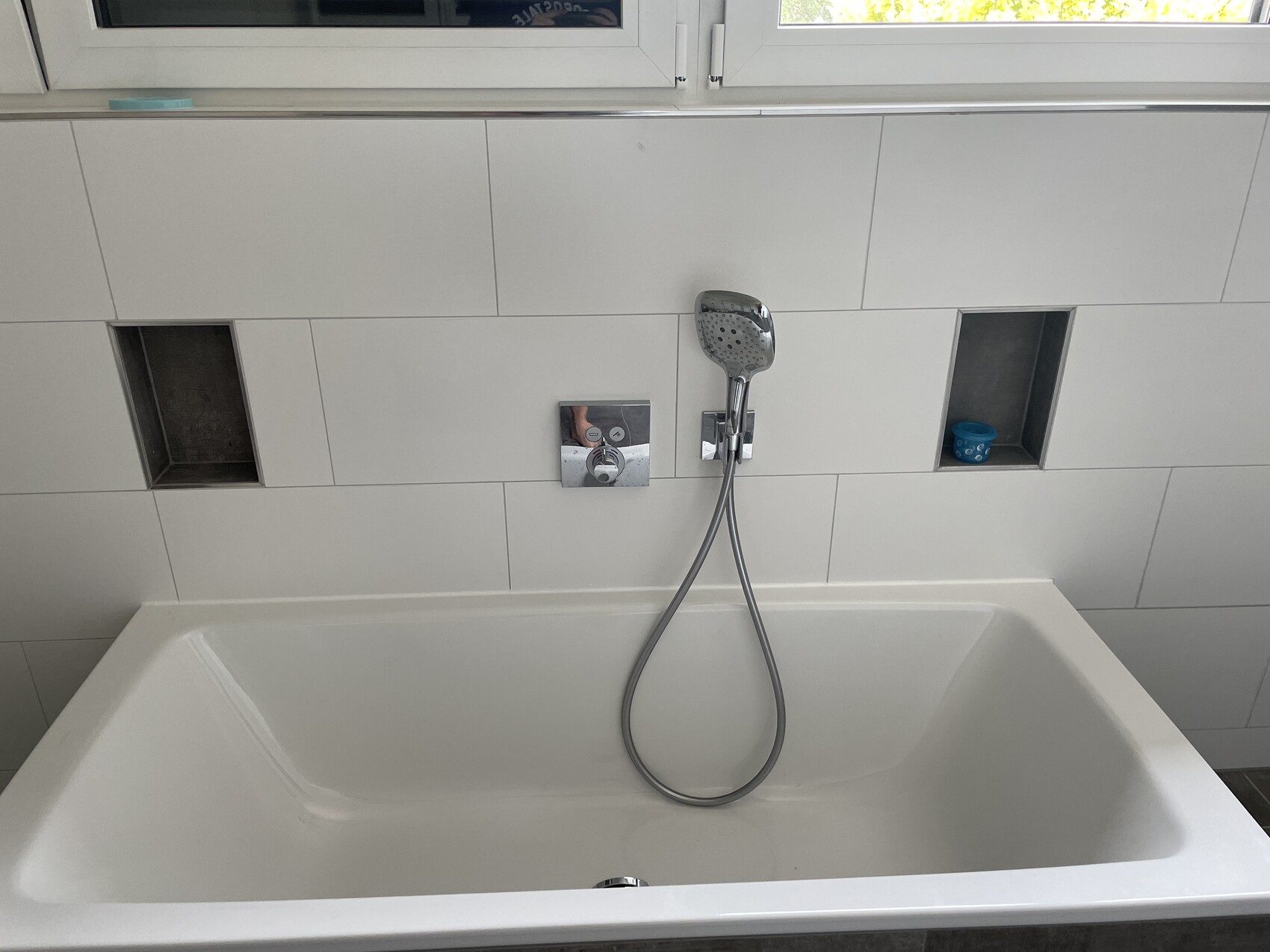

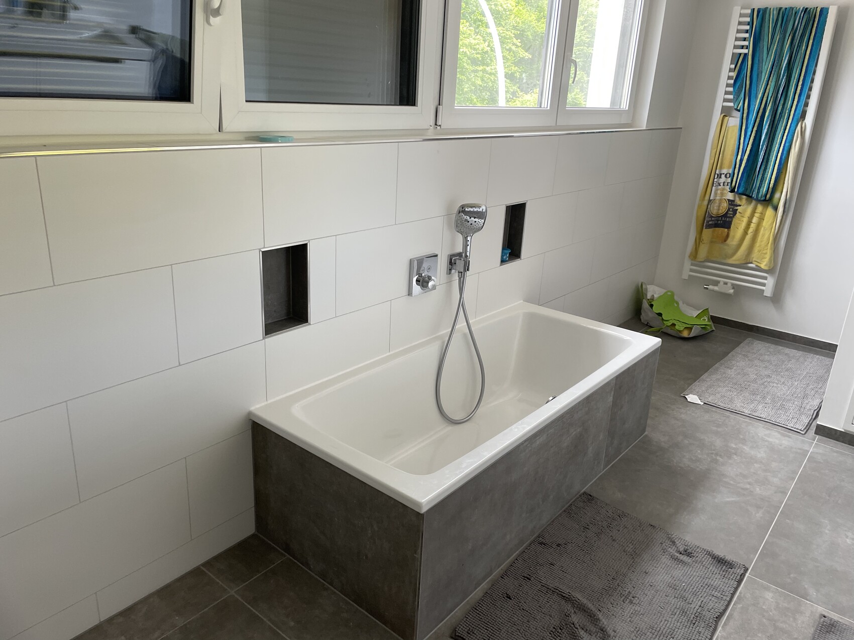

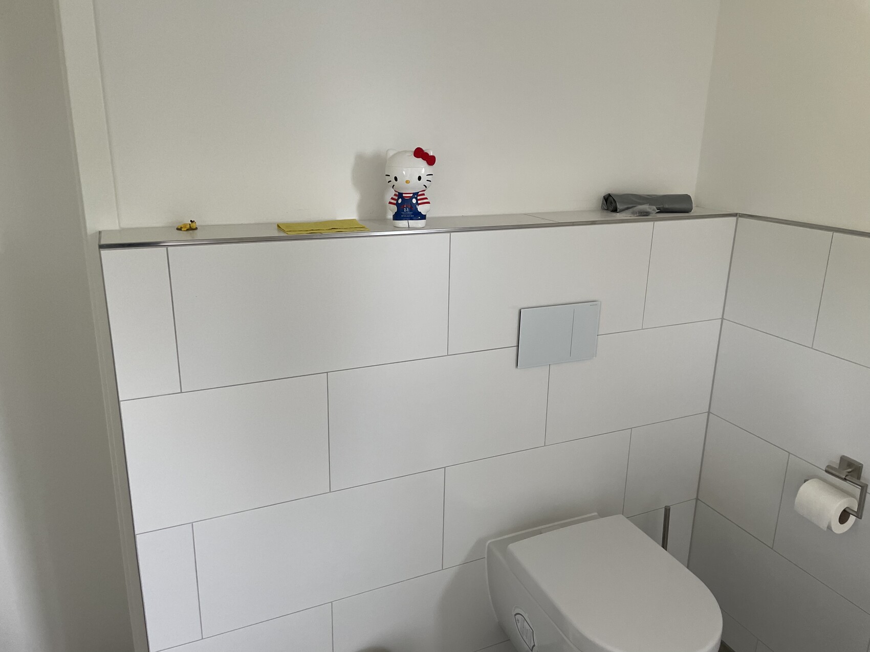

The bathroom is approximately 15sqm (160 sqft) and has a rectangular layout, see pictures.

Osnabruecker11 Jun 2022 13:27I am not a (tiling) specialist.
For large formats, small niches, etc., I would roughly estimate from 40 hours. With waterproofing, additional work in existing structures, silicone work, and so on, the total could increase to around 80 hours.
As a point of reference, you can certainly wait for other estimates, but if you agreed on a time-based arrangement, the matter is basically settled. Were you not able to supervise the work on site?

For large formats, it definitely requires 2 tile installers. About 1 week for installation. With 2 people, that’s approximately 80 hours. Then waterproofing, silicone sealing, etc. I estimate a good 100 hours in total.
Neubau202213 Jun 2022 08:13It doesn’t look like it was poorly done. As a layperson, I don’t see any mistakes or inconsistencies. In my opinion, charging by the hour was already the first mistake. Tilers know exactly how long each task takes. It makes more sense to agree on a price per square meter for different tile formats.
