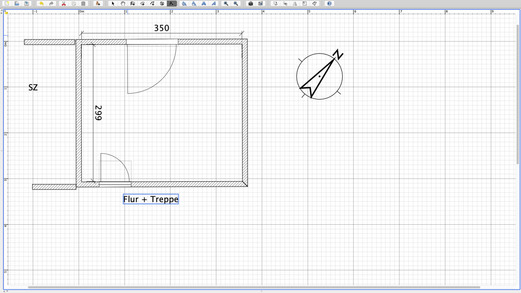

Hello, we now need to consider how to arrange the fixtures in the bathroom.
It should include:
1 bathtub, 1.80 x 0.80 meters (6 x 2.5 feet)
1 shower, 1.20 x 1.20 meters (4 x 4 feet)
1 toilet
1 washbasin
I deliberately left out any layout to avoid influencing ideas and hope for good suggestions.
Grundriss eines Flurs mit Treppe; Türöffnung, Maßangaben 350x299, Kompass.
Tolentino20 May 2020 12:28

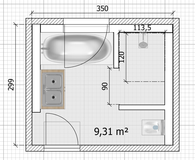

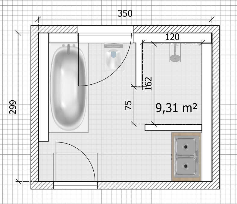

Option 1:
Bathroom floor plan: bathtub top left, sink left, shower right, toilet right
Option 2:
Bathroom floor plan: bathtub left, toilet center, shower and double sink right
What is the window sill height?
T_im_Norden
20 May 2020 14:16
Thank you for the suggestions.
We are still flexible regarding the parapet height as well as the connections.

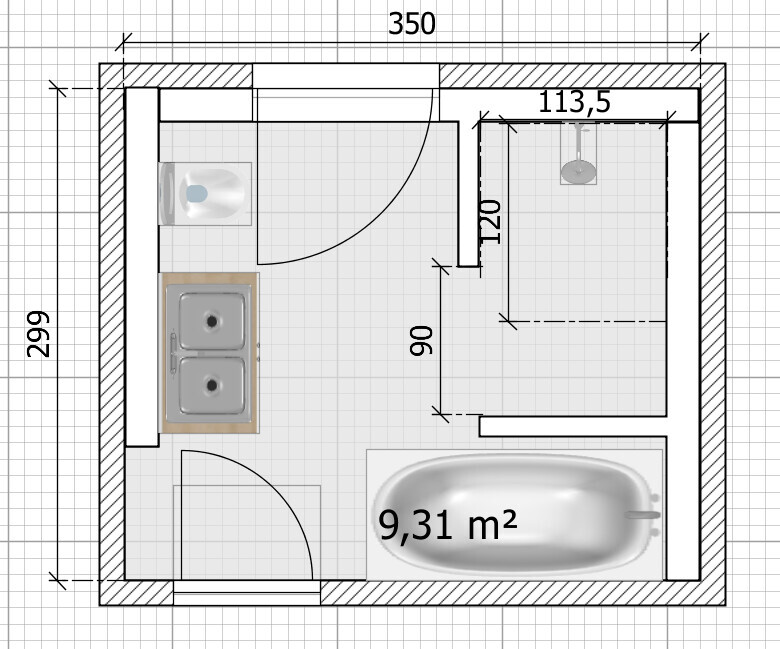

Tolentino20 May 2020 14:41
Theoretically still possible:
Floor plan of a bathroom: shower on the right, bathtub bottom right, sink on the left, toilet on the left
However, I wouldn’t necessarily place the toilet on the wall next to the bedroom.
The window and door positions are fixed, right?
T_im_Norden
20 May 2020 16:11
Yes, they are fixed.

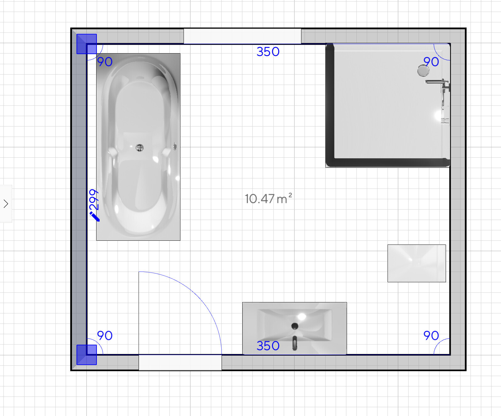

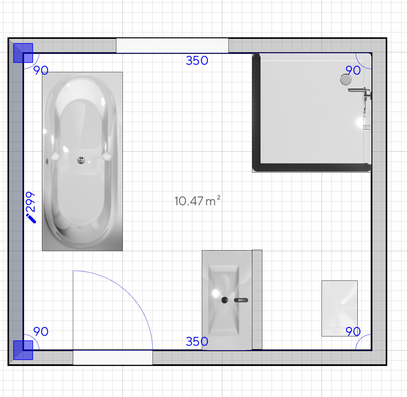

Floor plan of a bathroom: bathtub on the left, shower on the right, sink at the bottom.
This layout would also work. We don’t need a framed shower enclosure since we are using a shower tray anyway.
Floor plan of a bathroom: bathtub on the left, sink in the middle, shower on the right, 10.47 m² (113 sq ft).
kaho67420 May 2020 18:17

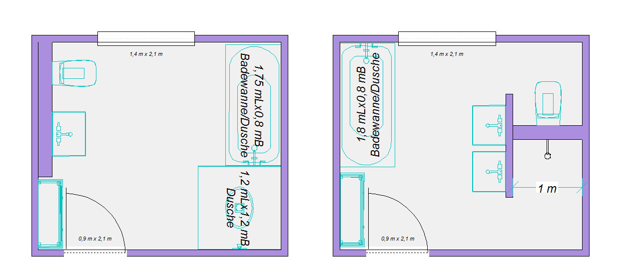

Why are you only planning the bathroom now when the windows and door are already fixed? It makes it difficult to accommodate your preferences.
I find all your drafts unsatisfactory for that reason. I would either reduce the bathtub space by 5cm (2 inches) and place the shower and bathtub on the right side of the plan, or design a T-shaped layout with a 1m (39 inches) shower and additional lighting since there is no window.
Zwei nebeneinander gezeigte Badezimmergrundrisse mit Badewanne/Dusche, Waschbecken, Toilette und Tür.
