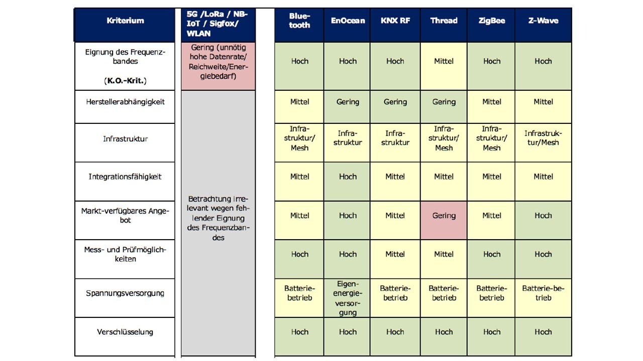

Since I am planning to build a house, I am naturally also considering smart home solutions. As this topic is completely new to me, I first need to do some research. I would therefore like to clarify some basic questions and facts before proceeding. I will simply write down my thoughts as if they were facts and would ask you to correct me where I am wrong 🙂
I want to leave KNX or BUS systems aside for now and focus only on wireless solutions, so please do not discuss which makes more sense or is "better." One step at a time; this is purely about understanding :p
There are many different wireless protocols. Open ones like Z-Wave, ZigBee; "semi-open" like eNet; and proprietary ones like Somfy io.
Somfy has the advantage that everything comes from one source and it should be plug and play. The ideal solution for beginners—you simply put together what you need, install it, and it works right away. The big disadvantage, of course, is that you can only integrate Somfy or Somfy-approved sensors and actuators and are dependent on Somfy continuing to develop new products and supporting the current protocol.
eNet is a protocol from a few premium manufacturers, and as such, the devices are quite expensive. Although it is an open protocol, it is supported by only a few providers and products. So it has the same disadvantage as Somfy: limited selection and dependency on a small number of providers.
The open protocols, which are basically standards, have the advantage of many providers. However, this is also the biggest disadvantage because it’s easy to lose oversight, you end up assembling the whole system yourself without it all coming from one source, and there are likely to be significant differences in quality.
Is this roughly correct?
