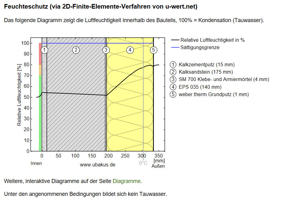

- How so? Could you please explain?Exterior Insulation / Traditional Exterior Wall Construction

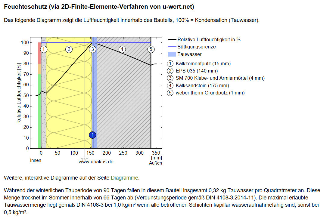

Interior Insulation – your planning
Even if this calculation supposedly shows no mold growth, the construction is very vulnerable, and if the conditions change, the situation can quickly become very different...
