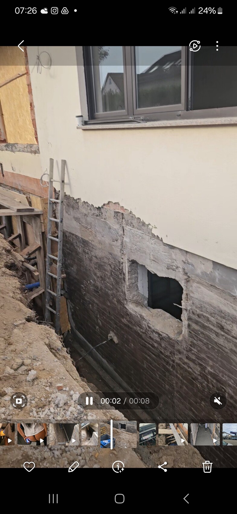

We excavated the first 5 meters (see picture 1), everything is fine, the wall goes straight down to the foundation. We can insulate this neatly and close it up again. Then we continued digging.

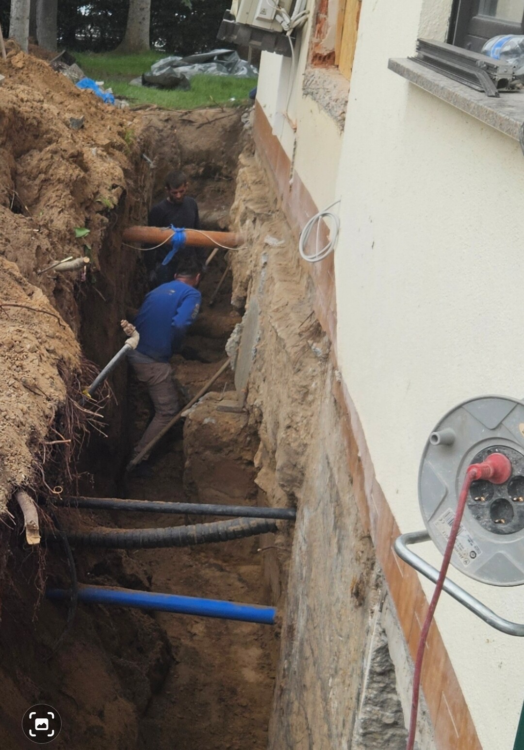

Suddenly, we noticed that the concrete only extends about 1 meter (see picture 2) and does not go straight down like a wall all the way to the bottom as it does in the first 5 meters.
After some consideration, I realized that this part of the house was added later. About 1.50 meters (5 feet) were added afterward, so this is not yet the basement wall! The basement wall only starts after a depth of 1.50 meters (5 feet). To insulate this basement wall, I would have to excavate under this additional structure to reach it. Of course, I cannot do that as it would endanger the structural integrity...

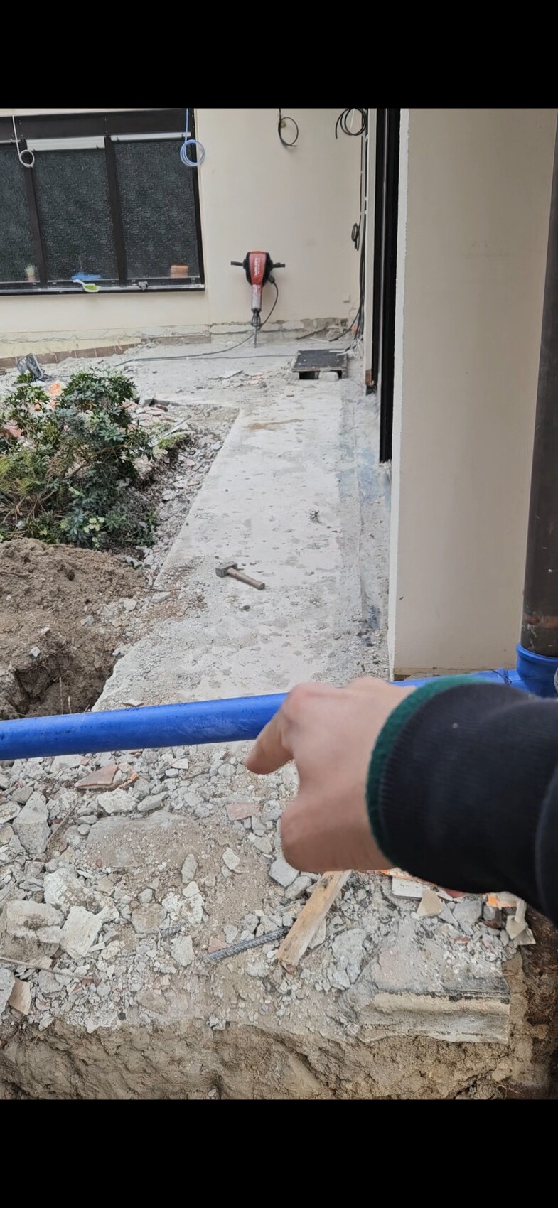

We have installed formwork and poured about 20 cm (8 inches) of concrete down to approximately the level of the actual basement wall (see picture 3). We would now insulate on this.

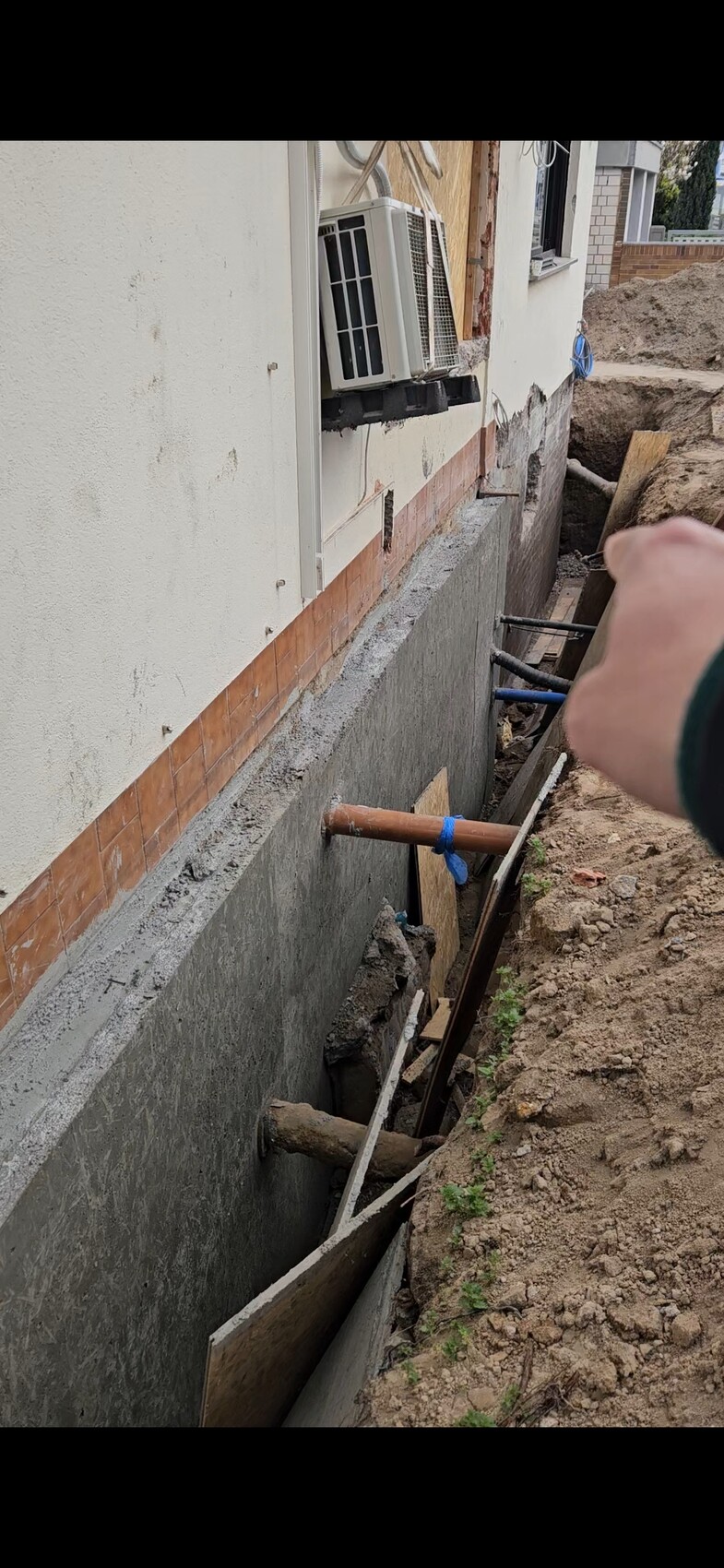

I ask because I have the same issue on the other side (see picture 4), which is another 10 meters in length, with exactly the same situation of the 1.50 meters (5 feet) distance to the real basement wall.
I would simply do the same there... excavate everything, pour a wall about 2.50 meters (8 feet) high, and then insulate on that. It is a huge effort, but since I am already at it...
