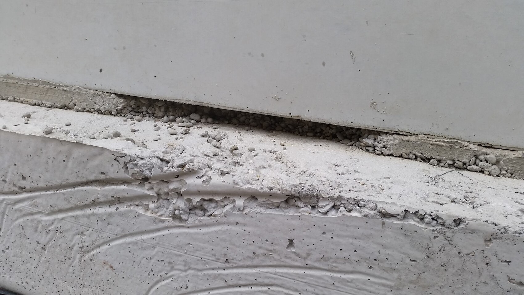

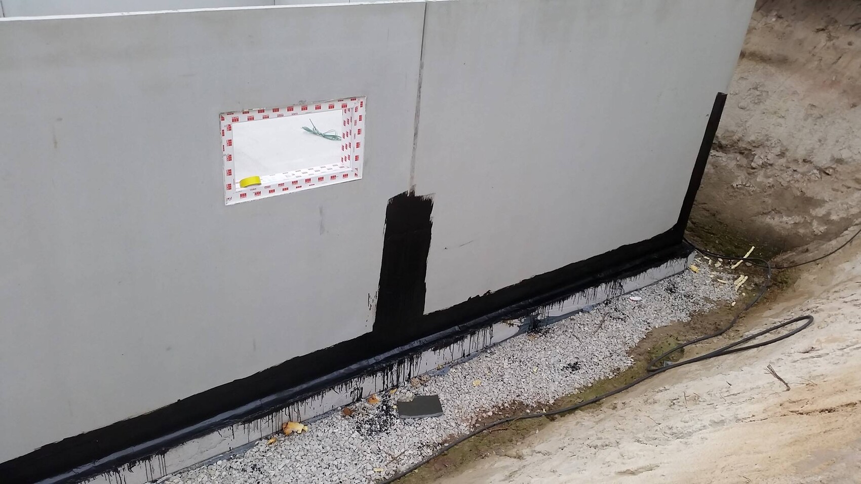

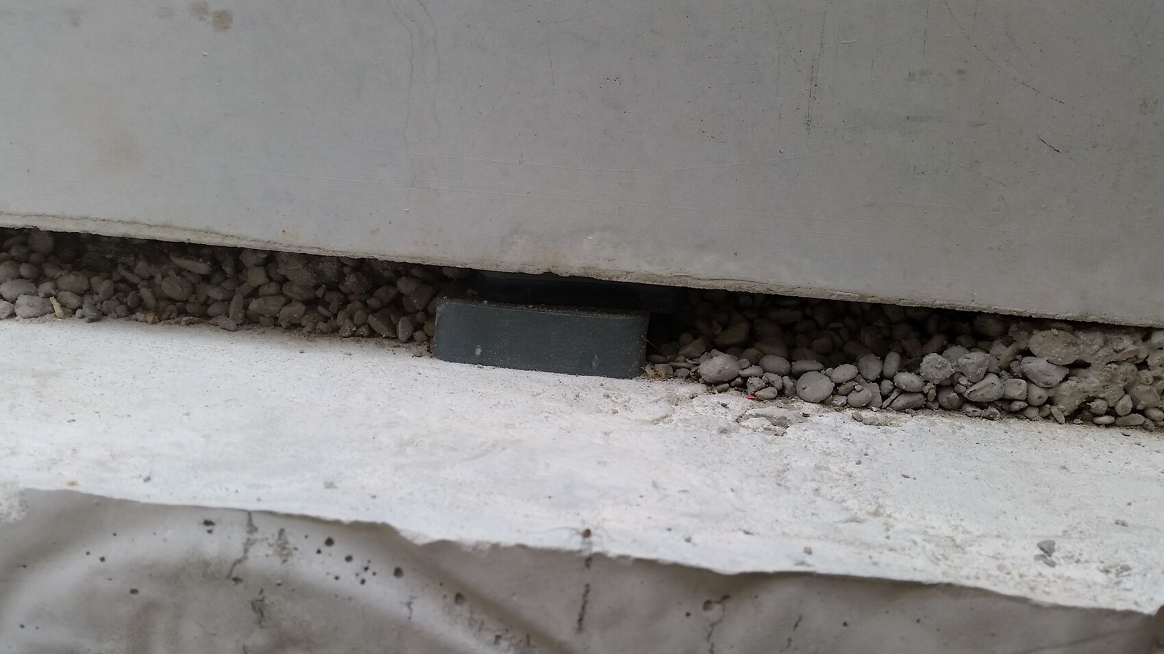

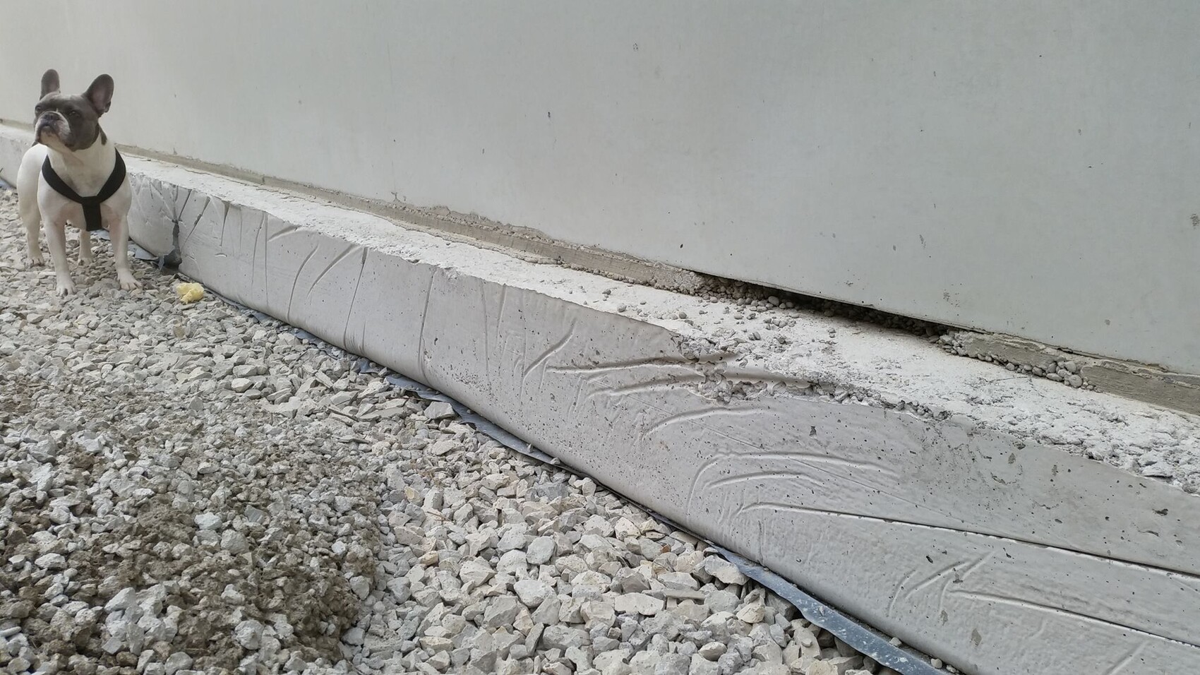

We are building with solid construction, and since last week the basement walls are up. The basement exterior walls are made of prefabricated double walls, and the joints were fully sealed with waterproof concrete during the pouring process. And here comes my question/uncertainty. The gap between the basement wall and the floor slab is not completely sealed everywhere (see pictures). Because we have very high groundwater, the construction company has additionally sealed this area with bitumen and waterproof membrane on their own initiative. We also have a joint flashing, which is said to make it watertight now.

At the beginning of April, construction of our semi-detached house finally started 😉
So far, so good.

Do we already have our first construction defect here?

alter002915 May 2016 22:06Instead of expecting a qualified answer here in the forum and from a distance, I would hire a building inspector to oversee the entire construction. It does cost money, but it is a worthwhile investment. In any case, we have already chosen an inspector for our building project.

Häuslebauer8215 May 2016 22:13I am concerned about the gravel pockets that have formed between the concrete slab and the base of the wall.
alter002915 May 2016 22:24I can’t imagine that this is watertight and don’t understand why it wasn’t later filled with concrete, but I also don’t know if that can be done afterwards at all. However, I’m not an expert and if I were you, I would consult a professional. You will need one if you want to enforce your demands for proper corrective work. Otherwise, the construction company might just tell you whatever they want.
