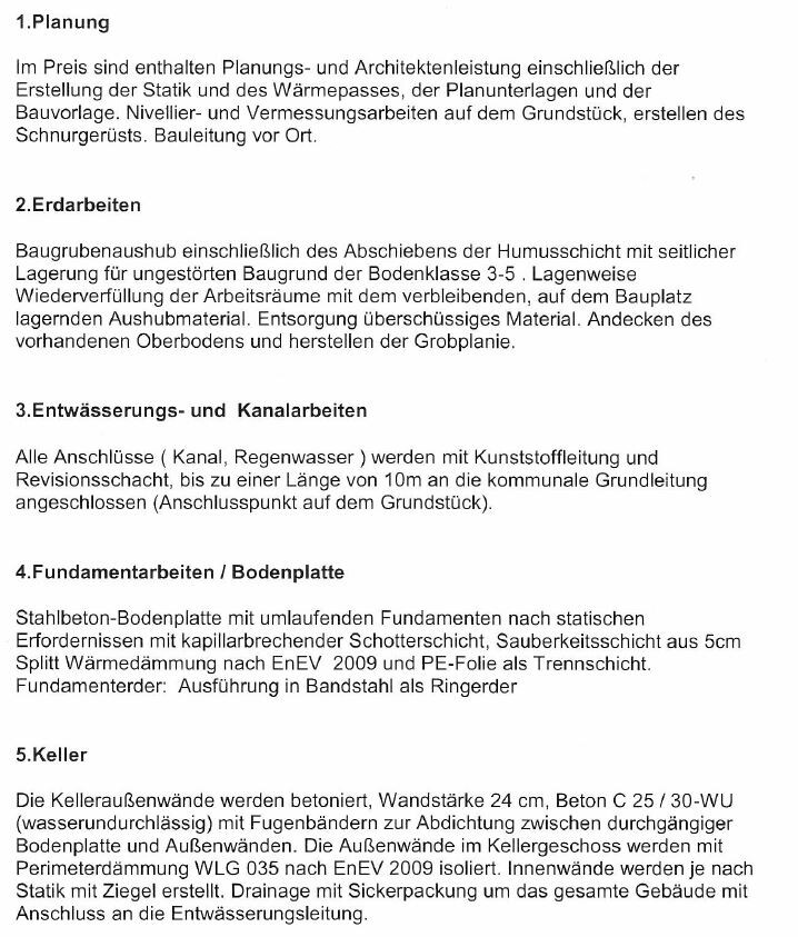

Many thanks in advance for the really quick and informative responses. This evening, I will share the construction specification for the basement at 19,000 EUR. According to the structural engineer who prepared the offer, everything is truly included here, with no hidden costs.
