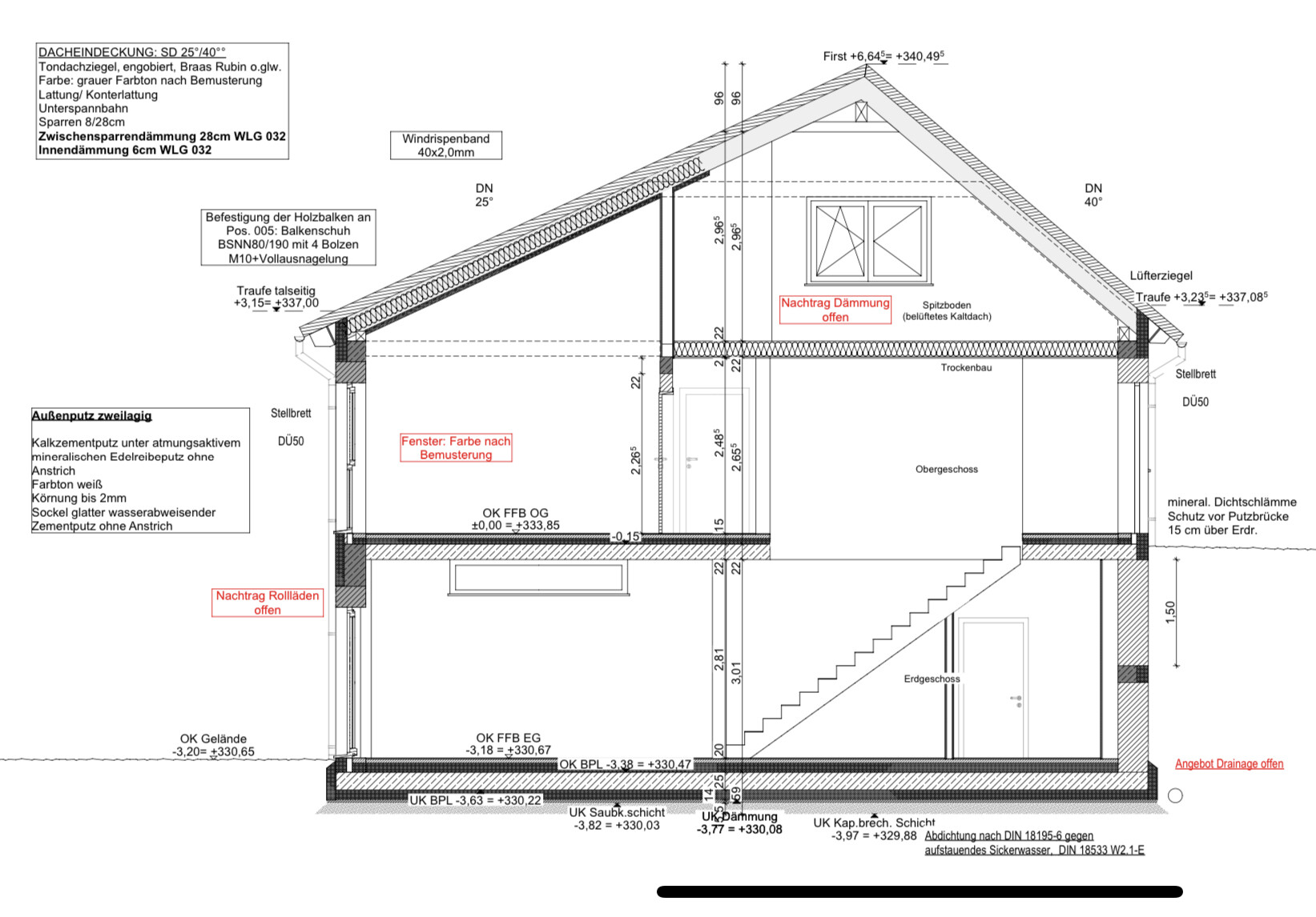

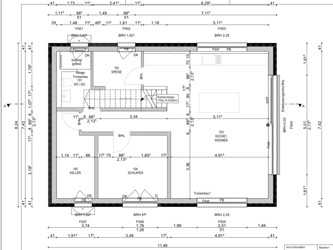

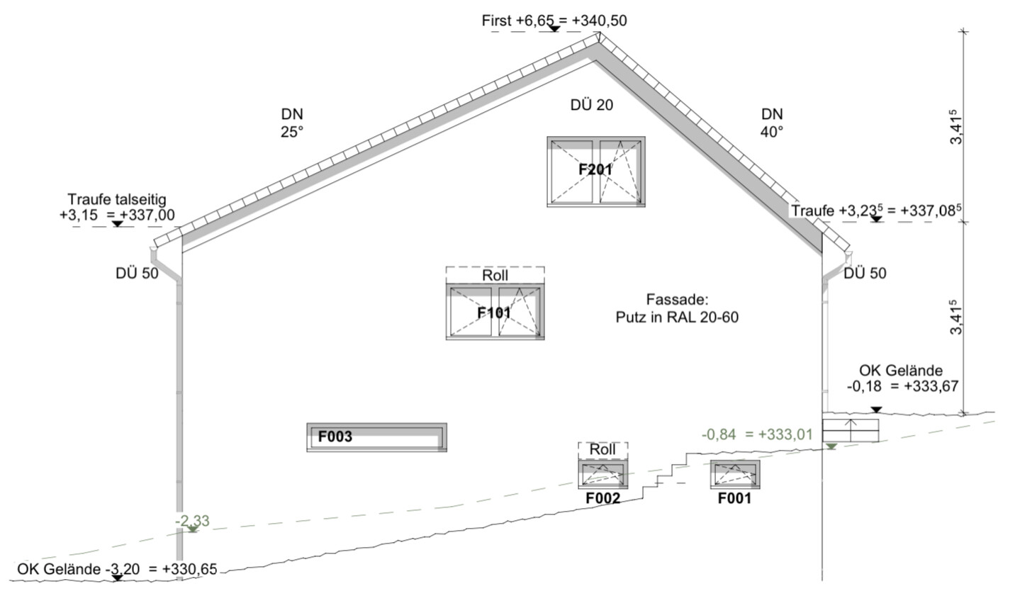

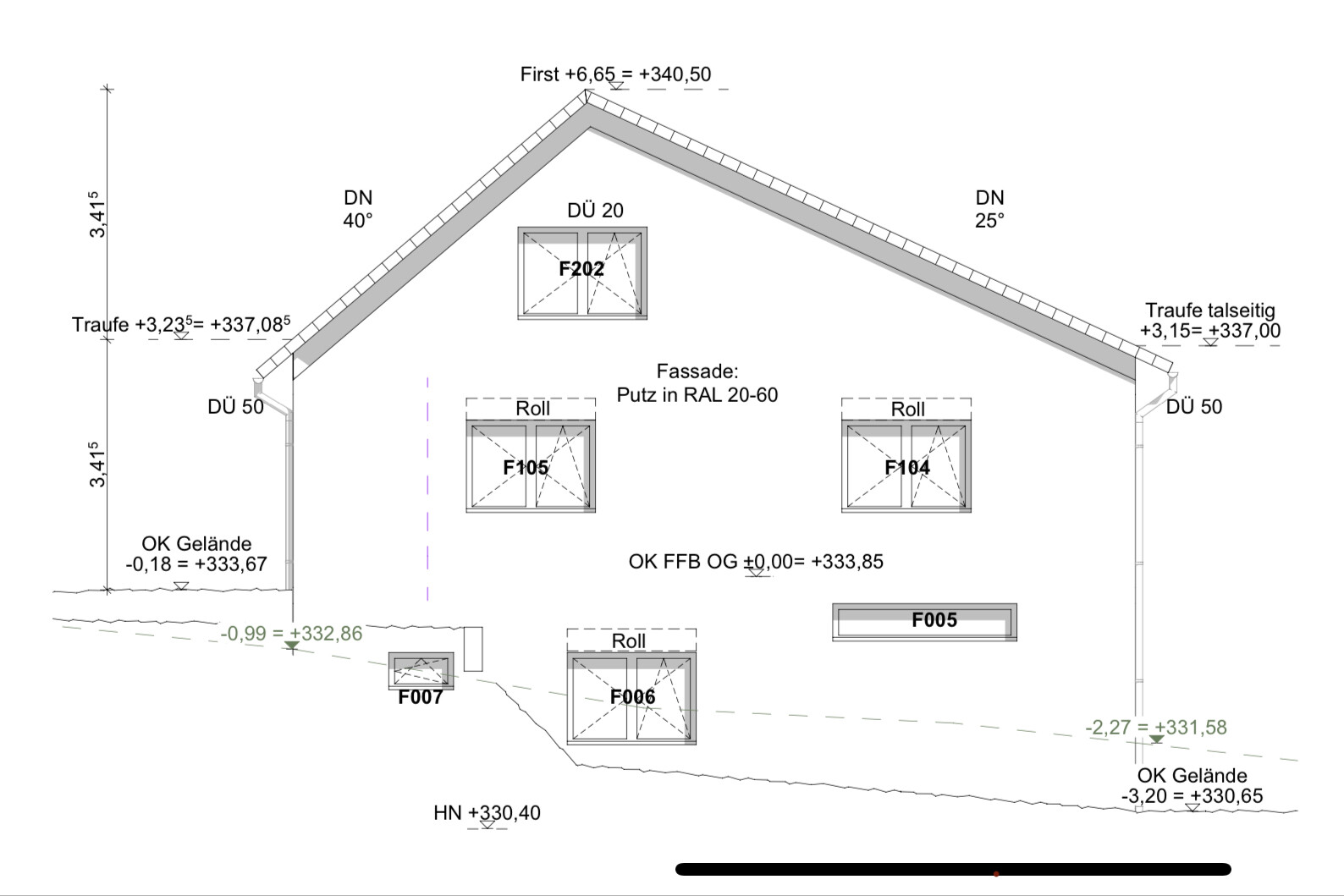

I am attaching the plans I have. I hope you can make some sense of them.

The plan for the basement does not show a half bathroom.
