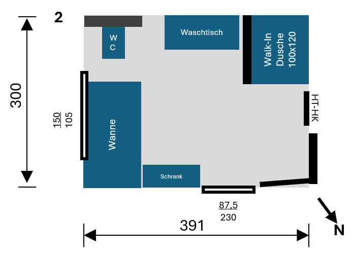

we are currently planning our bathroom and considering several options. The focus is not only on the bathroom layout but also on the placement of the windows. We are uncertain how well the proposed variants will provide sufficient natural light in the bathroom. Therefore, we would appreciate your input!
The bathroom is located on the upper floor (full story) and measures 3.91m x 3.00m (13 ft x 10 ft). The bottom side of the plan faces the street (a small side street in a new development area, with a distance of about 4 m (13 ft) between the house and the street), and the left side of the plan faces a neighboring plot that is still under development.
The bathroom should include a shower of about 1.00m x 1.20m (3 ft 3 in x 3 ft 11 in), a bathtub (180 x 100cm (71 in x 39 in)), a washbasin with a mirror, a toilet, and a heated towel rail.
Here are the current layout options. I look forward to your ideas and comments!

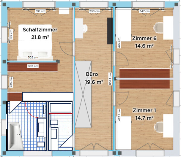

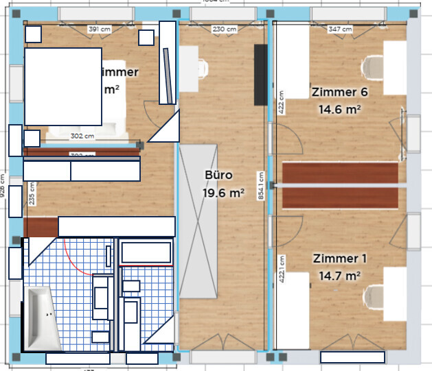

Floor plan of an apartment: bedroom on the left, office in the center, two rooms on the right, bathroom at the bottom.
Here is the adjustment to the walk-in closet. The partition wall in the middle also offers many advantages.

Well, the bedroom is still quite uncomfortable in terms of the layout.
The room is approximately 391 cm (13 feet) wide in its shell form. This means that because of the door, the bed can be a maximum of 300 cm (10 feet) wide. Usually, you want a small bedside table on both sides, which will already be difficult, and then there is the door right next to the headboard of the bed.

Floor plan of an apartment: Office in the center, room 6 and room 1 on the right, bathroom/kitchen on the left.
Here is the bedroom and the walk-in closet, optimized. The window in the bedroom on the left has a sill height of 50 cm (20 inches).
One of the wardrobes in the walk-in closet can also be moved into the bedroom, which looks more homely.
