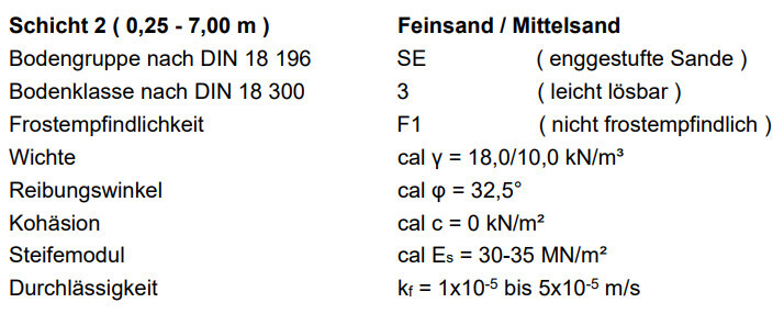

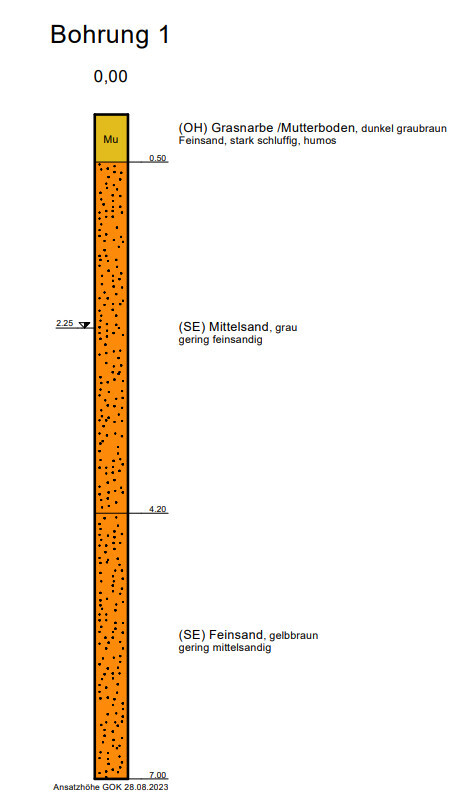

But back to you. Please provide me with the following values:
- permeability coefficient (kf value) from the soil report
- drilling depths
- depth of impermeable layer (if any)
- distance from excavation pit to neighboring plots
- distance from excavation pit to neighboring buildings
How large is the plot? Would you be able to live with raising the house including the basement by 2-3 steps?

Regarding the values you requested:
The drilling depths were two times 7 meters (22.9 feet) each with similar conditions. And a dynamic probing test at 4 meters (13.1 feet).
The distance to the neighboring plot is 2 or 3 meters (6.6 or 9.8 feet), respectively. To the buildings, it is 5.5 or 6 meters (18 or 19.7 feet), respectively.
The plot is over 1000 square meters (approximately 10,760 square feet), but as mentioned, narrow. We are already fully using the construction width of about 9 meters (29.5 feet).
