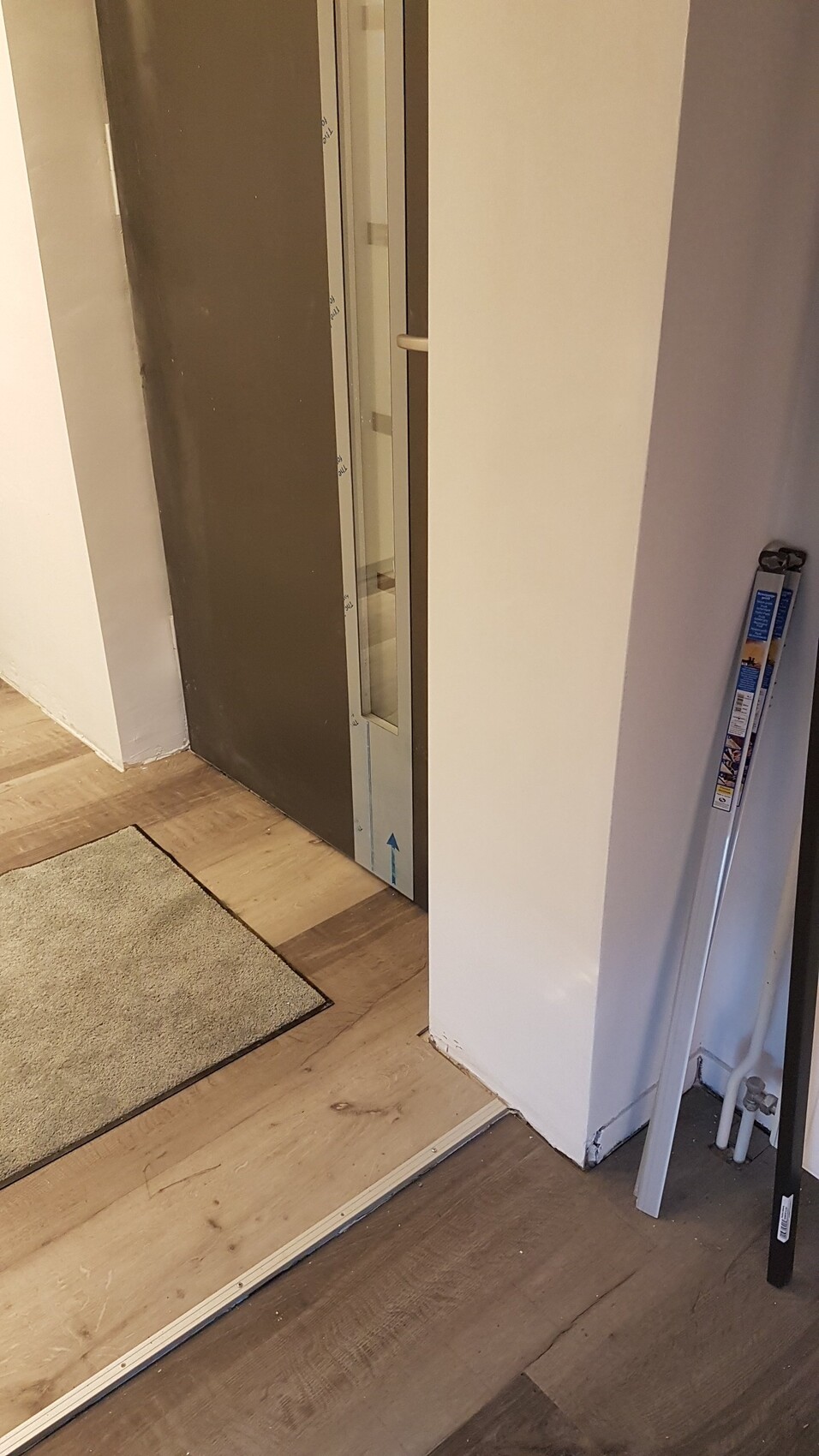

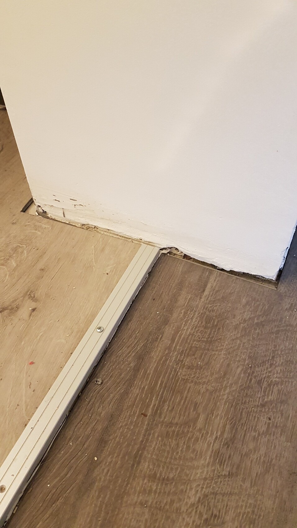

Good day!
I am facing a small challenge. Hopefully, the picture shows the problem clearly. I had to install a small step to level the floor. Now I am wondering how to attach the baseboard in this area (and I’m a bit stuck).
Looking forward to your help,
thank you very much!
Interior: white wall and floor track of a sliding door, damaged baseboard.

6 Nov 2017 20:17
That’s a door, right?
Dlehniem
6 Nov 2017 20:40
Hello!
Not a door directly. The main entrance door is nearby.

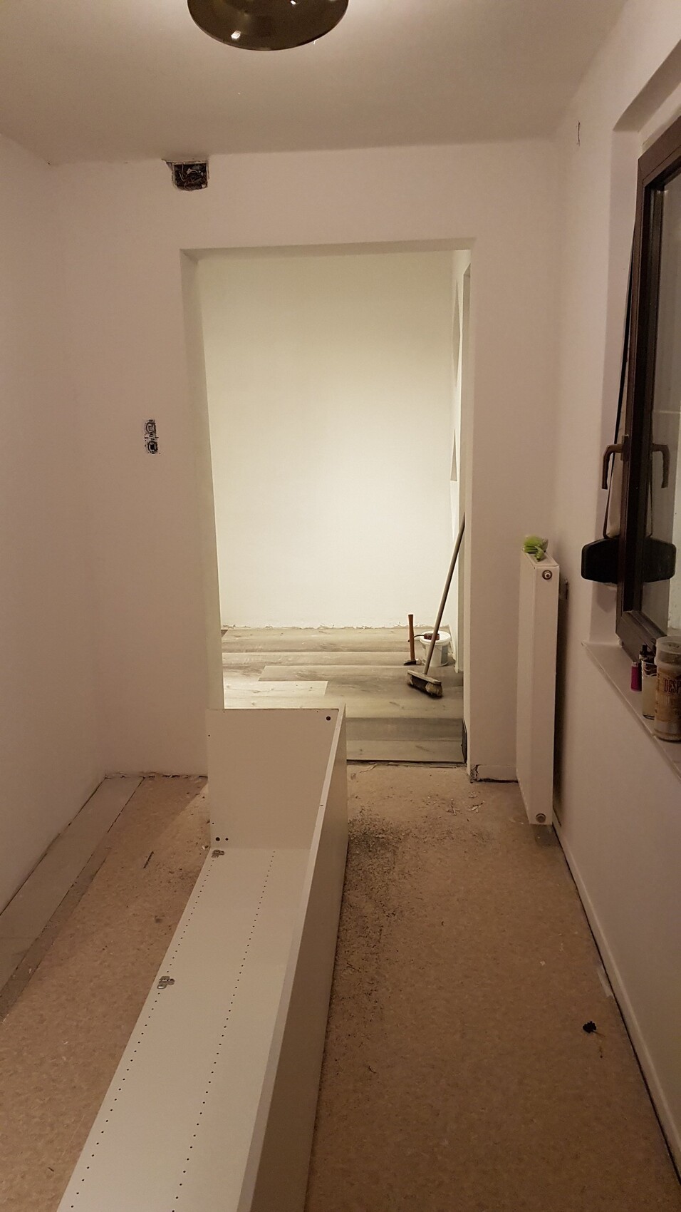

Dlehniem
6 Nov 2017 20:43
...and one more from a distance...
It is just a passage from a small anteroom to another.
Bright renovation room with white cabinet units on the floor, construction tools by the window.
6 Nov 2017 21:36
Make the baseboard in the higher room slightly narrower to create a consistent line above the board.
bortel
7 Nov 2017 06:03
simply notch out the bottom so that it runs at the same height at the top
