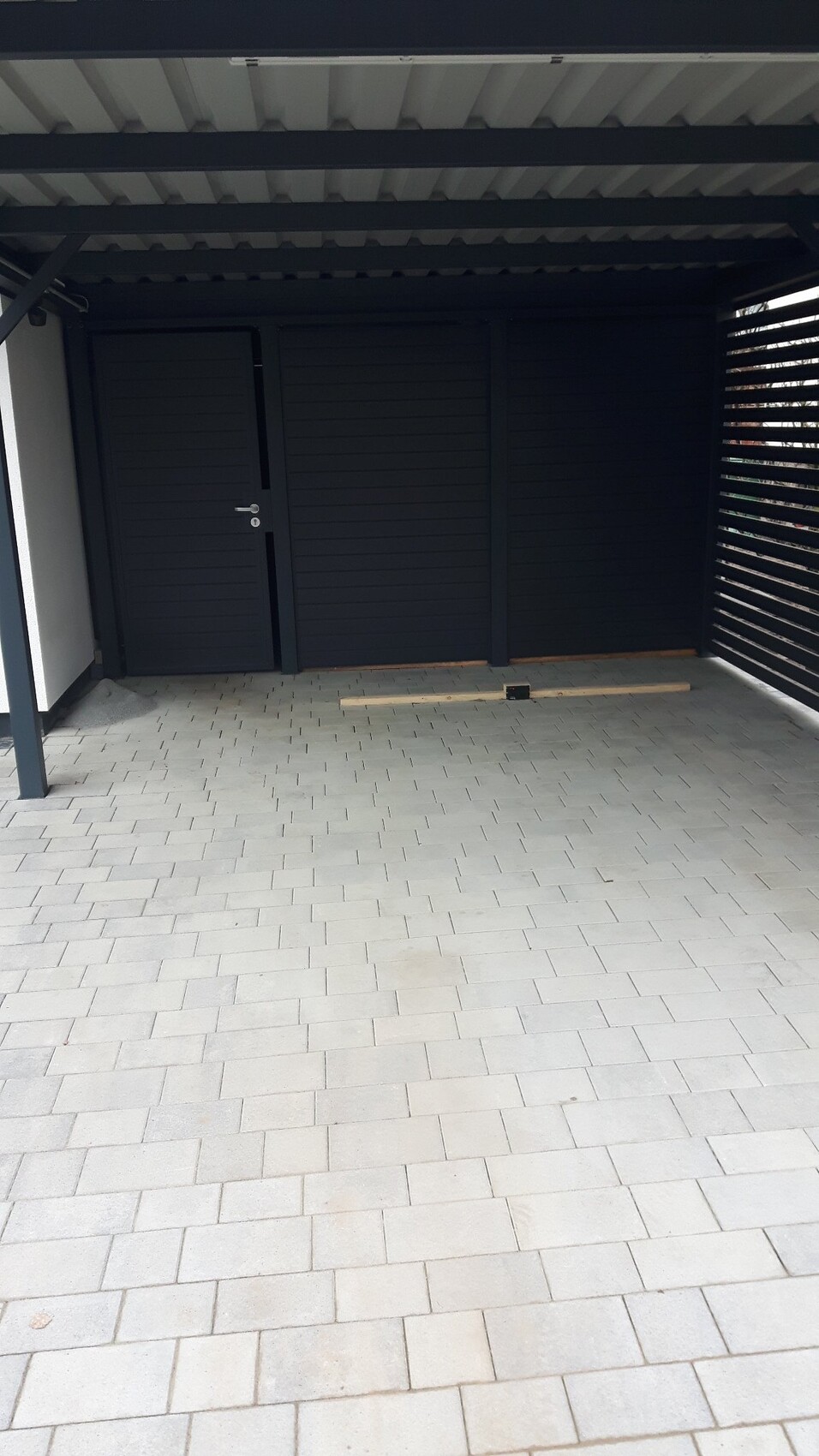

so we had it paved by the landscaping contractor.Is that a warning device installed in/on the ground to help with reversing into the parking space? - would you like to share more details about it?https://www.instagram.com/11antgmxde/
Hello, no, it’s a simple marten repellent. I often have visitors early in the morning. It also serves as a “driveway boundary” for me — no further, or else I’m in the next room. 🙂 It works perfectly for me both forward and backward.
P.S. The door gap is now sealed, by the way. It just wasn’t finished at that time.
