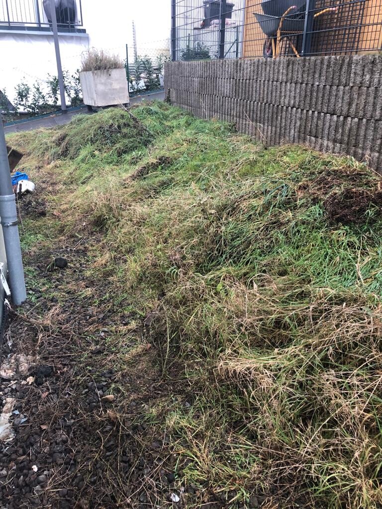

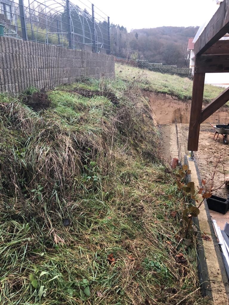

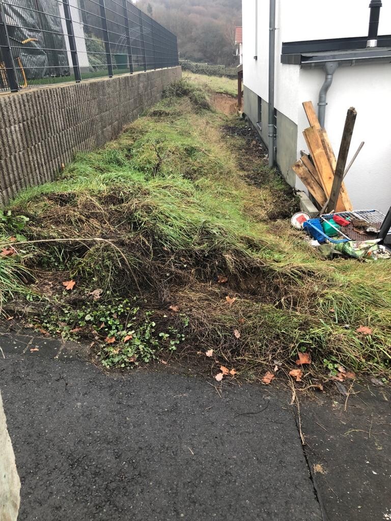

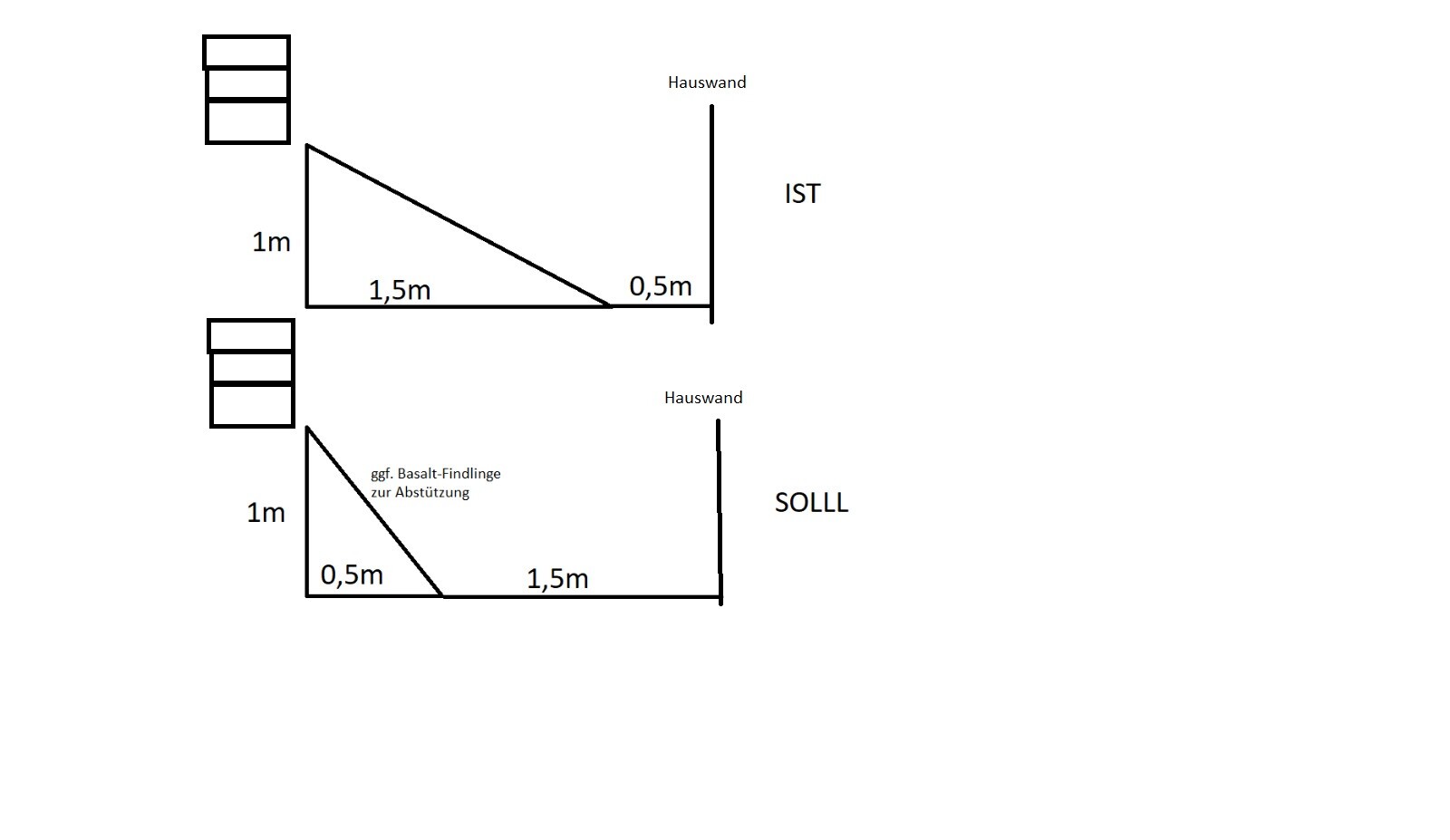

I want to cut back the slope behind the house slightly to create some flat (= usable) area. Attached are three photos of the slope and a rough sketch showing the current situation and how I would like the excavation to be done. As shown in the pictures, the property borders a neighboring plot at the top, and the neighbor’s wall must not settle or shift due to this adjustment. The soil is what I would call "normal" topsoil, nothing special. The neighbor’s wall is made of concrete masonry units, poured with concrete and built on a continuous concrete footing approximately 10cm (4 inches) thick and 50cm (20 inches) wide.
I plan to retain the slope using basalt boulders (since I already have many available).
My question: Should I consider my plan critical, or is there no real need to worry here? It would be disastrous if the neighbor’s wall settled.
Please provide a brief preliminary assessment based on the attached photos and my explanation.

hampshire21 Dec 2020 12:17Up to 60 degrees, you shouldn’t have any problems. I assume you have crushed basalt stones, which are often called boulders. A low retaining wall would be sufficient, then you can slope the rest - or you could build the wall all the way up. What your neighbor did looks quite unpleasant.

Up to 60°? According to my calculation (existing condition sketch), I actually get a slope of 64° (please double-check if I calculated correctly) :-/
Should I compact gravel specifically for the basalt stones, or would it work without that? It would be easier that way.
