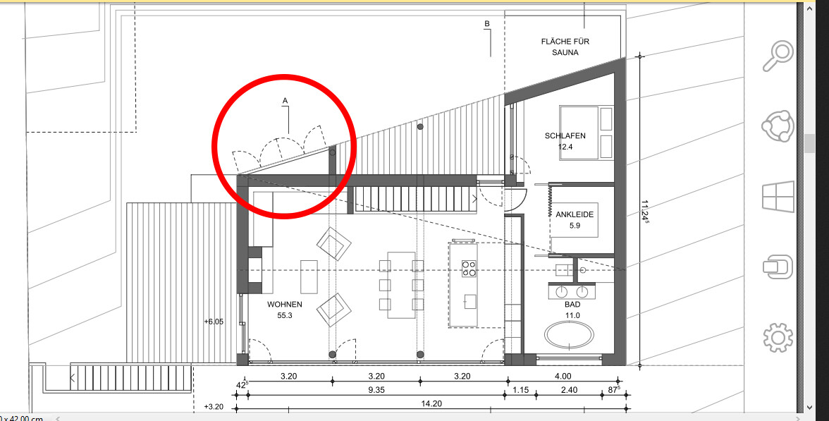

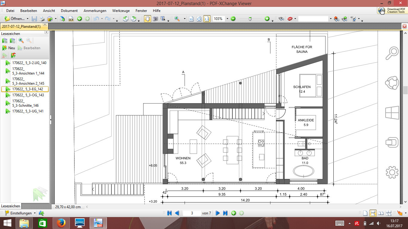

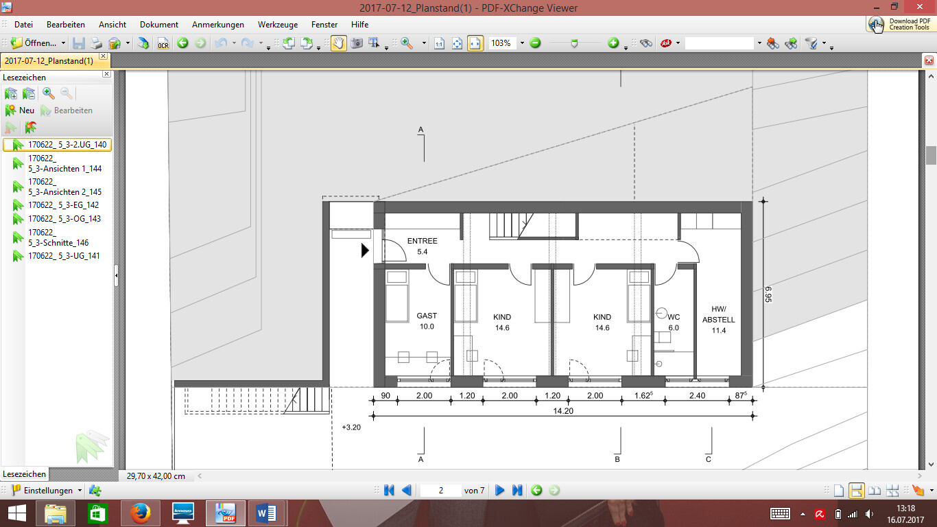

thank you for the responses! Attached are the updated plans with slight changes (basement: bathroom/laundry room) and ground floor (bathroom). The roof will be either concrete (which we dislike due to cost) or a simple rafter roof – both options have been discussed with the structural engineer. Possibly with a bitumen roofing membrane on top or classic concrete roof tiles.
We still have a few open points, maybe some of you have ideas:
- Use of space under the concrete staircase (suggestion: built-in closet as storage)
- Wall between the cloakroom and stairs removed to create a more open design (shoes will be taken off at the door, with a bench planned there)
- Doors on the ground floor: two sliding doors and one regular door to the bedroom/bathroom area. Maybe a sliding door to the bathroom/bedroom area and two regular doors instead? Do we even need a door between the living area and bedroom?
- Door to the laundry room in the basement moved further into the corridor, so you access the bathroom through the laundry room: this could allow better use of the corridor area, and the front part of the laundry room could become a dressing area for the children before entering the bathroom. What do you think about this?
- Exposed concrete wall in the stair/living room area (north/east) from the basement up to the ground floor (possibly concrete throughout)
Best regards and many thanks for any feedback!

Quick question: Do you watch TV? Where will it be placed?Rarely. We are considering either projecting an image with a projector onto the wall next to the fireplace or mounting a TV on the wall between the sofa and the stairs. TV is not the main focus in our living room.
Karlstraße schrieb:
We still have some open points, maybe someone has ideas:
- Use of space under the concrete staircase (suggestion: built-in closet as storage)Sure, why not? Karlstraße schrieb:
- Remove wall between the cloakroom and the stairs, make it more open (shoes are taken off by the door, a bench is planned there)I would keep the wall. That way, the items are at least confined to one area. I imagine small children don’t always hang their clothes perfectly in the cloakroom. At least you don’t have to see the mess constantly from a distance. Karlstraße schrieb:
- Doors on the ground floor: two sliding doors and one regular door to the bedroom/bath area. Rather a sliding door to the bath/bed area and two regular doors? Do we even need a door between the living and sleeping areas?I prefer regular doors and wouldn’t leave any out. Karlstraße schrieb:
- Door to the utility room in the basement moved further into the hallway, so you go through the utility room to reach the bathroom. Then the hallway area could be used better and the front of the utility room could be a dressing area for the children before entering the bathroom. What do you think?I wonder where your guests would go to the toilet? Would they use the bathroom upstairs? That’s unusual but not impossible. Otherwise, they’d have to go down. That seems a bit odd but still acceptable. However, if they also have to pass through the children’s dressing area, you probably wouldn’t invite anyone but close friends inside. Karlstraße schrieb:
- Exposed concrete wall in the stair/living room area (north/east) from basement to ground floor (possibly also concrete finish)If you like it, of course. I don’t. The rest of the criticism remains the same as for the first draft. I don’t understand where these doors would lead.
