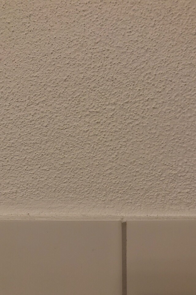

stefanc8415 Jan 2018 00:38I wouldn’t use wallpaper in the bathroom anyway. With Q2 and just paint, I think you could see the difference between the skimmed and non-skimmed areas.
I would therefore go for something with texture, like a textured paint or a rough plaster finish. But I’m not a painter, so if in doubt, you should trust their advice more.
