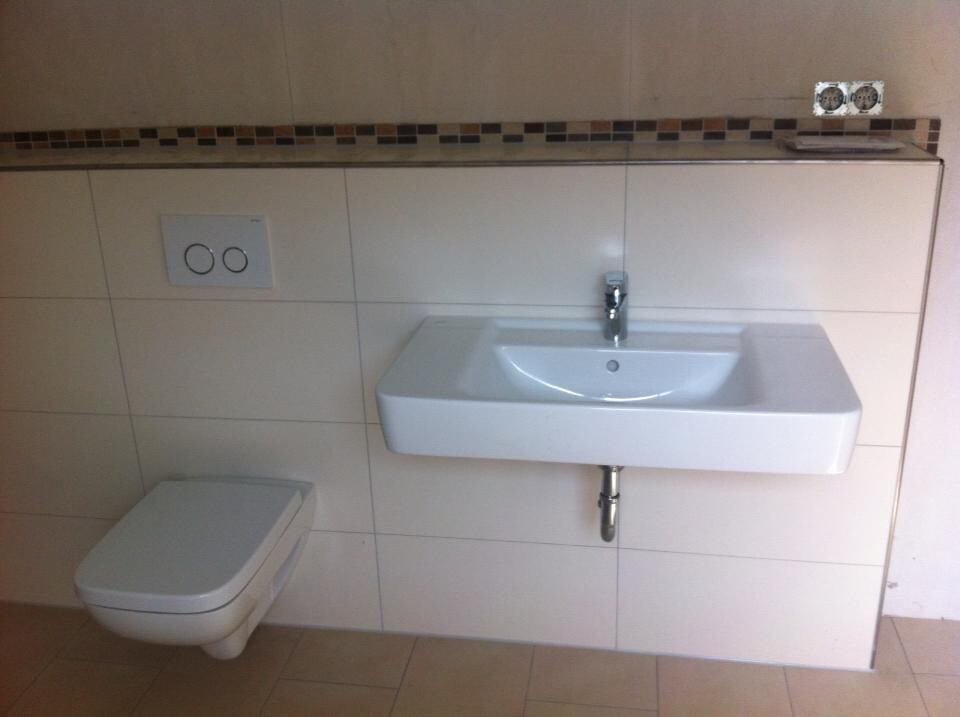

We recently built a bathroom similar to the one in the attached picture. Hmm, but isn’t it almost impossible to get between the sink and the bathtub there?

By the way, in my opinion, you can’t do without the “console” you described, since the plumbing is installed as a wall-mounted system. That means you’ll find these shelf areas in front of the bathtub as well as the sink and toilet. Well, with drywall, we can also hide everything inside the wall. Then the console wouldn’t be necessary, right?

kaho674 schrieb:Unfortunately, there’s no perfect solution. However, about 90 cm (35 inches) should remain. Since the hand washbasin will be a standard model anyway, there should actually be even more space.
Hmm, there barely seems to be enough space between the sink and the bathtub, right?

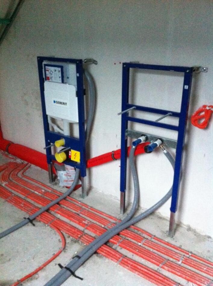

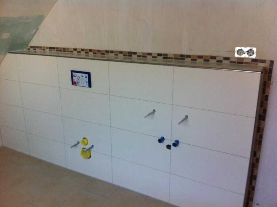

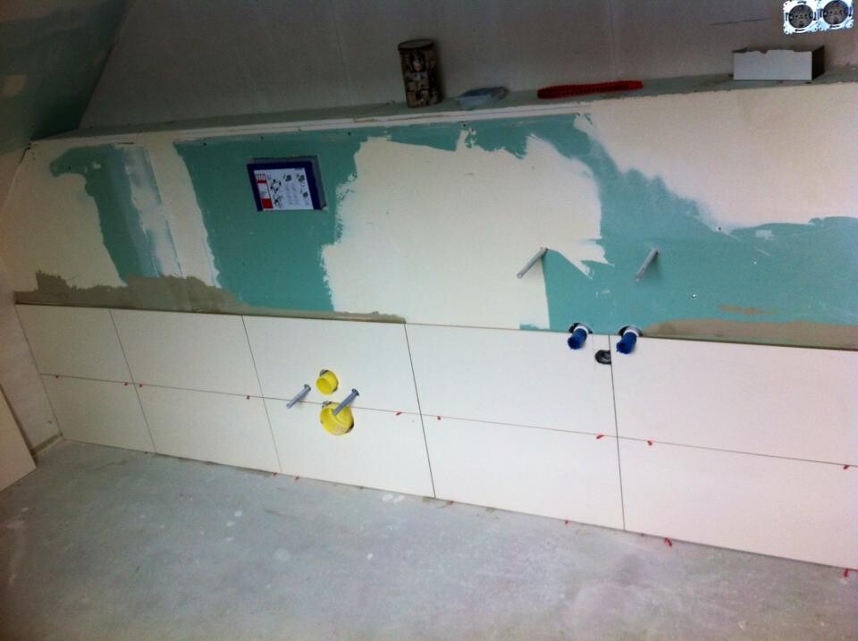

kaho674 schrieb:No; all connections – except possibly the shower – are located in front of the wall.
Well, since it’s a drywall partition, we can integrate everything into the wall. Then the bracket wouldn’t be necessary, right?
Best regards, Bauexperte
Bauexperte schrieb:
No; all connections – except maybe the shower – are located in front of the wall. I don’t quite understand this. Of course, the connections themselves come out of the wall, otherwise there’s nothing to connect to, obviously. But the pipes can go inside the wall, right?
Bauexperte14 Aug 2013 12:13Hello,
I’ve attached a few pictures from the last construction site; maybe that will help you understand better.
Regards, Bauexperte
kaho674 schrieb:
I don’t quite understand right now. The connections themselves obviously come out of the wall; otherwise, I can’t connect anything, of course. But the pipes can be inside the wall, right?
