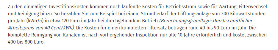

KarstenausNRW18 Dec 2023 11:07Radfahrer schrieb:
My usual party lines about costs come straight from the consumer advice center! Google helps! The consumer advice center NRW only states that a controlled ventilation system is recommended. There is no mention of contamination.
But yes, there is a note about costs (see the text). These are very individual, though. You can calculate electricity costs yourself, replace/cut filters yourself (I pay a small single-digit € amount per year for self-purchased filter mats, which I cut myself, including pollen filters as an allergy sufferer). Cleaning is needed only as required – if the controlled ventilation is running regularly, the need may not arise even after 10 years (based on experience).
So these are maximum costs, which can be reduced by up to 95% for maintenance if you are willing. But that kind of information doesn’t get exchanged at the local pub, only criticism.
