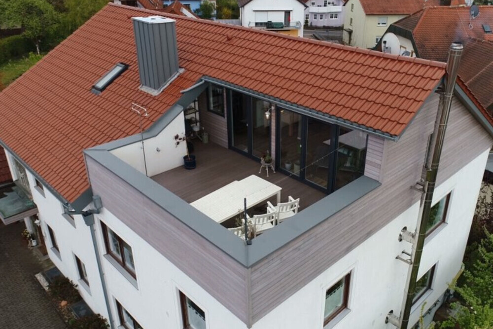

For a full story, the attic must have a clear height of at least 2.3m (7.5 ft) over at least two-thirds of the area of the floor below. How is this affected if a roof terrace is planned? As far as I understand, a roof terrace does not have a clear height... Does it then count as an area above 2.3m (7.5 ft) or below 2.3m (7.5 ft)? In more recent plans I have read that a roof terrace is not taken into account in the calculation... however, the wording "the floor area of the story below" would suggest that the roof terrace should also be included...
The more specific background is that I am not allowed to build another full story, so it would be important for me to know if a full story can be avoided by adding dormers, and at the same time planning a slightly larger roof terrace.

It is also possible that I am misinterpreting everything and understanding it in a way that suits me... My thought is, if, as in your example, the lower floor has 80m² (860 sq ft) and there is a 27m² (290 sq ft) roof terrace, can the remaining part of the floor (that is, the 53m² (570 sq ft)) have a full ceiling height of 2.30m (7.5 ft) or more?
I mean not a detached roof terrace (or whatever it’s called...), but something like that, just with the rest of the floor at full floor height...

This is actually how it should be! In the end, it’s simply about the fact that at most two-thirds of the attic floor have the minimum clear ceiling height. The roof terrace does not count towards this, so you could design the remaining one-third as a roof terrace or have a clear ceiling height of less than 2.30m (7 ft 7 in) in that area.
The only restriction for the attic floor not to be considered a full story is that you have a clear ceiling height of 2.30m (7 ft 7 in) on no more than two-thirds of the floor area.

Focus on clear ceiling height and leave out the roof terrace for now. I’ve actually already read up well on clear ceiling height, etc. I don’t really understand why I should leave out the roof terrace, since I definitely want it and only want to know if it is included in the area with a ceiling height lower than 2.3m (7.5 ft).
