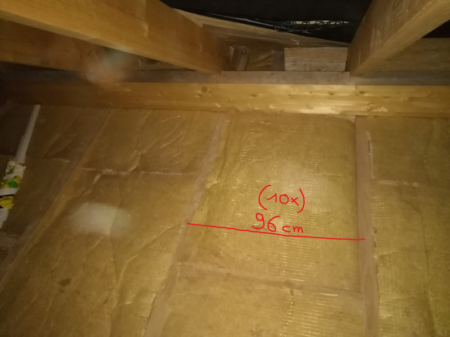

The spacing on the floor between two rafters is 96 cm (38 inches) from center to center, and the rafter itself is 8 cm (3 inches) wide.
I have 10 “gaps” to fill (each spaced 96 cm / 38 inches apart).

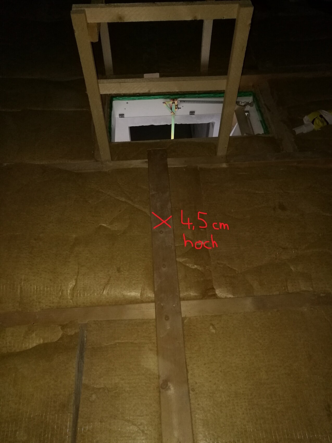

In the middle of the attic, lengthwise, there is a wooden beam crossing, which is 4.5 cm (1.75 inches) higher than the other smaller rafters.

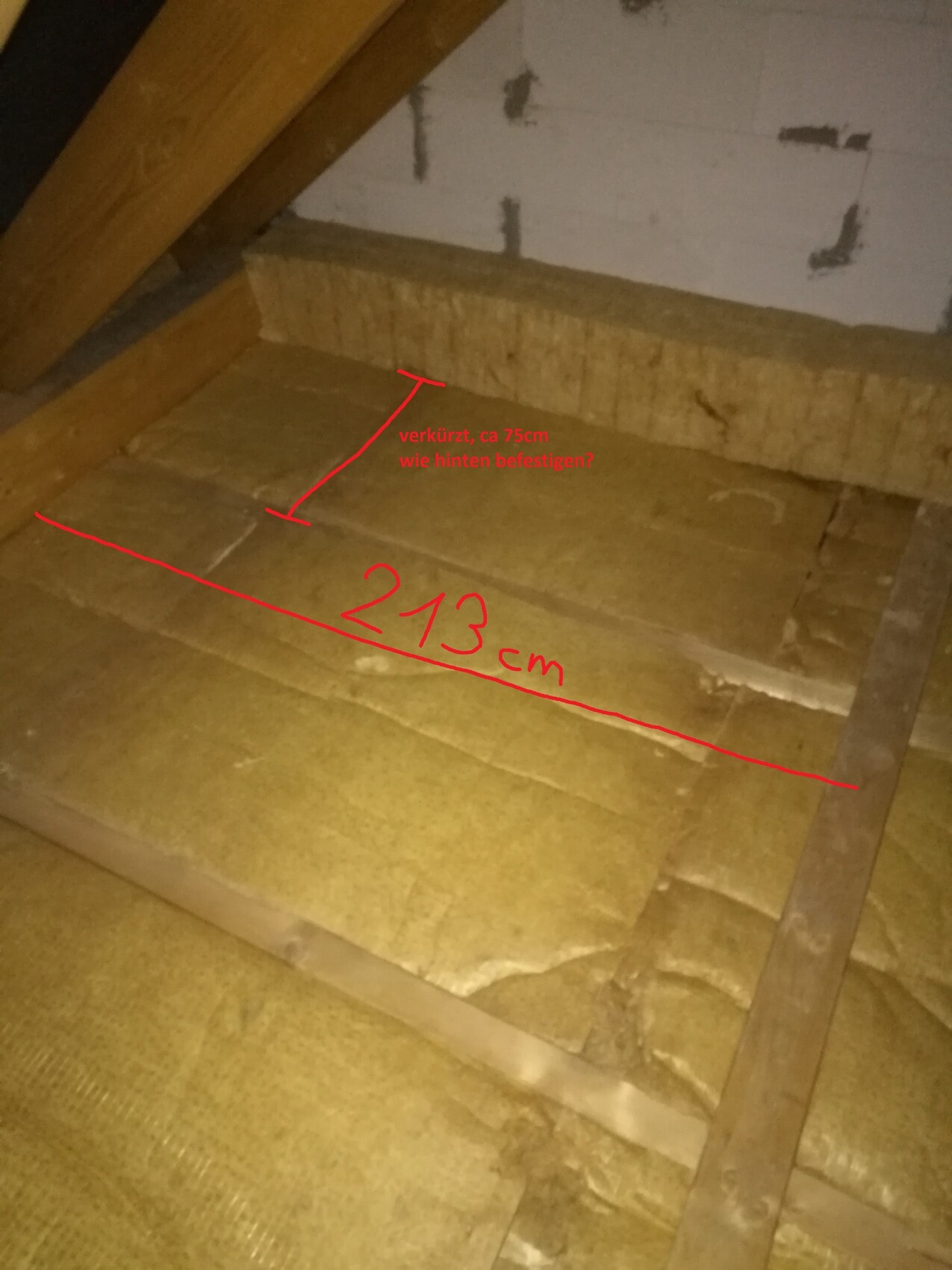

The distance between this middle beam and the inner exterior wall (or rather the rafter in front of it) is 213 cm (84 inches).
