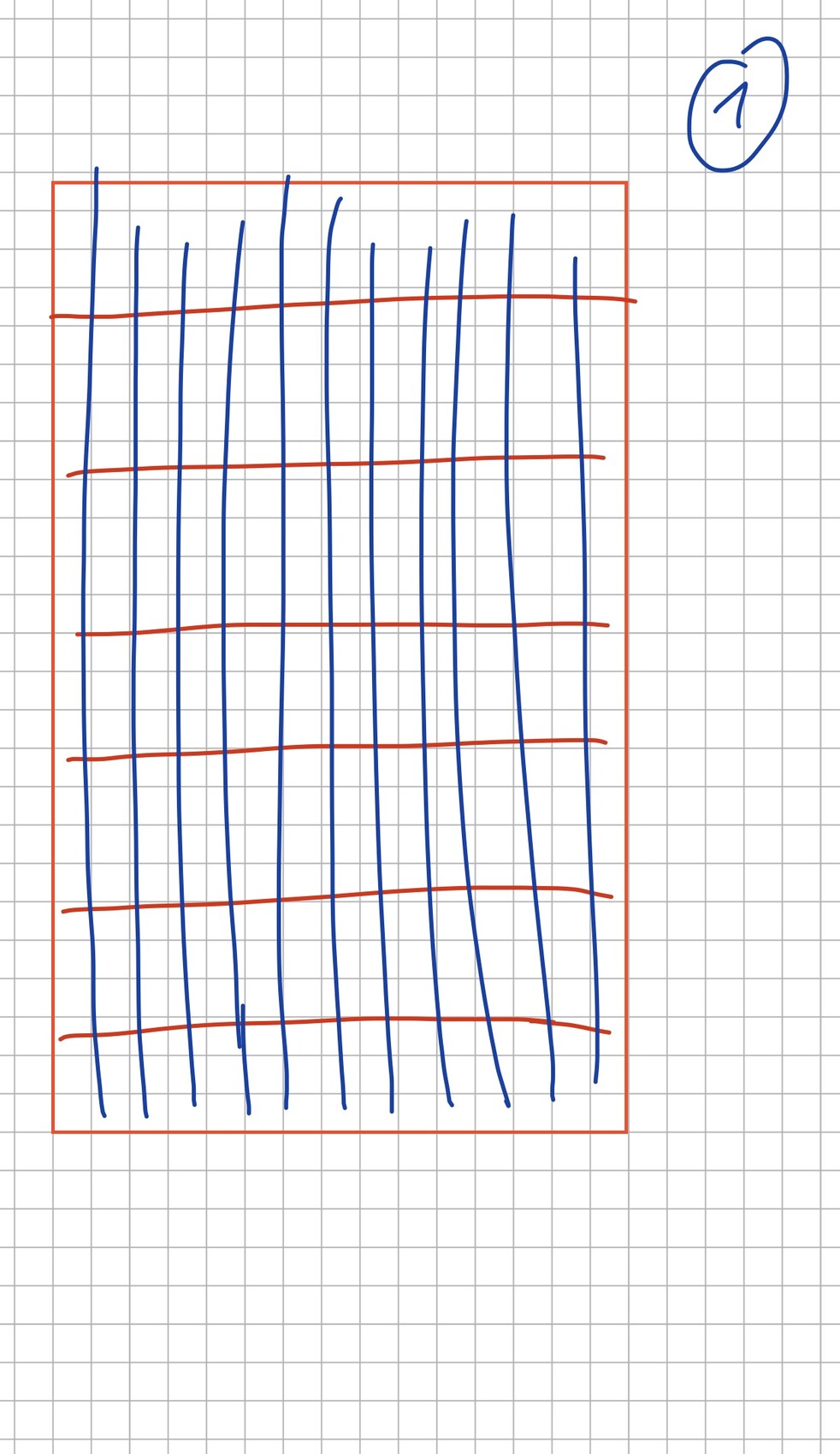

In the “normal” approach, the boards would be installed as shown in image 1 (red = rafters/joists, blue = tongue-and-groove boards).
Given the width of 3m (10 feet), it would be much simpler to install as shown in image 2:
Use tongue-and-groove boards cut to a length of about three meters (10 feet) and lay them that way, then add counter battens (green).
Which method do you think is more stable? I assume method 1, right?
How thick/strong do you think the battens should be in method 2?
