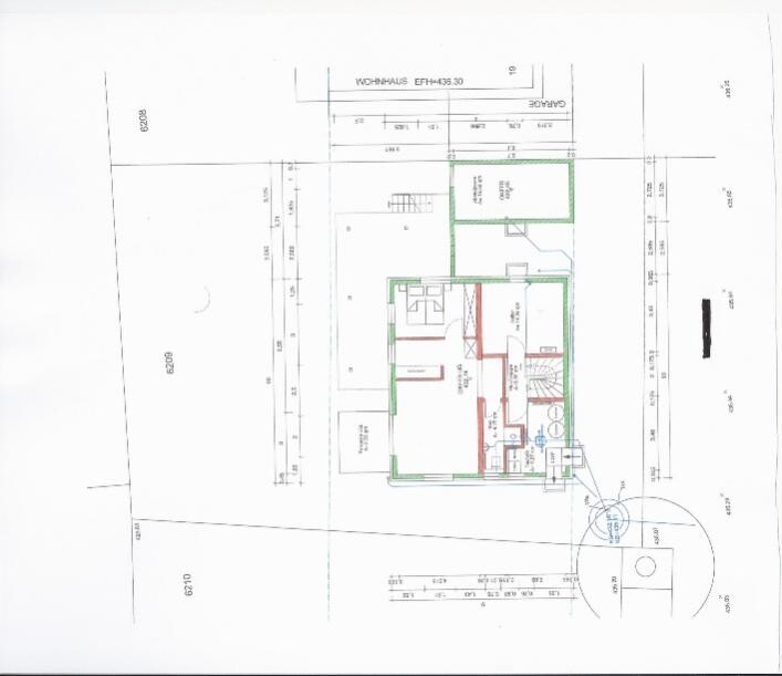

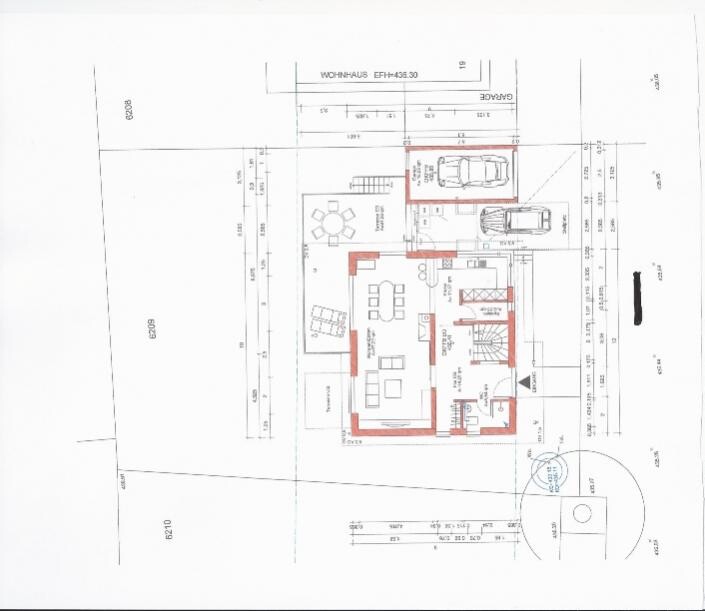

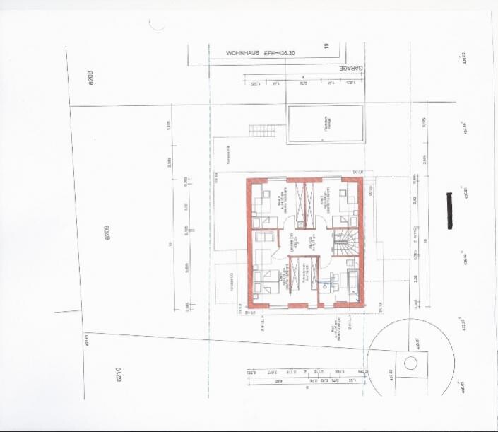

29 Aug 2012 10:08
The 4.6 m (15 ft) measurement is actually at the highest point. Originally, we also considered adding intermediate floors in the children’s rooms... but now I’m not sure if that would create a wall in our bedroom that is too high to look at.
Have you seen our plans yet? I’m attaching them directly to this post.

Boergi
29 Aug 2012 11:54
I saw the designs in another post of yours. The bedroom (dressing room) wall is not centered, so the ceiling height in the bedroom is already considerably lower than 4.60 meters (15 feet). How wide is your house, what is the roof pitch, and what is the knee wall height? Unfortunately, this is not clearly visible in the drawings.
O
olali2
29 Aug 2012 13:00
Our house measures 10m by 9m (33 feet by 30 feet), the roof pitch is 40 degrees, and the knee wall is 1.35m (4 feet 5 inches) high.
