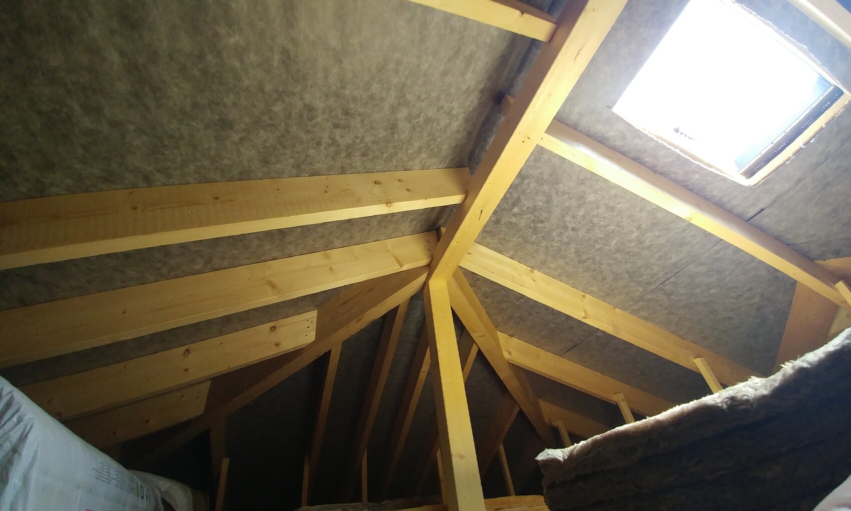

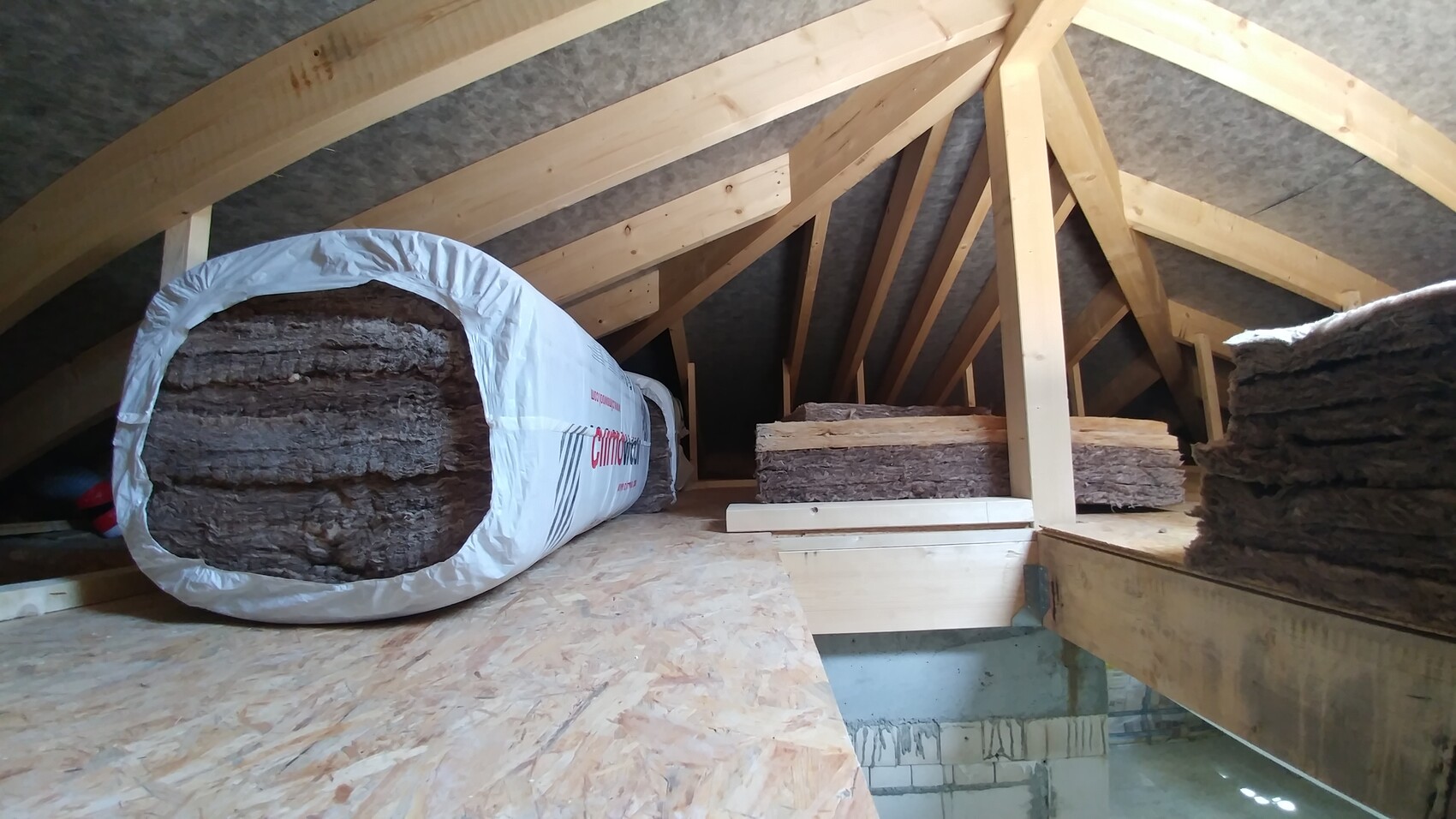

Our attic has a height of about 1.45 m (4.75 feet) at a 22° angle. The base dimensions should be approximately 9 x 11 m (30 x 36 feet), and there is more than enough space. Thanks for the photos! But you store everything by carrying it up the stairs/ladder, right?
The window provides good natural light!

The window provides good light! As the name suggests, you can only move forward up there by crawling. However, during my first inspection, I didn’t find this particularly bothersome. Boxes are carried up via the pull-down staircase and then pushed into place at the top. It only becomes uncomfortable when dealing with especially bulky and/or heavy items. A standard moving box (unless packed full of books) doesn’t pose much of a problem. Also, it works best to stock the attic with two people, one handing items up from below.
