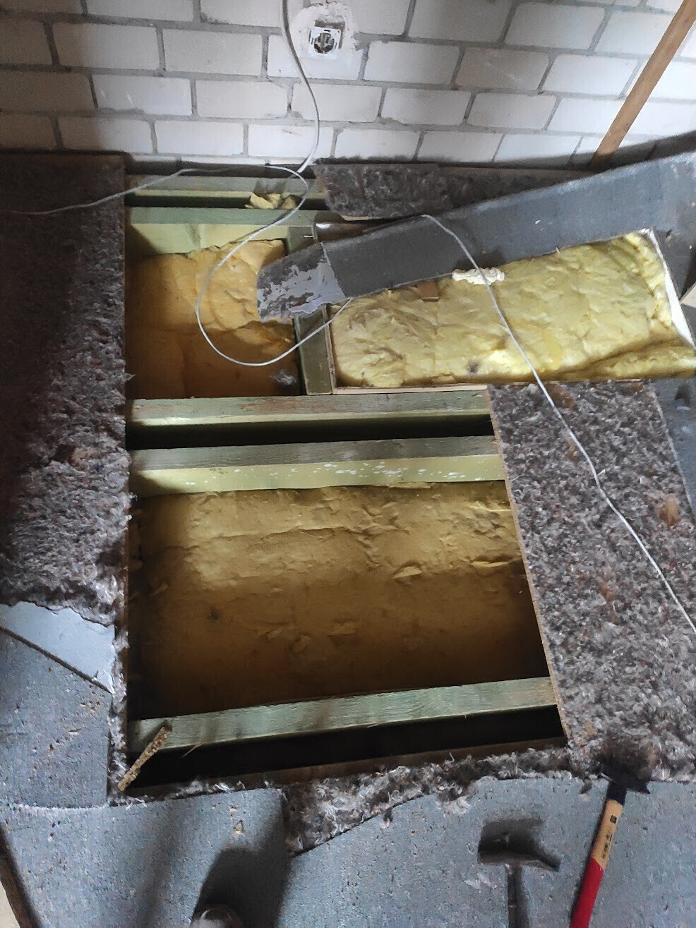

Currently, the floor is constructed as follows:
- Chipboard 18mm (0.7 inches)
- Painter’s fleece 1 mm (0.04 inches)
- Carpet 4 mm (0.16 inches)
- Chipboard 16 mm (0.63 inches)
- Carpet 7 mm (0.28 inches)
Built in 1990, and the first layer of chipboard is as old as the building. The floor creaks intensely.
I once placed two gypsum fiber boards by Knauf on top, but the creaking continued. So from my point of view, everything can be removed.
Between the joists there is compressed felt insulation and no void floor for loose fill or similar.
Joist structure. The lines represent the joists.
The stains on the joists are plaster or mortar or something similar.

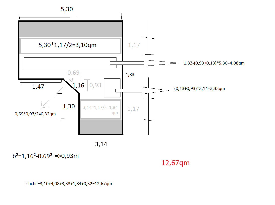

The total floor area is about 16 sqm, rounded up to 17 sqm. The 12.67 sqm is the official living space.
So overall, the area is quite moderate.
