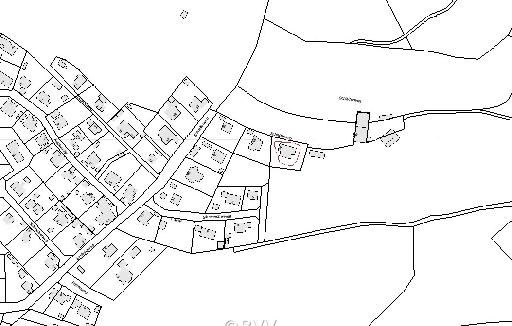

Here is the situation: I want to convert the attic in an existing house that already has two apartments (grandparents and parents) and build a dormer. Since a third apartment will be created, the building then falls under building class 3. The resulting fire safety requirements are not a problem. We have also been told that the dormer would be approved.
There is only one other issue. The district office says that we are located in an outer development area. In outer development areas, no more than two dwelling units are allowed in one house. This has been shown to me in the law and apparently is correct. My question is, when exactly is an area considered outer development? Our house is situated right on the edge of a settlement with about 80 houses. The difficult part is that our property boundary toward the neighbor in the direction of the settlement is also the municipal and cadastral boundary. The land use plan covers the entire settlement exactly up to our neighbor. Unfortunately, our property lies outside the land use plan.
Are we really located in an outer development area? We always thought we belonged to the settlement. Our access road also runs through the settlement. I have attached a picture. The house marked in red is ours.
I would appreciate it if someone could help.

Whether you are allowed to build three residential units is usually regulated by the zoning plan (here, unfortunately, about 90% of zoning plans exclude that) or by the building authority with certain conditions or interpretations.
If building is allowed, certain requirements must be met, as currently applies here in North Rhine-Westphalia (post above).
Spitzbua schrieb:
My only question is: when exactly is an area considered outside the built-up area?Accuracy is the surveyor’s domain, and this is precisely why the city planner decides the boundary between inside and outside the built-up area, as there are no exact criteria. There are cases where you get different answers from different officials (and even from the same official after some time has passed). From an urban planning perspective, you need to gather indications that connect your house to the rest of the settlement. Municipal boundary, cadastral boundary, and locations outside the land use plan are three strong counterarguments. If the district office states it is outside the built-up area, you will probably have no chance.
