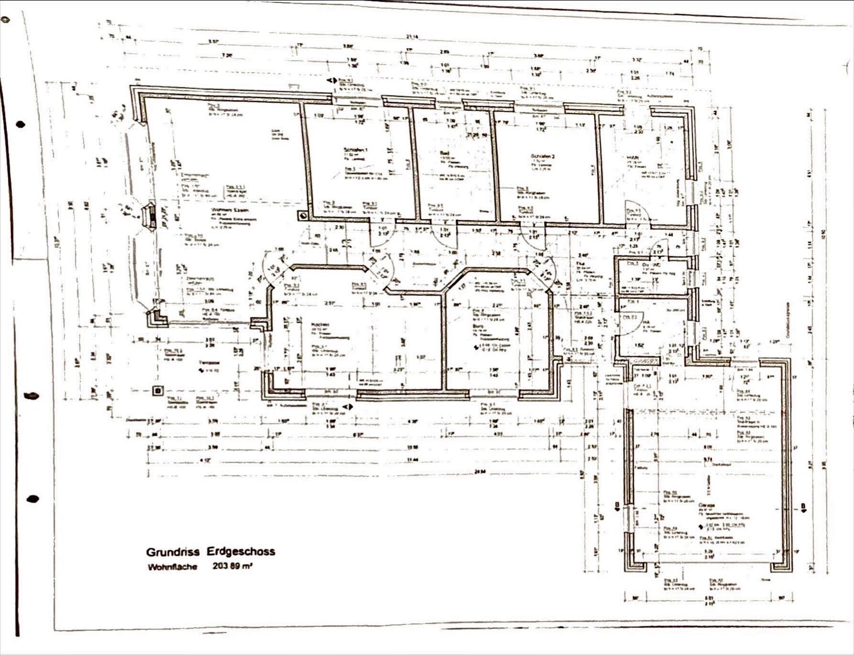

Hausgestalten24 Oct 2023 18:21hanghaus2023 schrieb:
Are there any plans for the bungalow?
Thank you very much for your contribution. Attached is the floor plan.
We urgently need a study or home office in the house that can be closed off with a door. A utility room is also essential (laundry/storage), and a bedroom for each child (2) is a must. Since my family lives farther away and visits frequently, a small guest room would also be great (especially if you’re already planning to invest a significant amount). At the moment, guests have to sleep in the living room, which greatly limits everyone’s privacy. I can’t really imagine how the floor plan would need to be adjusted. It might be possible to section off part of the double garage as a utility room. That way, there would still be 2 children’s bedrooms... maybe a guest room just isn’t feasible if you say 50,000 is too tight for the extension. 70,000 would be our absolute maximum budget for this.

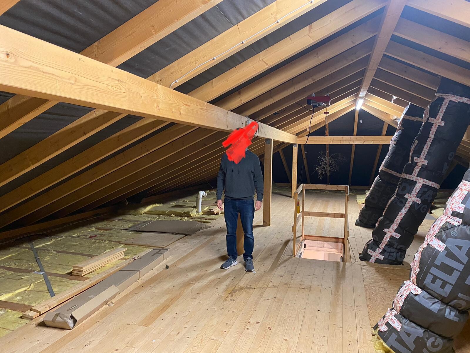

Hausgestalten24 Oct 2023 18:25hanghaus2023 schrieb:
In my opinion, not feasible with 50 km. What does the roof structure look like? Rafters or trusses?This is how it looks in the attic:
