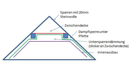

I would like to install an intermediate ceiling in the area of the purlins.
Question:
Since the vapor barrier film cannot be laid behind the purlins but must enclose the purlins, can the film also run only under the intermediate ceiling instead of all the way up to the ridge? This should not be a problem regarding vapor control. I would then install the cross battens below the film, apply another layer of insulation (thicker at the intermediate ceiling), have the wiring installed, and then cover it with drywall or similar.
Question:
