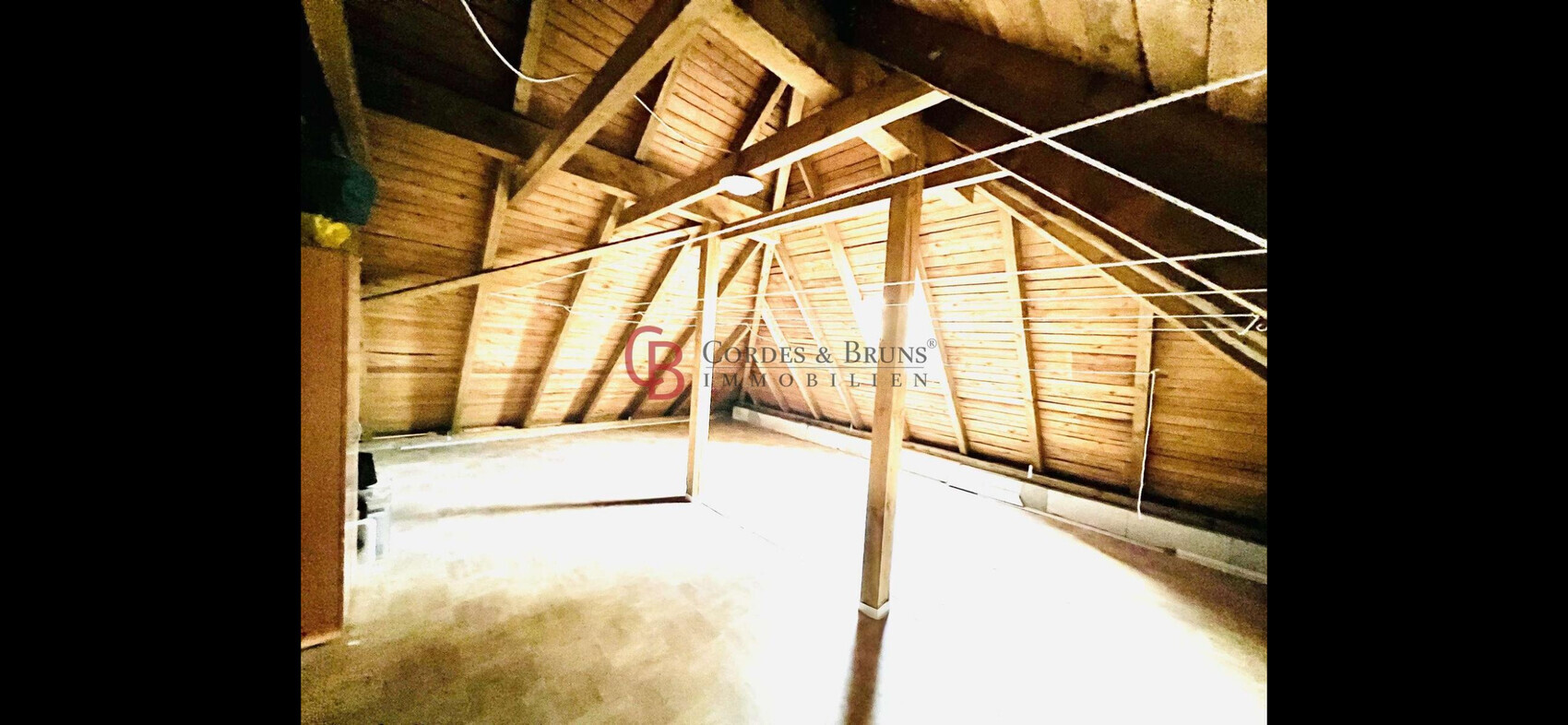

I have purchased an older house (built in 1984) and am currently renovating it. The attic is being converted into living space and will be insulated.
The current roof structure is:
- Roof tiles
- Roofing felt
- Profiled wood boards
- Rafters (16cm) (6.3 inches)
My plan is to use Isover ZKF 1-032 insulation, 16 cm (6.3 inches) thick, fitted between the rafters, then install a vapor retarder, followed by counter battens to fix the drywall panels.
Is this approach feasible?
It is a bungalow with a hipped roof (45°) and roughly 180 m² (1,938 sq ft) of roof area.
No work will be done on the exterior of the roof except for new roof windows.
I am open to any ideas or suggestions.
Thank you

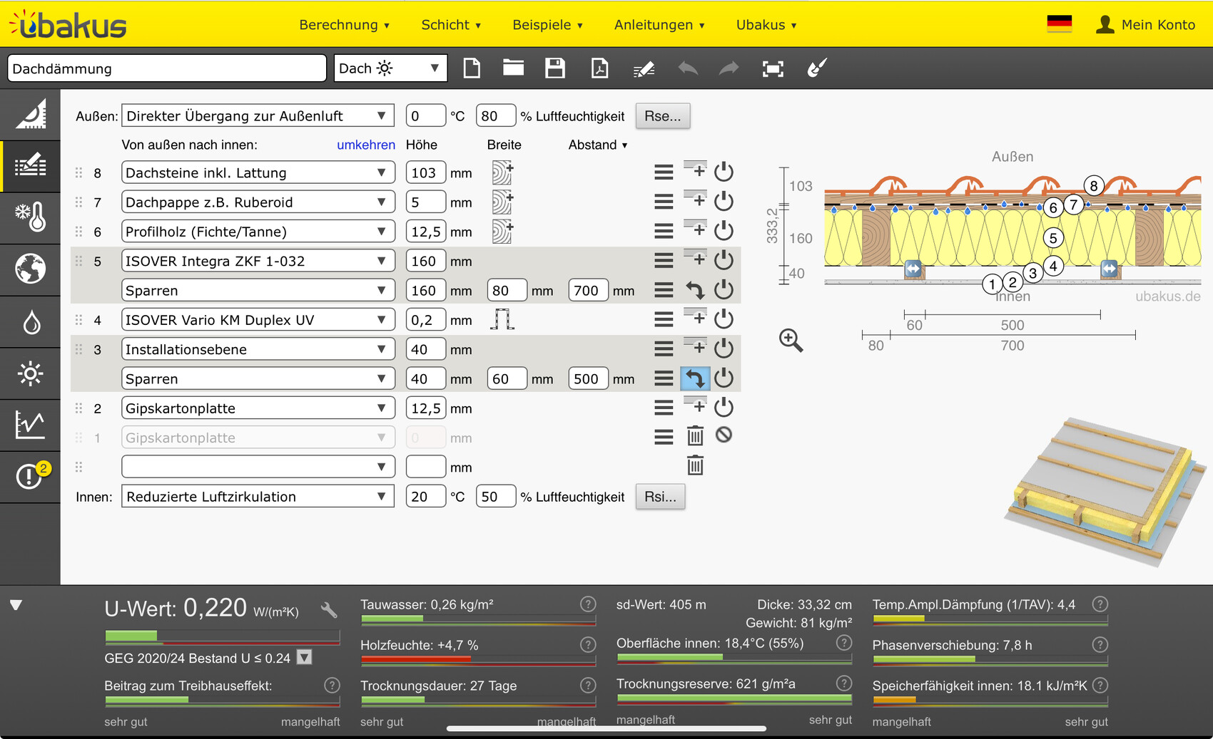

nordanney2 Jan 2025 08:08Celo318 schrieb:
I am open to ideas and suggestions.Calculate everything using ubakus for yourself.nordanney schrieb:
Calculate everything in ubakus.What do the values tell me?
For example, the wood moisture is shown in red, at 4.7%.
Drying time is 27 days.
nordanney2 Jan 2025 10:47Celo318 schrieb:
What do these values tell me?
For example, wood moisture is shown in red, 4.7%.
Drying time 27 days Please upload a picture of the calculation. Red for wood moisture simply means your wood is damp ==> mold warning
nordanney schrieb:

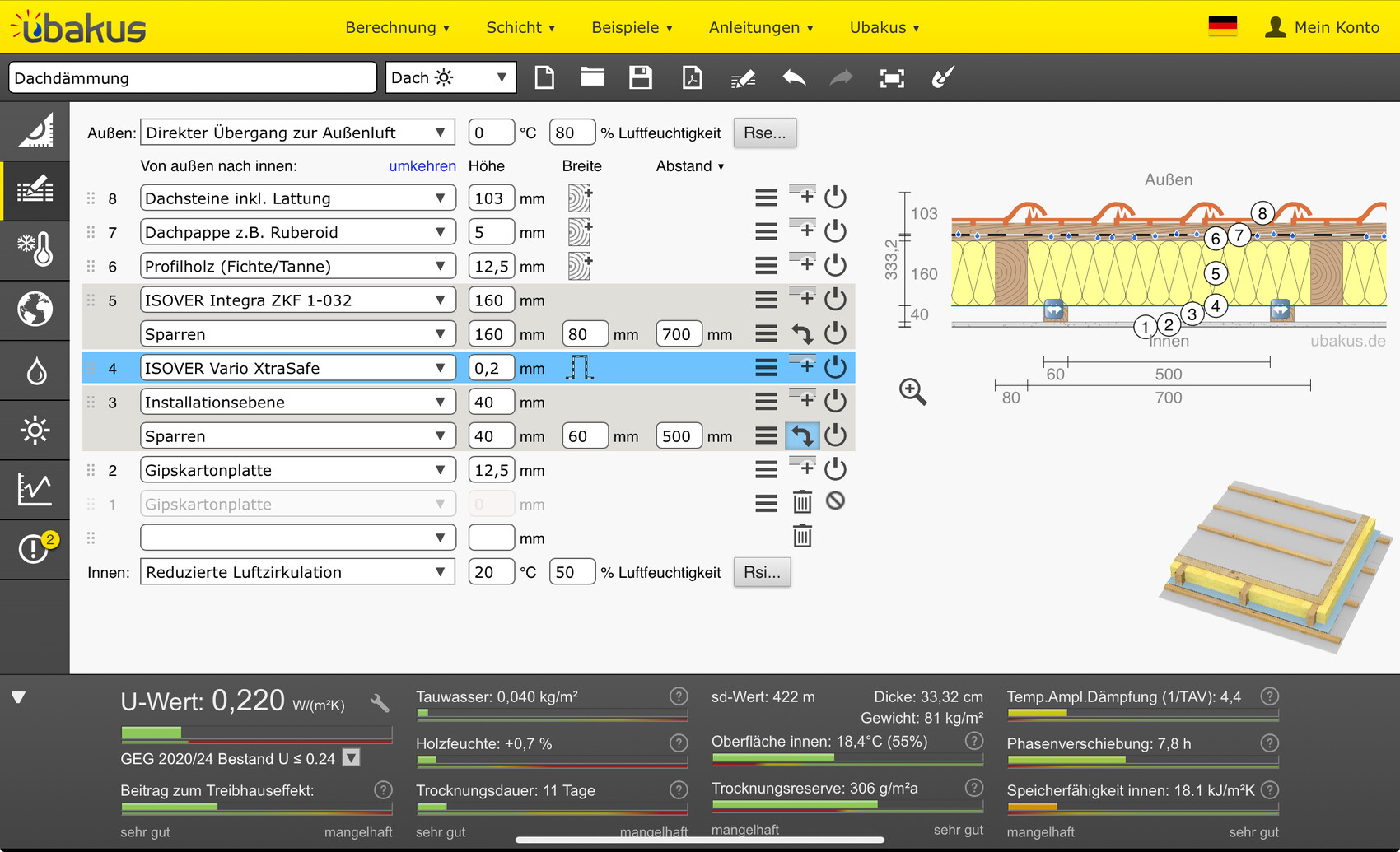

Try posting a picture of the calculation. Red in the wood moisture means simply that your wood is getting damp ==> mold warning I have changed the vapor retarder, which corrected the values in a positive way
nordanney2 Jan 2025 11:56Celo318 schrieb:
