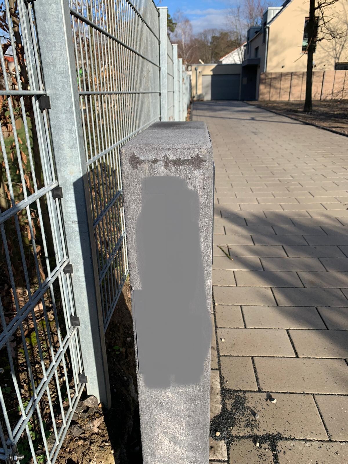

The problem object looks like this:
Walkway with gray concrete post next to metal fence; large gray stain on the post.

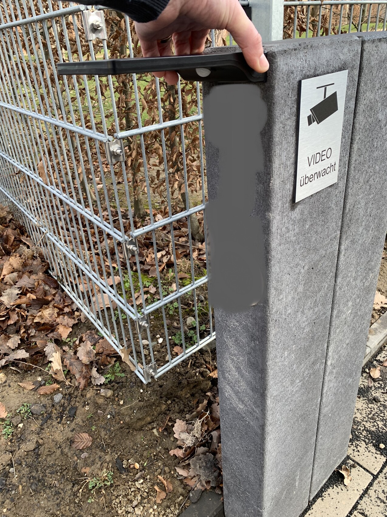

This is how the light should/must be mounted on it.
A hand opens metal gate on concrete post; visible sign saying 'Video monitored'.

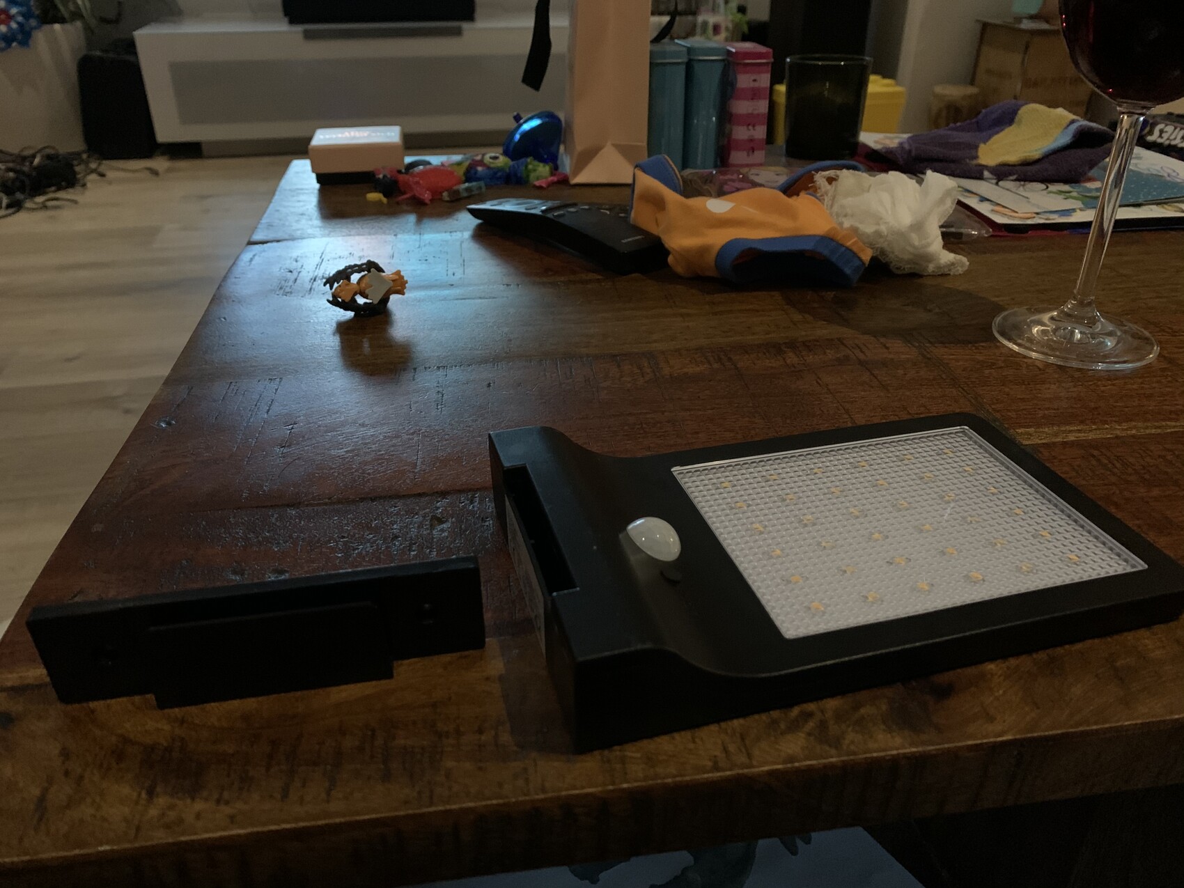

Here are some more pictures of the light itself.
An LED light panel lying on a wooden table; wine glass on the right, small parts scattered on the left.

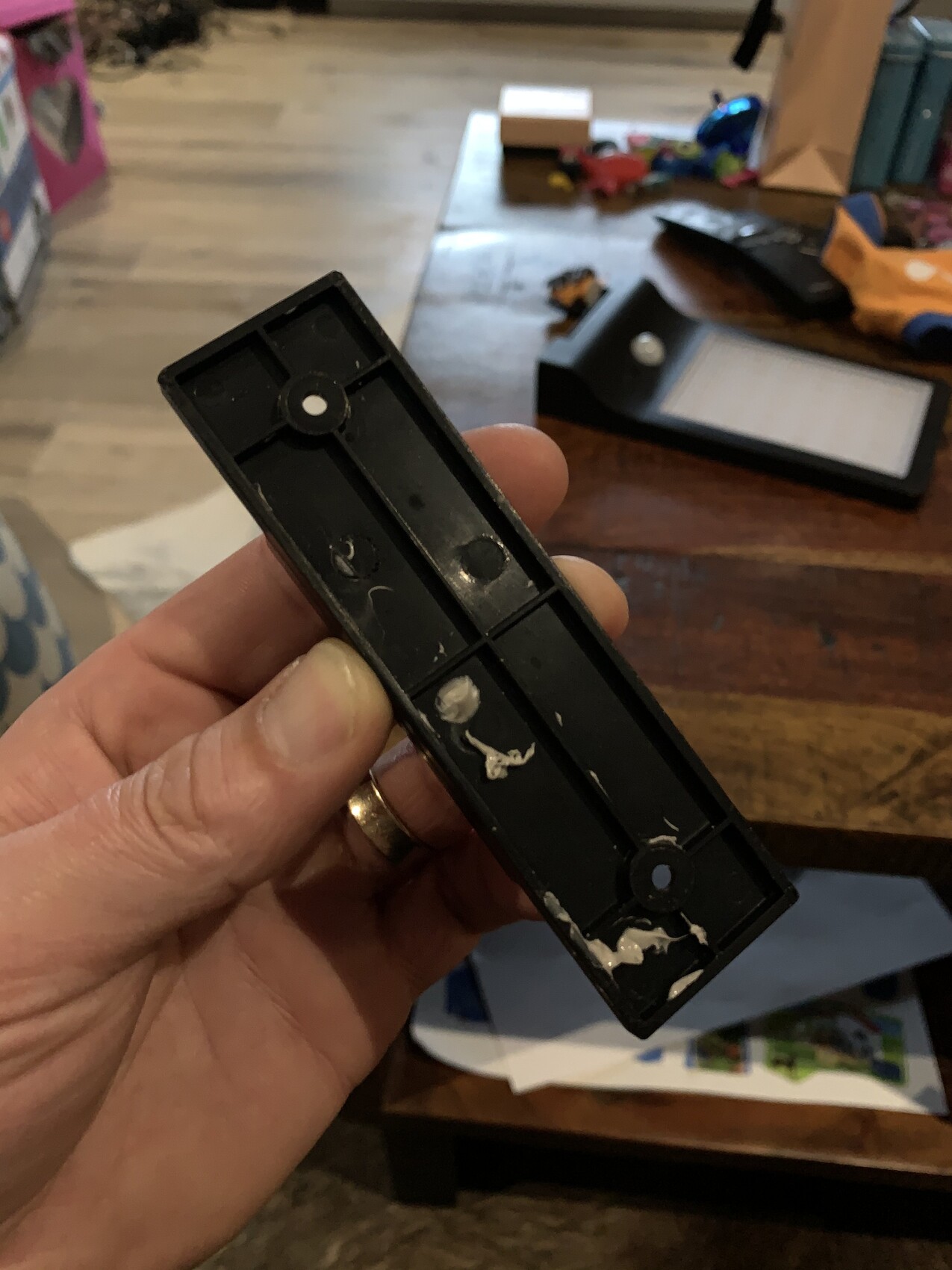

This is the bracket, note the mounting holes.
Close-up: hand holding black plastic piece with two round indentations; table in the background.
I actually want to anchor the light with screws. However, I’m worried that the stone might chip because I only have about 1.3cm (0.5 inches) of clearance to the edge of the corner. I first tried silicone, as seen in the first photo, but it didn’t hold the light at all.
I would now be interested in your assessment or ideas:
The material is similar to paving stones or a curbstone. Should I be concerned that it will chip? If so, how should I proceed? Is there a construction adhesive suitable for this? The mounting bracket also does not offer a broad surface for attachment, only these narrow grooves. I’m unsure whether any adhesive would bond securely there. In addition, I would prefer to be able to remove it later without leaving severe residue. The silicone stains in the first picture are already annoying me.

*Drill without hammer function using a glass drill bit.
*Attach the carrier plate to the lamp with screws and firmly secure it further down.

Do you think a glass drill bit would work there? For house numbers, I needed about 5 minutes per hole with a rotary hammer (not a hammer drill but an actual rotary hammer) at 6mm/4cm (0.24 inch/1.6 inch). The material is really hard.
Nida35a17 Mar 2021 22:45
Then drill 2mm (0.08 inches) deep without hammer action, angle the drill approximately 20 degrees downward, and with hammer action drill diagonally downward. Use a professional drill bit.
AMNE3IA17 Mar 2021 23:20
Option 1: Use a diamond-tipped tile drill bit.
Option 2: Use a diamond-tipped tile drill bit again.
Move the two holes inward and drill diagonally. Additionally, use a washer for each of the two screws to make it a bit more stable.
