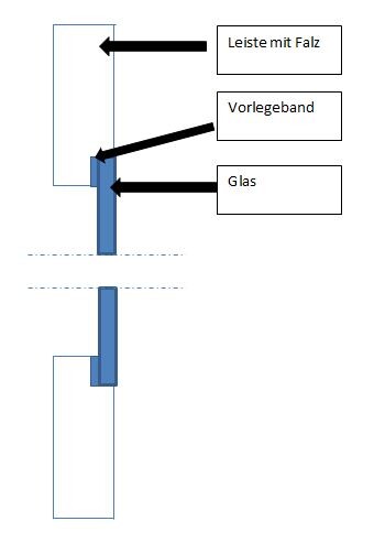

My uncle (who owns a glass workshop) attaches mirrors and glass panels, as far as I know, using special mirror adhesive tape. If needed, this can be removed with fishing line.
However, the tape has to hold not only the glass panel but also hooks and a jacket. Therefore, it is definitely worth considering framing the panel in wood or at least attaching something at the bottom to support it.

Otherwise, I would treat a glass shelf like a board and use two supports, whatever kind.
After reading through the threads, it seems to be about a back panel? That logic doesn’t make sense to me. Treat the back panel like a mirror wall. Otherwise, there are hooks designed for smooth surfaces as well 🙂
