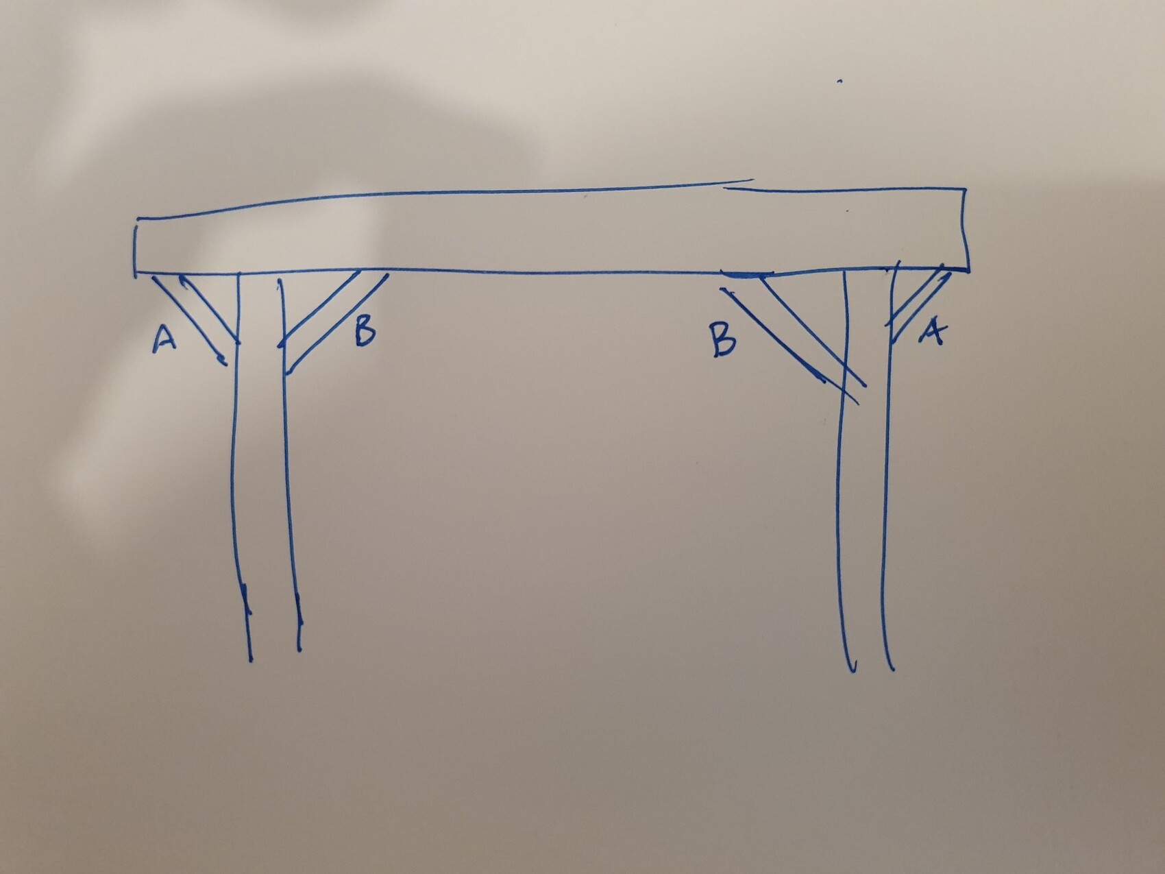

28 Jan 2023 09:17
The carport kit did not include any diagonal braces. So I will make them myself. This raises the question about their placement. Can the braces be attached at position A or B, or does it have to be specifically at B? (see attachment)
Sketch of a table with two legs and diagonal braces A and B.
