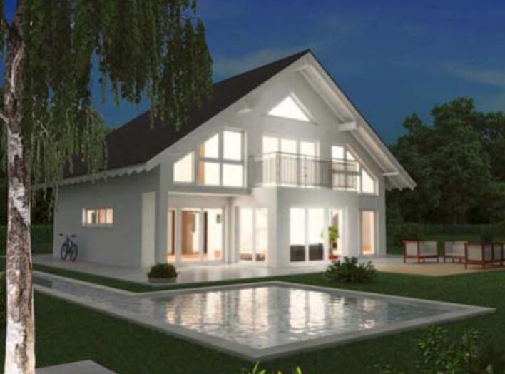

Bau-Teufel schrieb:I’ve attached a picture of a comparable house – solidly built – a reputable general contractor can also build a bright, well-lit house, as long as his concept allows for flexible planning.
So before more confusion arises, I thought I’d try to find out what the advantages and disadvantages of the two options are, to get a basic idea of the better approach for us (I just hope I expressed myself clearly enough)
