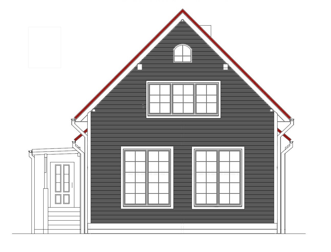

In der Ruine11 Oct 2021 13:06
@ypg
I have taken up your idea of the three-part window.
@Snowy36
Your idea wasn’t bad. It should definitely go in the direction of a Swedish-style house.
But on top, there should be a semicircular window for the attic.
Two-story house line drawing with dark wood cladding, white windows, and red roof trim.
11 Oct 2021 13:11
Although the muntins in the upper floor window are not correct (I assume this was unintentional?), the overall appearance already looks a bit more harmonious now. What do you think yourself?
