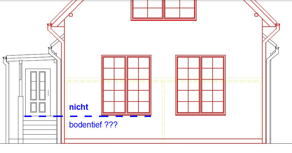

I have read several times that symmetrical facades are not particularly popular among experts.
What is the right degree of asymmetry? The golden ratio? The Fibonacci sequence?
What makes a building interesting, and do you have any examples?
I, of course, designed my extension to be perfectly symmetrical.

I’m not particularly familiar with experts. Regarding symmetry, I regularly point out a) that it can be overdone; b) that it complements but does not replace proportion and other aspects or dimensions of aesthetics; and c) that when given too much priority, it can dangerously compete with more refined planning values, leading to poor design quality. A toxic combination of symmetry and a straight staircase can turn a beautiful house into a pseudo-mansion.
Golden ratio / Fibonacci, Collatz, Euler... – You should plan the extension more harmoniously. I hope you’re not seriously considering that Frankenstein extension: having the knee wall only on the extension just doesn’t work; plus the window sizes don’t reflect the scale of the main house. Also, floor-to-ceiling windows, oh dear. And then the horizontal window in the upper living area – what on earth!Where can you see the rest of the house and that this wouldn’t fit?
Personally, I like the design in a Büllerbü style….

Can someone explain to me why I am paying €4,000 for an architect and he doesn’t tell me something like this? [...]
4. The building permit / planning permission is approved, there isn’t much room left for major changes.
Maybe I should have asked this forum earlier. How would you have handled this? You definitely should have consulted the forum earlier. Then you wouldn’t be facing the question of how someone who posted here just now can ask why their architect didn’t inform them of this :-(
As I tried to explain in my previous reply, I would have derived the additional elements based on the existing concrete features and proportions. Did you actually hire an architect, or rather a structural engineer?
In der Ruine schrieb:
What exactly is the problem with the knee wall? Too small? Too high? Only in the extension.
@11ant
A real architect already.
There are two steps down to the lower part of the extension. That is why the windows are not floor-to-ceiling.
There are two steps down to the lower part of the extension. And then up again to the door, from where it goes down again? I’d say it wouldn’t hurt the overview if you showed the entire renovation here.
