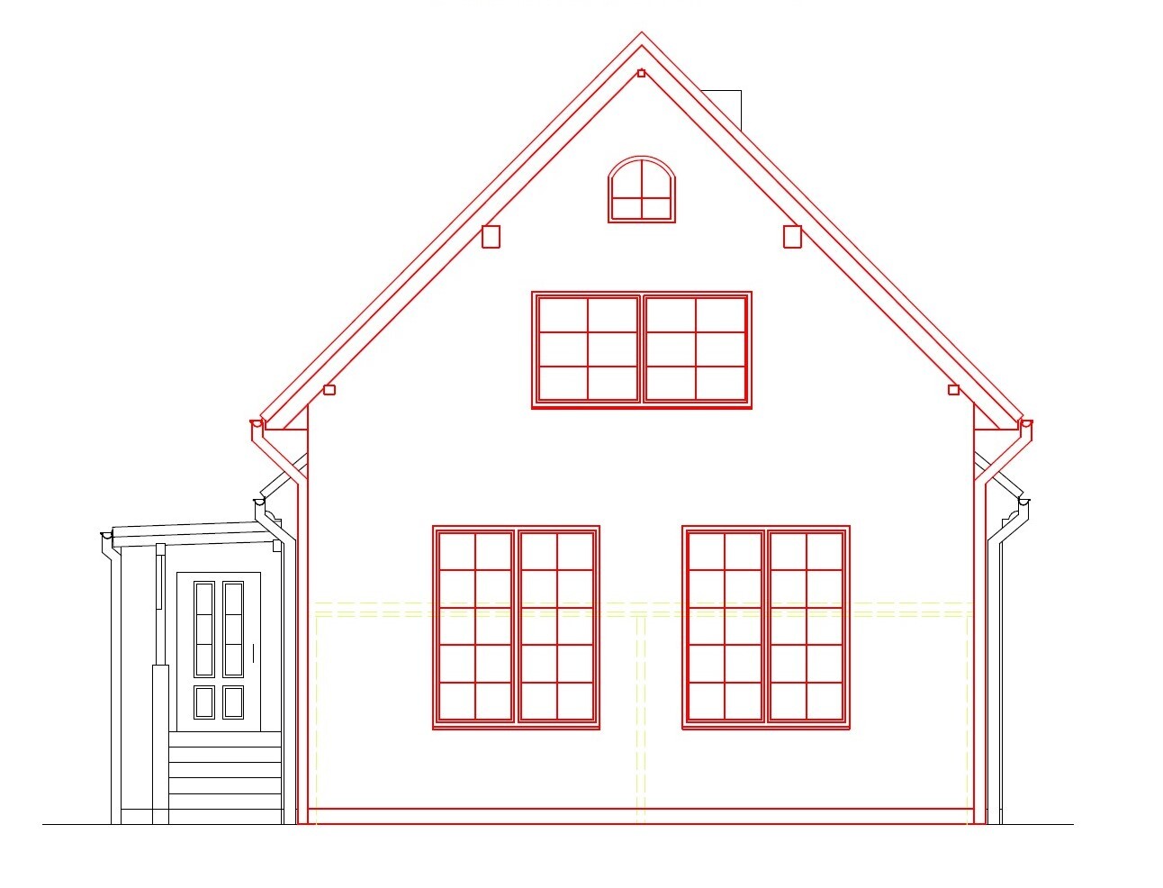

I have read several times that symmetrical facades are not particularly popular among experts.
What is the right degree of asymmetry? The golden ratio? The Fibonacci sequence?
What makes a building interesting, and do you have any examples?
I, of course, designed my extension to be perfectly symmetrical.

Of course, I planned my extension to be perfectly symmetrical. I’m not particularly familiar with experts. Regarding symmetry, I usually point out a) that it can be overdone; b) that it cannot replace proportion and other aspects or dimensions of aesthetics but only complement them; and c) that if it is given too high a priority, it can effectively compete with more refined values in planning quality, often with disastrous results. With a toxic mix mainly made up of symmetry and a straight staircase, you can turn a beautiful house into a substitute villa.
Golden ratio / Fibonacci, Collatz, Euler, ... — you’d be better off planning the extension harmoniously. I hope you’re not serious about this Frankenstein extension: an kneewall only in the extension is simply not acceptable; on top of that, the window sizes don’t respond to the scale of the main house. And floor-to-ceiling windows, yikes! Then the horizontal format in the upper living space — damn, that’s hell!

Of course I designed my extension perfectly. What does that even mean: no sense of harmony, no knowledge of shapes, proportions…planned symmetrically.What does that even mean: no sense of harmony, no knowledge of shapes, proportions… This can be seen in this example: harmonious means something different, you might be dazzled looking at the “great windows,” but nothing really fits, not even the window grid itself.
The “perfectly designed” to me is not really successful. I’m looking for the pun here 😉
(I honestly find it extremely unsuccessful. Sorry!
Window divisions are inconsistent, sometimes horizontal, sometimes square, with all kinds of proportions between them…)
You can’t really call this beautiful. And this is not just “opinion.”
