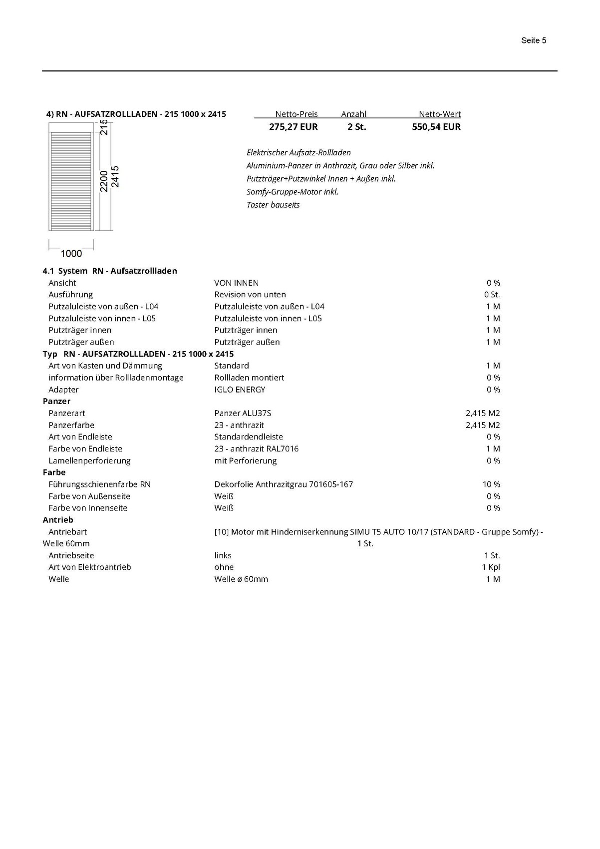

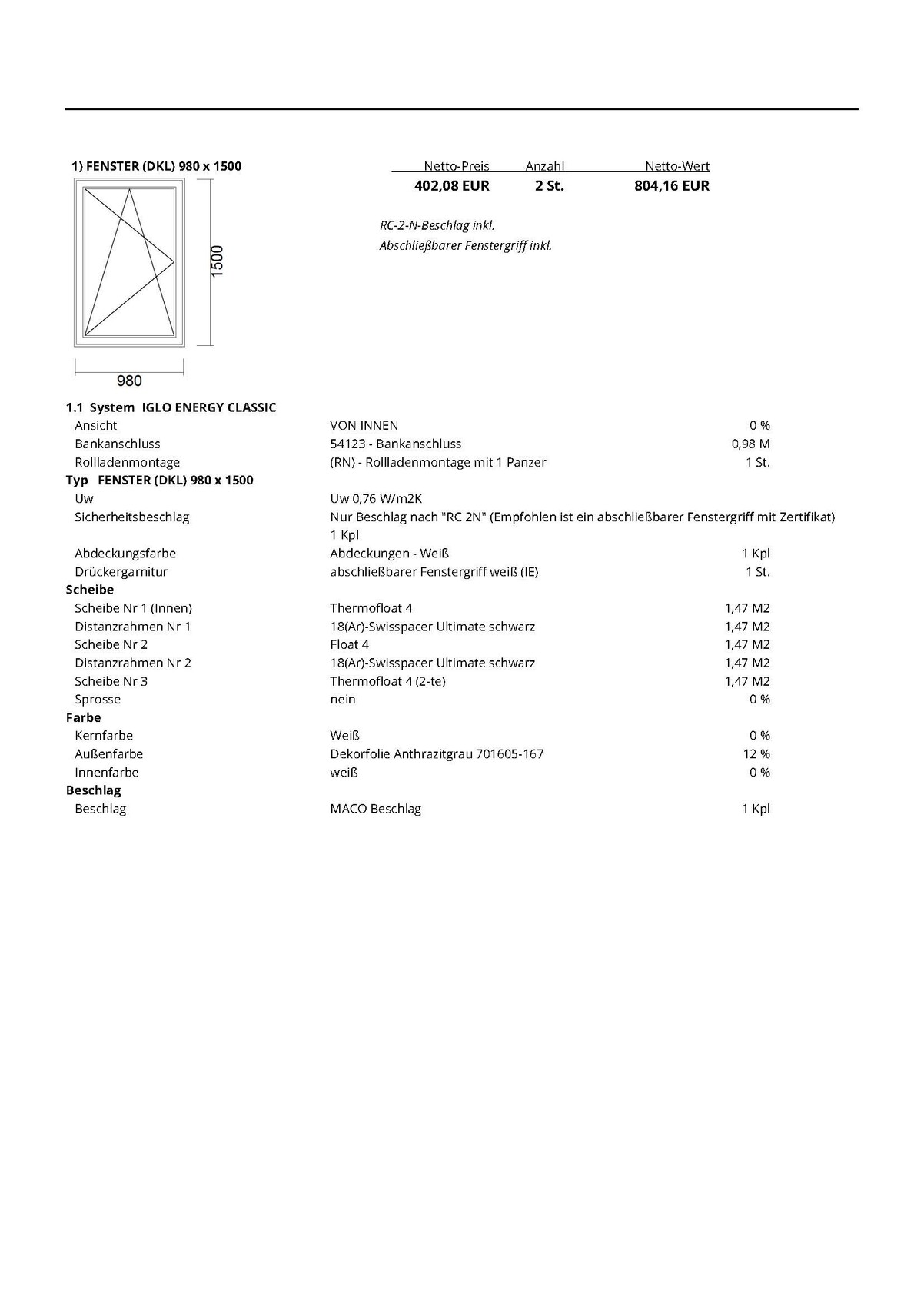

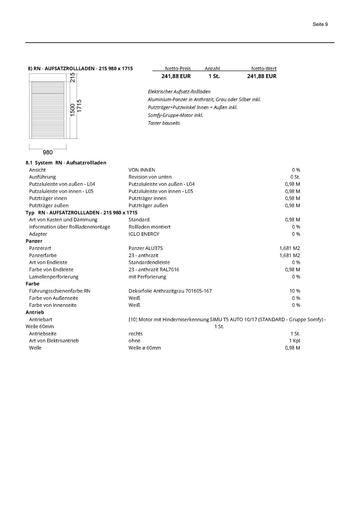

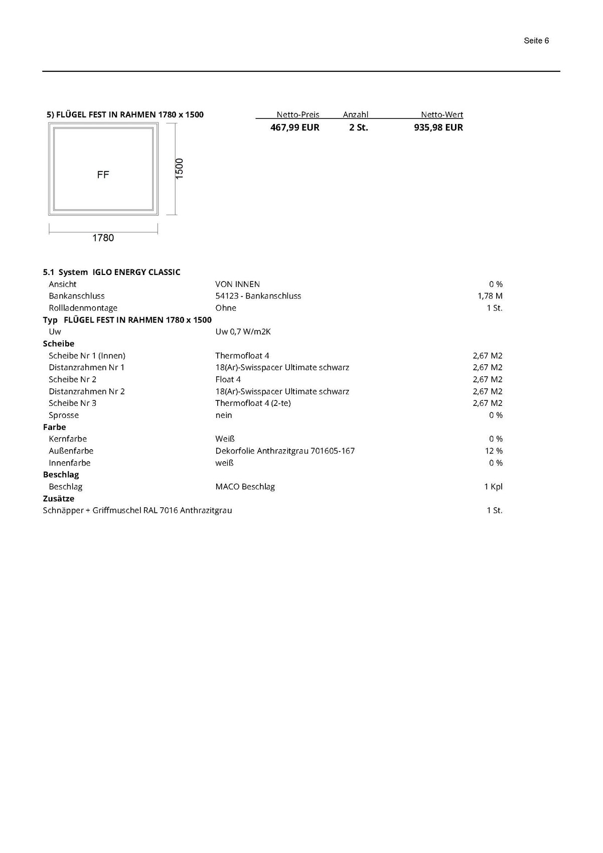

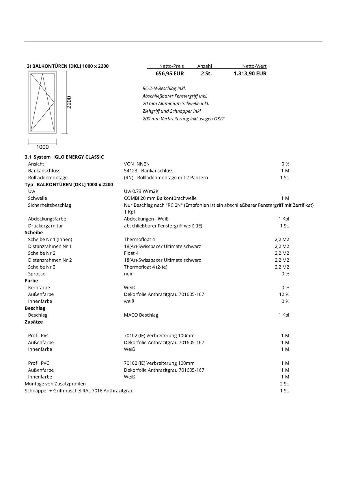

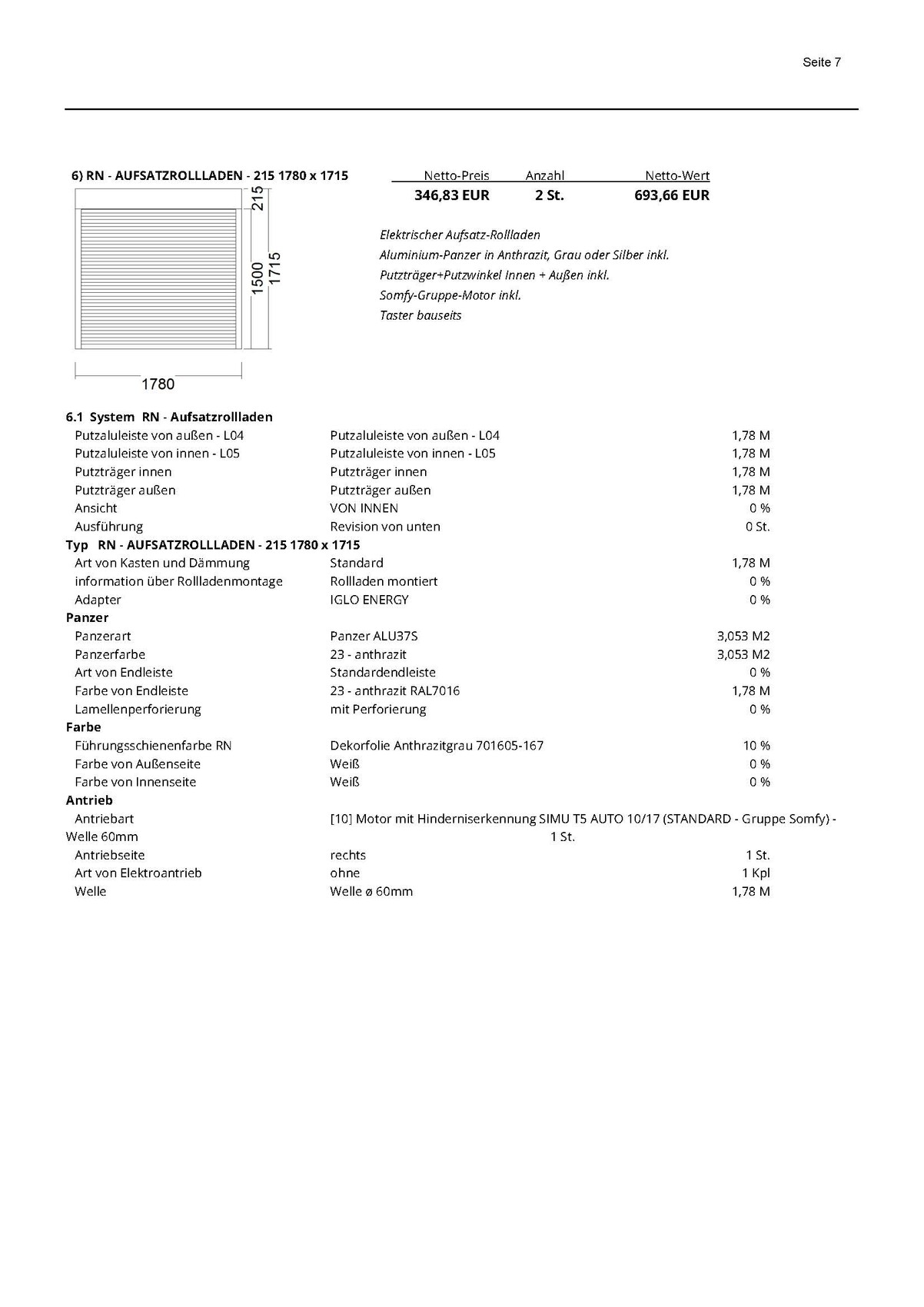

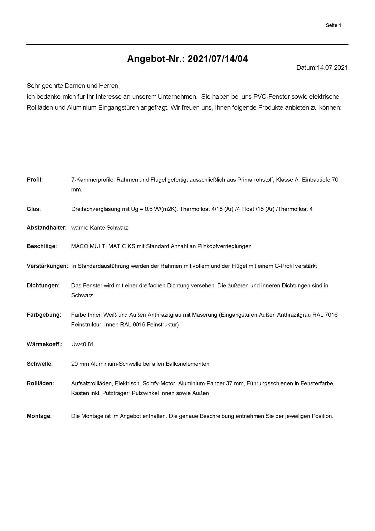

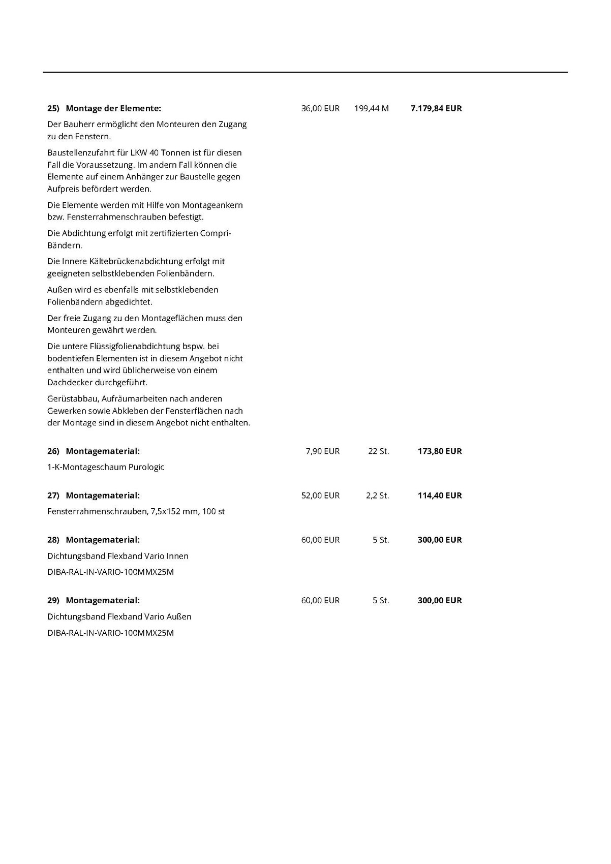

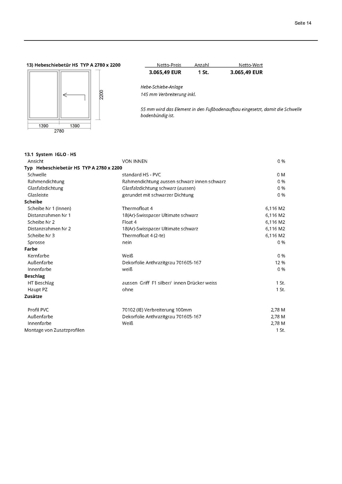

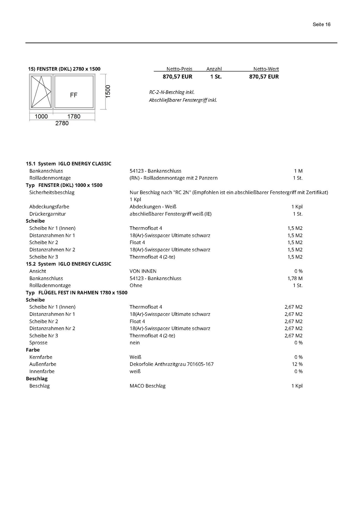

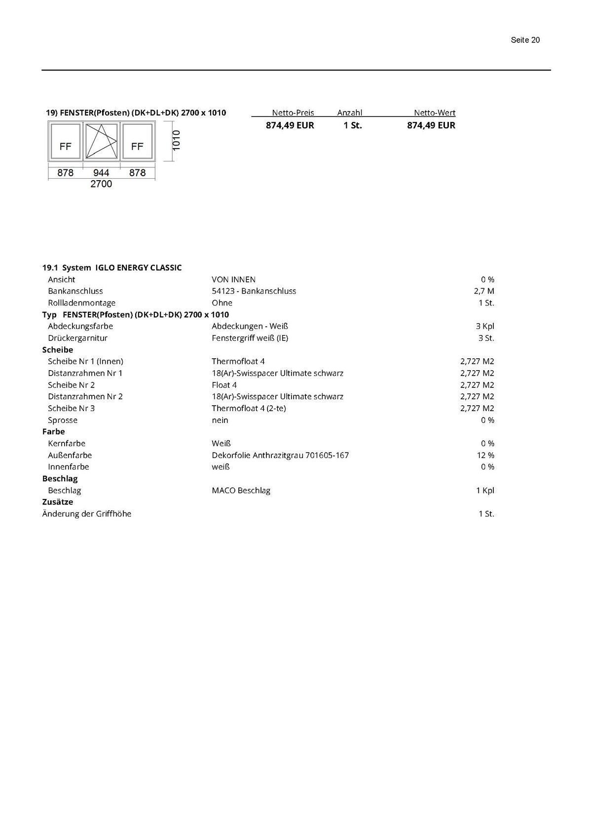

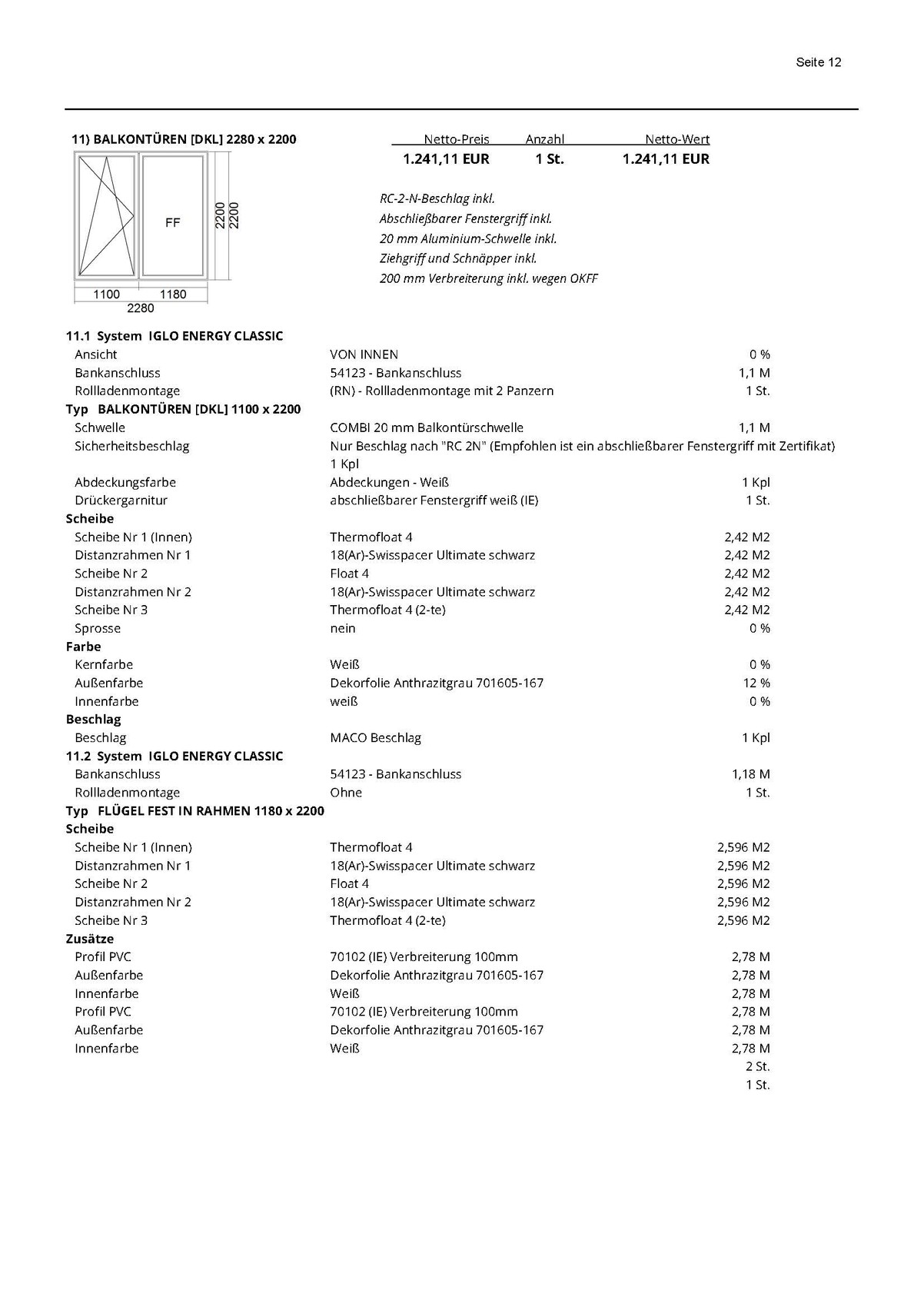

Hi, I have received a quote for windows and would appreciate your feedback!
Thanks in advance 🙂
Since I cannot upload a Word or PDF file, the quote is divided into 25 images!
Offer page No. 2021/07/14/04, date 14.07.2021; profile, glass, fittings, seals.

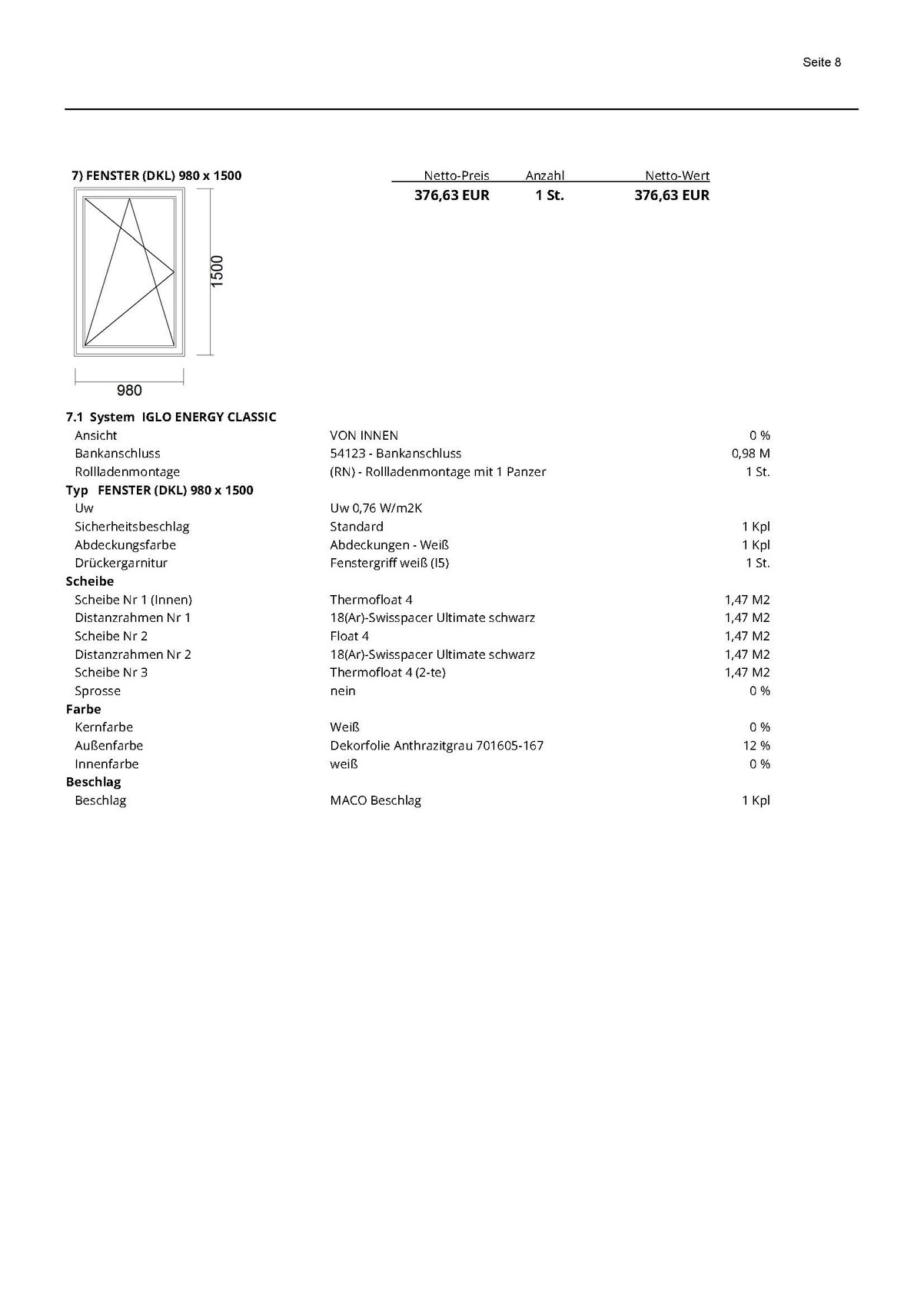

Technical drawing of a window (DKL) 980 x 1500 mm (39 x 59 inches) with price table.

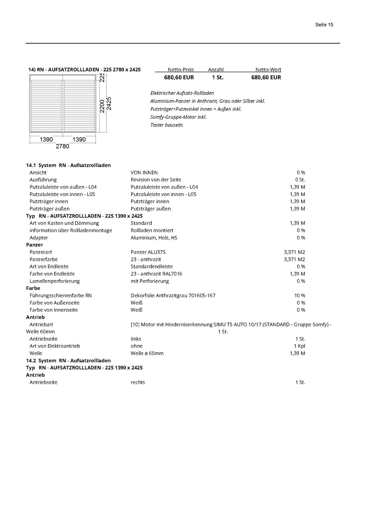

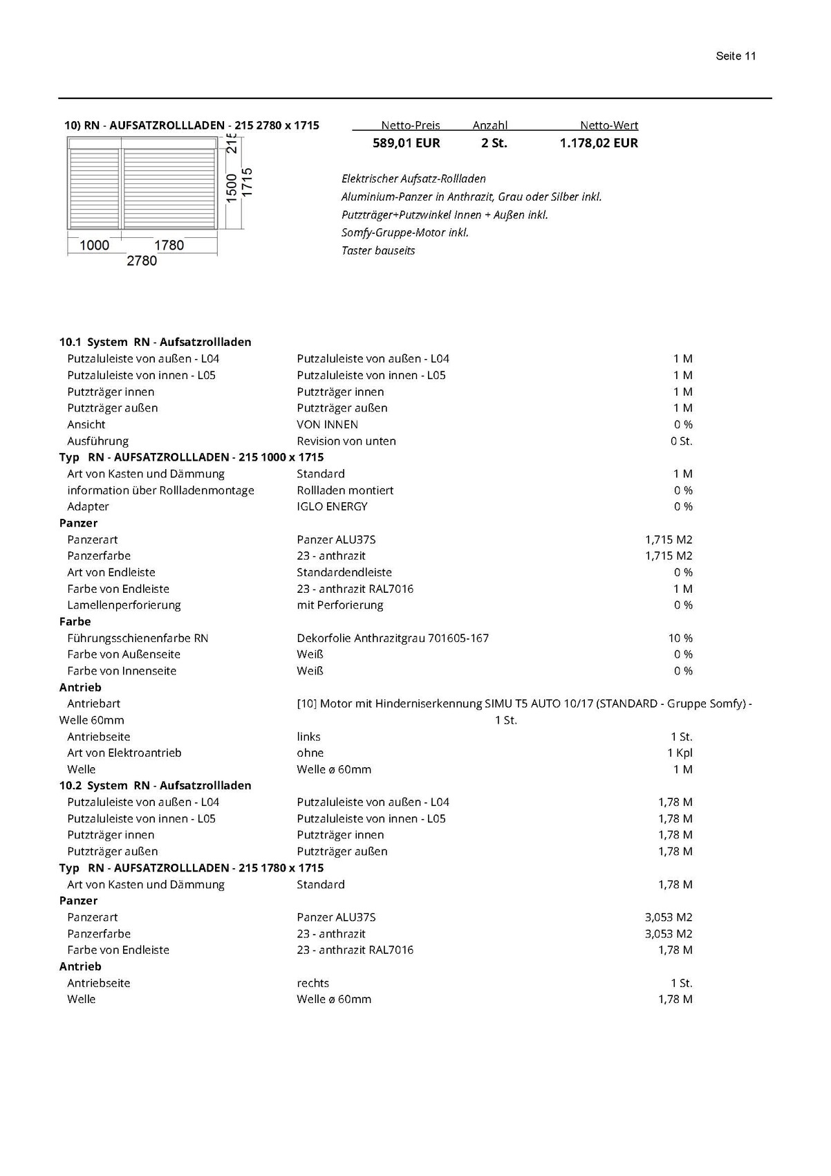

Technical drawing of an RN surface-mounted roller shutter system with dimensions and price details.
Technical drawing of a balcony door 1000 x 2200 mm (39 x 87 inches) with frame and dimensions.
Technical sheet page with diagram of an RN surface-mounted roller shutter and pricing information.
Sketch of a square window frame (FF) 1780 x 1500 mm (70 x 59 inches) with price 467.99 EUR
RN surface-mounted roller shutter: technical drawing with dimensions 215 x 1780 x 1715 mm (8.5 x 70 x 68 inches) and specifications.
Technical drawing of a window (DKL) 980 x 1500 mm (39 x 59 inches) with measurements.
Technical drawing of an RN surface-mounted roller shutter with dimensions 215 x 980 x 1715 mm (8.5 x 39 x 68 inches) and price information.

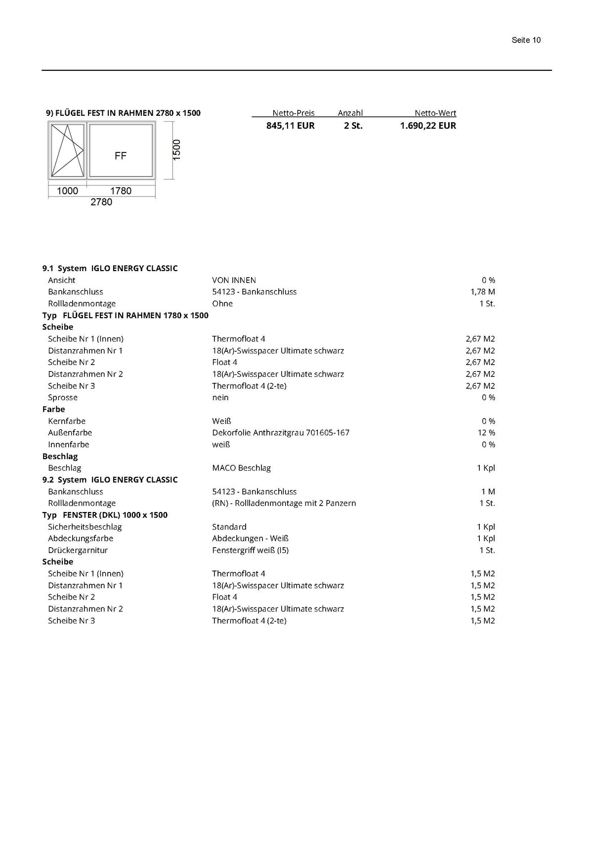

Technical drawing of a window frame 2780 x 1500 mm (109 x 59 inches) with price list and system details.

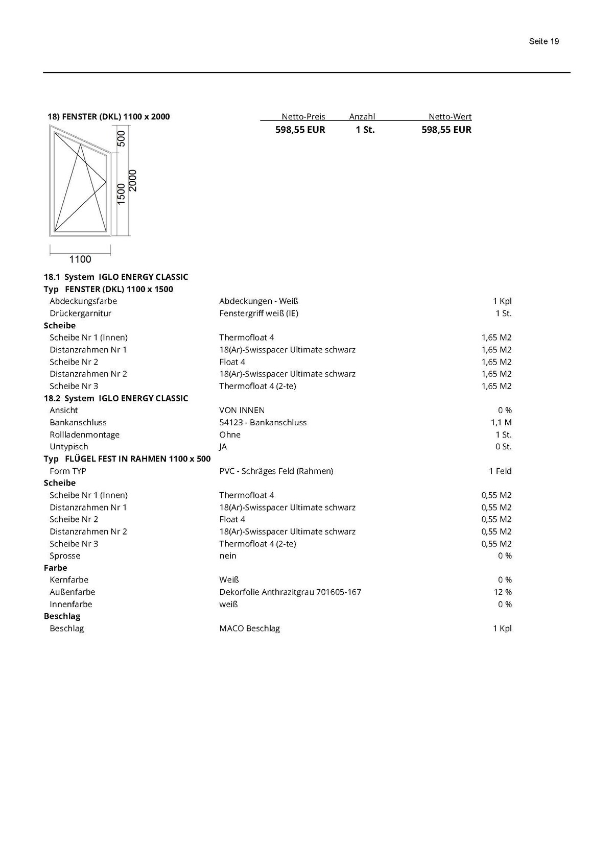

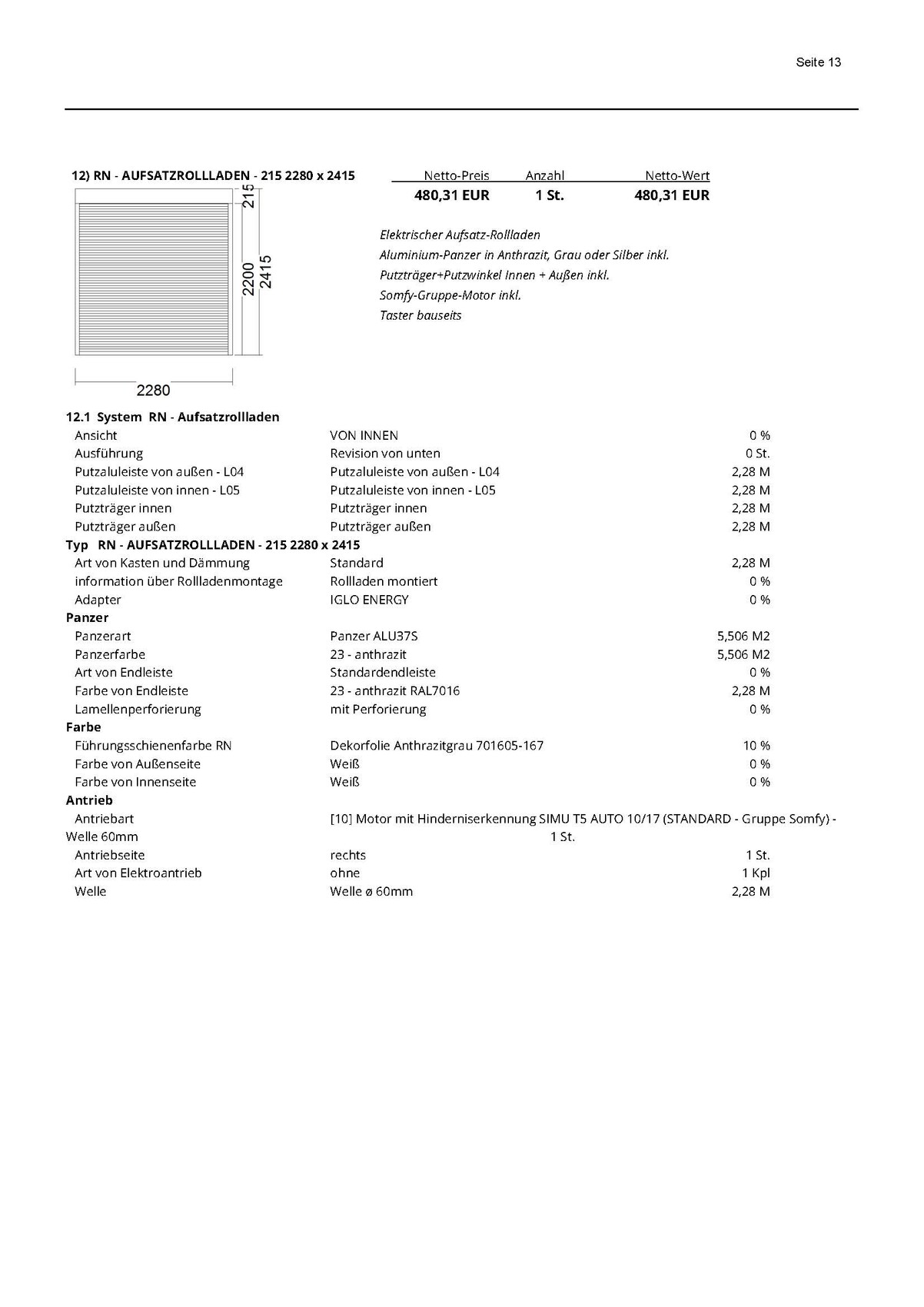

The second part of the offer....
Technical drawing of an RN surface-mounted roller shutter with dimensions 2780x1715 mm (109.4x67.3 inches)
Technical drawing of a balcony door measuring 2280 x 2200 mm (89.8 x 86.6 inches), specifications IGLO ENERGY CLASSIC
Technical drawing of an RN surface-mounted roller shutter with dimensions 215×2280×2415 mm (8.5×89.8×95.1 inches) and price 480.31 EUR.
Sketch of a lift-and-slide door HS Type A 2780x2200 mm (109.4x86.6 inches) with dimensions.
Technical drawing of an RN surface-mounted roller shutter with dimensions 225 2780 x 2425 mm (87.8 x 95.5 inches) and key data.
Technical drawing of a window 2780x1500 mm (109.4x59.1 inches) with data for the IGLO ENERGY CLASSIC system.
Technical drawing of a surface-mounted roller shutter with dimensions and components.

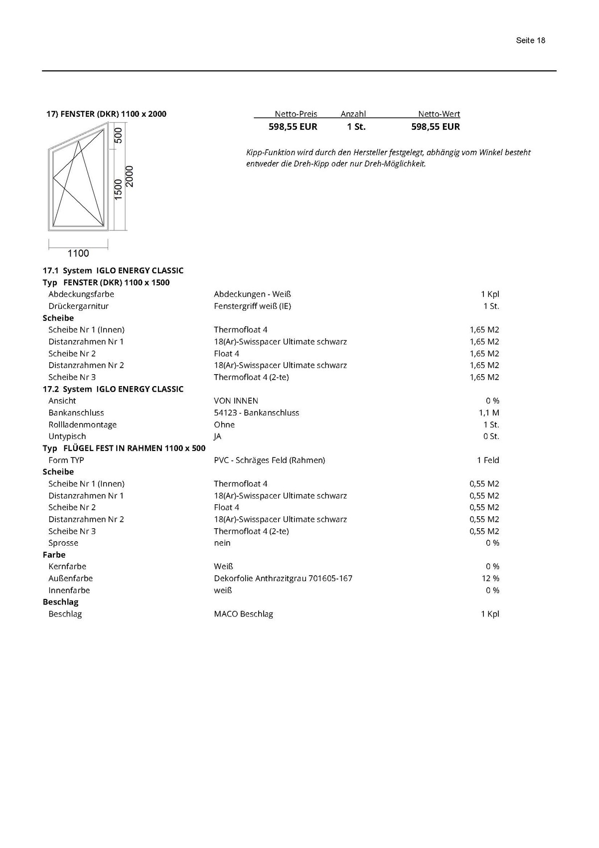

Window diagram IGLO ENERGY CLASSIC, 1100 x 2000 mm (43.3 x 78.7 inches), technical drawing.
Technical drawing of a window with dimensions 1100 x 2000 mm (43.3 x 78.7 inches) and detailed specifications.
Technical drawing of a window (2700x1010 mm / 106.3x39.8 inches) with dimensions, price, and system information.

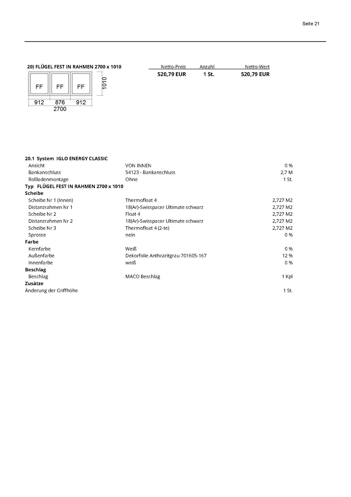

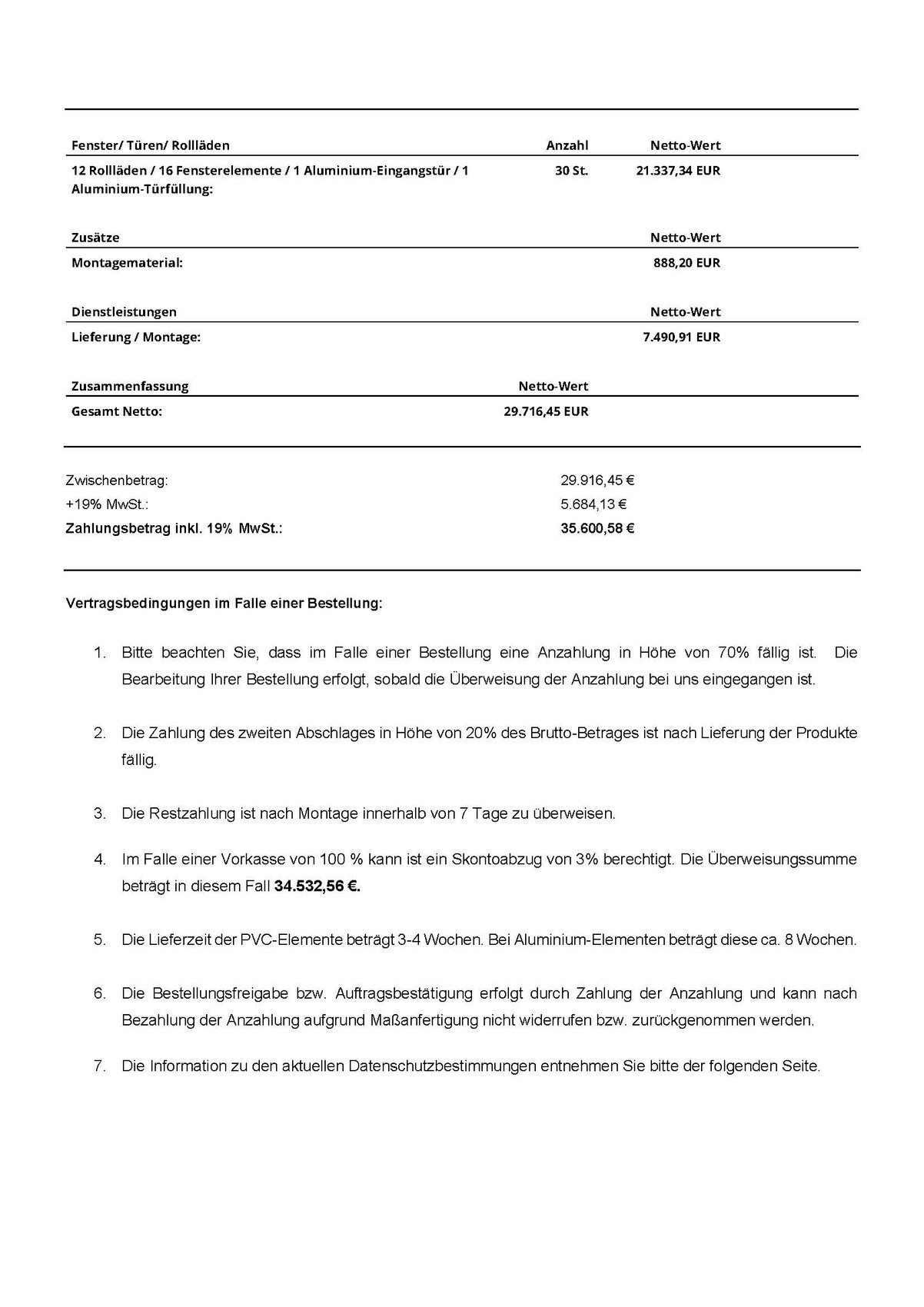

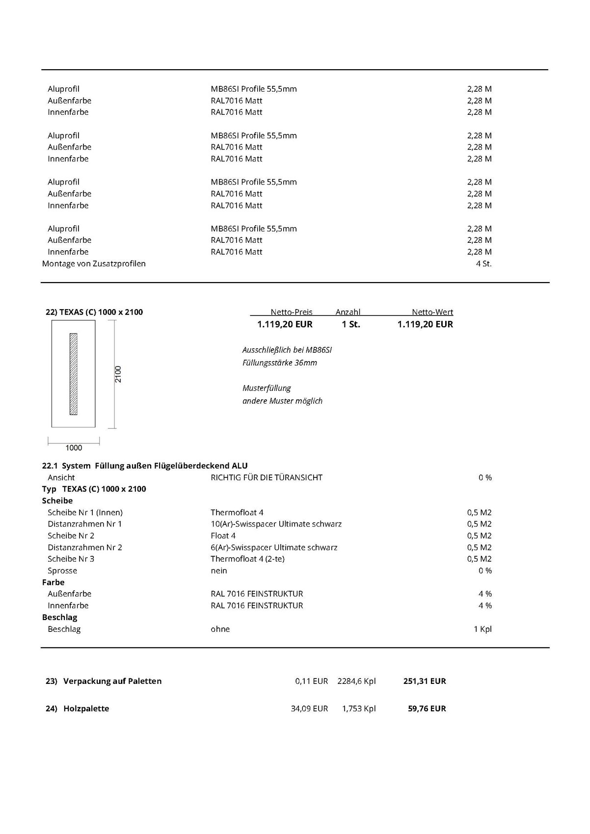

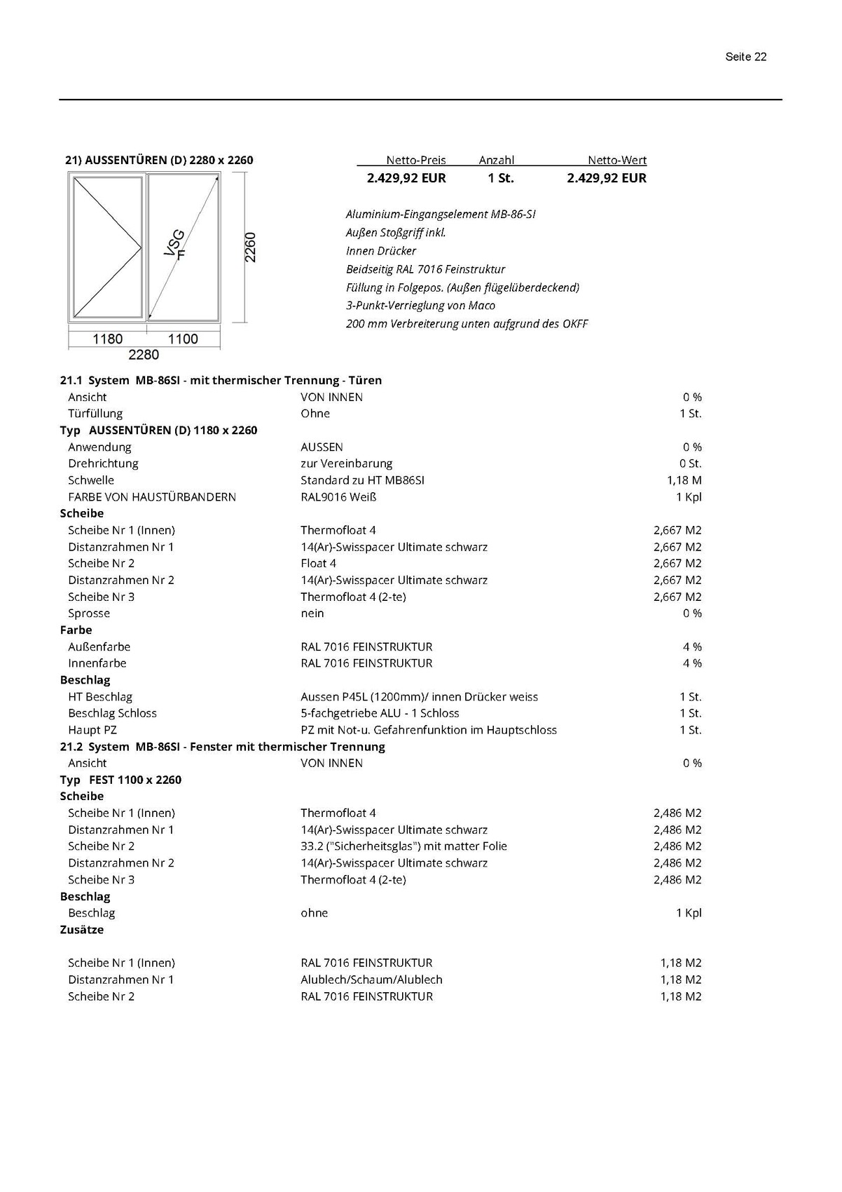

And finally, the third part!!
Technical drawing and price list: Fixed sash in frame 2700x1010 with dimensions.
Technical drawing of an exterior double-leaf door with dimensions 2280 x 2260 mm (90 x 89 inches), aluminum MB-86SI.
Technical price list with dimensions 1000 x 2100 mm (39 x 83 inches) and TEXAS diagram, specifications and prices.
Document page with installation instructions, material list and cost overview in table format.
Invoice page with table layout, line items, net amounts and payment terms.

Summary of my offer:
Profile: 7-chamber profiles, frames and sashes made exclusively from Class A primary raw materials, installation depth 70 mm (2.8 inches).
Glass: Triple glazing with Ug = 0.5 W/(m2K). Thermofloat 4 / 18 (Ar) / 4 Float / 18 (Ar) / Thermofloat 4
Spacer: Warm edge black
Fittings: MACO MULTI MATIC KS with standard number of mushroom head locks
Reinforcements: Standard version includes full reinforcement in the frame and C-profile reinforcement in the sash
Seals: The window is equipped with triple seals. The outer and inner seals are black
Color scheme: Interior white and exterior anthracite gray with wood grain texture (entrance doors exterior anthracite gray RAL 7016 fine texture, interior RAL 9016 fine texture)
Thermal transmittance coefficient: Uw < 0.81
Threshold: 20 mm (0.8 inches) aluminum threshold on all balcony elements
Roller shutters: Surface-mounted roller shutters, electric, Somfy motor (SIMU T5 shaft 60 mm (2.4 inches)), aluminum slats 37 mm (1.5 inches), guide rails in window color, box including plaster carrier and plaster angle inside and outside
Installation: Installation is included in the offer. Detailed description can be found in the respective line item.

2x Tilt and turn windows 980 x 1500 mm (RC2N) Unit price 402.08 € net / 804.16 € Roller shutter unit price 241.88 € net / 483.76 €
2x Balcony doors (tilt and turn) 1000 x 2200 mm (RC2N) Unit price 656.95 € net / 1,313.90 € Unit price 275.27 € net / 550.54 €
2x Fixed sashes 1780 x 1500 mm Unit price 467.99 € net / 935.98 € Unit price 346.83 € net / 693.66 €
1x Tilt and turn window 980 x 1500 mm Unit price 376.63 € net Unit price 241.88 € net
2x Fixed sashes in frame 2780 x 1500 mm Unit price 845.11 € net / 1,690.22 € Unit price 589.02 € net / 1,178.02 €
1x Balcony door (tilt and turn/fixed) 2280 x 2200 mm Unit price 1,241.11 € net Unit price 480.31 € net
1x Lift and slide door Type A 2780 x 2200 mm Unit price 3,065.49 € net Unit price 680.60 € net
1x Tilt and turn window/fixed 2780 x 1500 mm (RC2N) Unit price 870.57 € net Unit price 589.01 € net
1x Tilt and turn window 1100 x 2000 mm Unit price 598.55 € net Not applicable
1x Tilt and turn window 1100 x 2000 mm Unit price 598.55 € Not applicable
1x Window unit (tilt-turn + fixed + tilt-turn) 2700 x 1010 mm Unit price 874.49 € Not applicable
1x Fixed window in frame 2700 x 1010 mm Unit price 520.79 € Not applicable
1x Exterior aluminum door 2280 x 2260 mm (door 1180 mm (46 inches)/ fixed glass 1100 mm (43 inches)) Unit price 2,429.92 € Not applicable
1x Panel TEXAS 1000 x 2100 mm Unit price 1,119.20 € Not applicable
Installation of elements 36 € x 199.44 M 7,179.84 € net
Installation materials (1-component mounting foam Purologic) 7.90 € x 22 units 173.80 € net
Installation materials (window frame screws, 7.5 x 152 mm (0.3 x 6 inches), 100 pcs) 52 € x 2.2 units 114.40 € net
Installation materials (sealing tape Flexband Vario interior) 60 € x 5 units 300 € net
Installation materials (sealing tape Flexband Vario exterior) 60 € x 5 units 300 € net
12 roller shutters / 16 window elements / 1 aluminum entrance door + 1 panel 30 units 21,337.34 € net
Installation materials 888.20 € net
Delivery and installation 7,490.91 € net
Total gross cost 35,600.58 €
