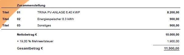

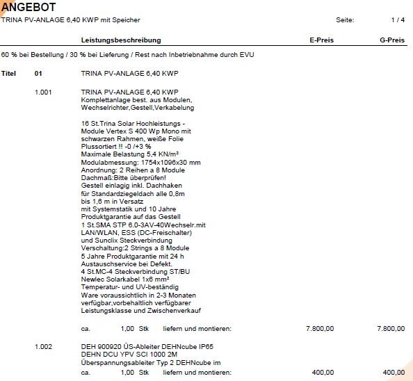

I would like to ask the experts for an assessment of our offer (A1, A2, A3) – as far as it is technically and financially feasible.
We want to fully cover the south side of the roof (total 6.4 kWp (kilowatt peak)) without storage. Since we will also be getting a heat pump (SG ready), we want to supply it with photovoltaic power.
The system can be installed directly at the beginning of September, right after the roofer’s work is finished. It will be handled and carried out by an acquaintance who is always available to support us with advice and assistance. We are newcomers in this field ourselves.
With a total net cost of 10,000 €, I calculate an average of €1,562.50 per kWp.

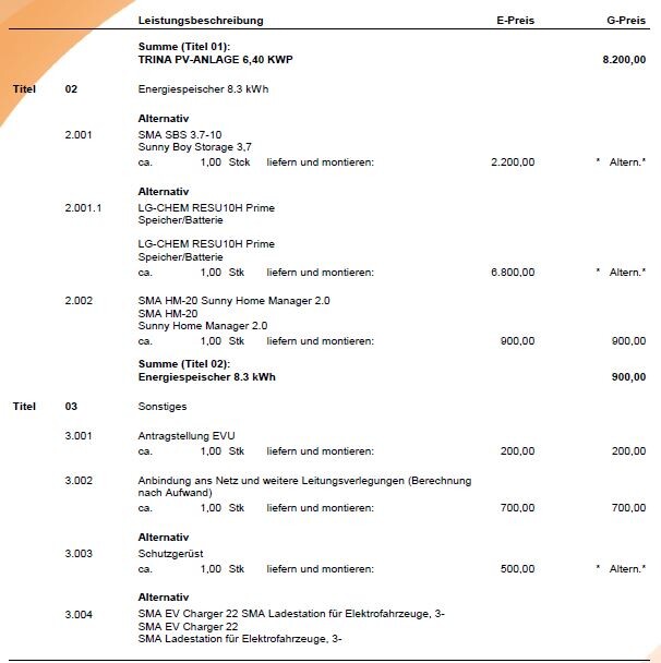

Title 02 in the summary refers to the Home Manager, not to the energy storage (which I had removed from the offer, as it was originally included).
I look forward to your feedback.

For the size of the system, the price is still reasonable. Of course, it would be more worthwhile if you also fully utilize the north side. How steep and how north-facing is the north roof?

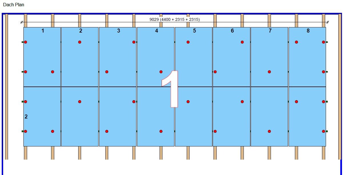

Have you checked whether you can fit four rows across? You can also place the panels much closer to the ridge and closer to all edges.
If there are still any roofing works planned, could you possibly adjust the roof overhang so that more panels can be installed?
The goal should be not just to build a 6.4 kWp system. In the future, that would be just a drop in the bucket for an electric car’s roof load. Crosswise installation, four rows, including the north side, would already bring you to 16 kWp. Then an electric car can start charging more consistently. And in winter, during gloomy weather, if only about 10% of the system’s capacity is available, that will still be enough for the house and heat pump combined.
Regarding roofing work: The roofers should install the hooks right away. That way, you won’t have to remove all the tiles again a few days later.

The north roof is more northwest, with an azimuth angle of about +135 degrees. According to PVGIS, that results in an annual energy production of 647 kWh per 1 kWp. I wouldn’t mind installing modules there as well (e.g., 3.5 kWp?), but I can’t really judge if that’s worthwhile. I’ll talk to my electrician to see how that affects the average price per kWp. The roof pitch is about 35 degrees.
In the next few years, we plan to replace the old double garage with a carport, which will give me plenty of additional space for photovoltaics.

650 kWh/kWp is usually not bad. A year ago, this was clearly economically viable. Currently, prices have increased significantly, which makes it a bit more challenging.

If a south-facing system currently costs 1500 euros, adding 3 kWp more will reduce the cost to 1400 euros for the south-facing part. Each additional kWp on the north side should then cost only 900 euros. That makes it worthwhile.
Where you can save money: a meter replacement is free. Anyone who says otherwise is not telling the truth. Only the solar installer’s electrician is authorized to commission the system. Your grid operator is welcome to come by but does NOT get paid for it. This is exactly stated in the Renewable Energy Act and Metering Point Operation Act.
