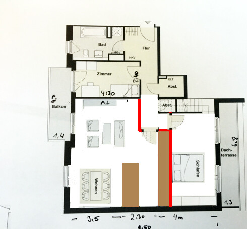

I would appreciate your feedback on the attached floor plan (not a house!).
I know this is a house building forum, but maybe someone still wants to help.
Since it is a new build, the floor plan can still be changed.
Where do you see needs or weaknesses in the floor plan?
Here are the changes I am considering:
- Change the shower bathroom to a guest toilet (see picture below), advantages: private access and more closet space behind the bedroom door possible
- Include a shower in the bathroom, possibly omitting the bathtub
The stairs behind the dining table lead to another roof terrace on top of the building.

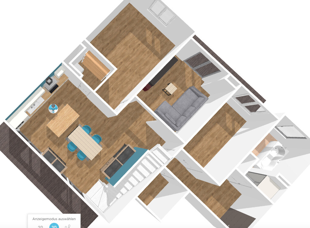

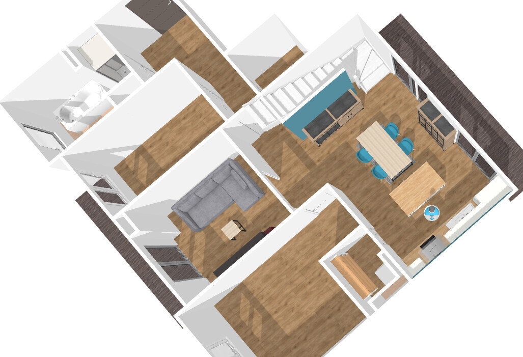

I think the wall layout makes sense, and I have a suggestion—this time in color.
I would use the first storage room for coats, clothing, an ironing board, and similar items, and the second smaller one for the mop and vacuum cleaner. I turned the WC into a utility room, which has space for a large shelf for the drill and Miracoli.
In the bathroom, the shower has been relocated to the washing machine niche. Be sure to check that a shower with the necessary depth fits there. Overall, I would also pay close attention to the doors. I made the doors for the storage rooms 10 cm (4 inches) narrower.
I’m not so happy with the living room here, but I did use large furniture everywhere. On the other hand, the kitchen is already a small gem for an apartment.
