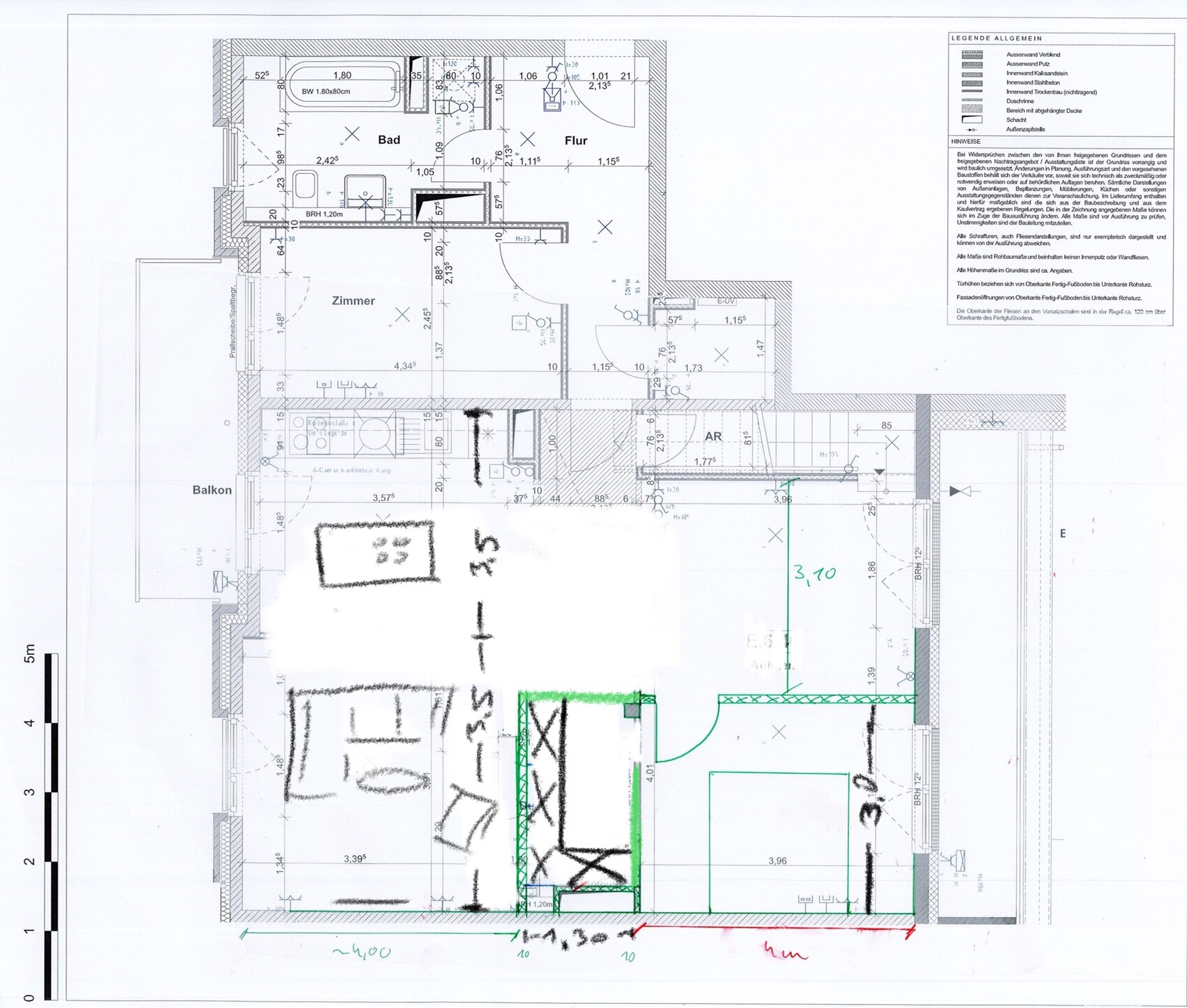

I would appreciate your feedback on the attached floor plan (not a house!).
I know this is a house building forum, but maybe someone still wants to help.
Since it is a new build, the floor plan can still be changed.
Where do you see needs or weaknesses in the floor plan?
Floor plan of an apartment with kitchen, living room, bedroom, bathroom, balcony, and roof terrace.
Here are the changes I am considering:
- Change the shower bathroom to a guest toilet (see picture below), advantages: private access and more closet space behind the bedroom door possible
- Include a shower in the bathroom, possibly omitting the bathtub
Floor plan of an apartment: bedroom, room, kitchen, living area, bathroom, hallway, balcony.
The stairs behind the dining table lead to another roof terrace on top of the building.

Hamburch schrieb:
Whoever has the ultimate solution will get 100€ in cash
You’ll be able to keep that: I see this jackpot remaining unclaimed. Multi-story apartment construction isn’t a free-for-all; predetermined downpipe locations and load-bearing structures that need to be coordinated with other floors already impose significant constraints on creativity.

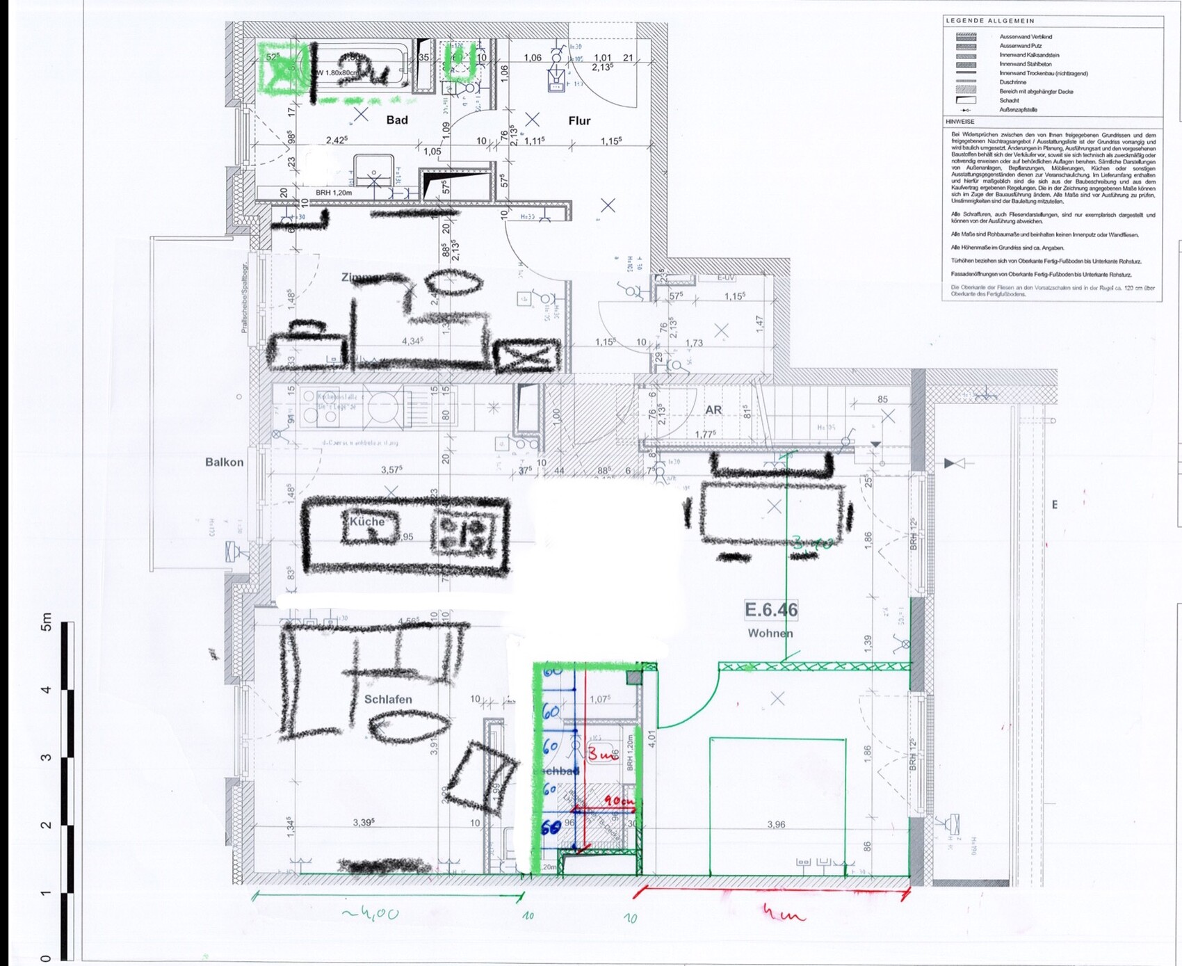

Update
Floor plan of an apartment: kitchen, bedroom, living room, bathroom, balcony; with measurements.
11ant21 Jan 2019 17:20
Hamburch schrieb:
Update
I would be lying if I claimed to fully understand this:
Solid green shading and green crosshatching seem to mean the same thing, or maybe not (?)
So, should the pipe shaft near the wardrobe be removed or not; the wall between the bed and the dining table is apparently to be kept, but it is crosshatched …
At least the walls are clearer here: apparently 15 cm (6 inches) of concrete (load-bearing) between the kitchen and the children’s room, and otherwise gypsum board walls.
Hamburch
21 Jan 2019 22:35
Sorry, here is a clearer version.
Yes, green means the same thing throughout.
Floor plan of an apartment: bathroom, hallway, room, balcony; dimensions and colored markings.
Climbee26 Jan 2019 11:02
Make the entrance to the bedroom through the walk-in closet
Hamburch
26 Jan 2019 11:49
Why?
