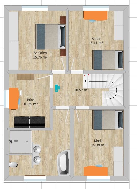

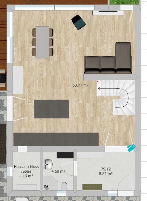

we have purchased a 337 m² (3623 ft²) plot on which we now want to build our semi-detached house. We are in discussions with various construction companies, but their approaches vary widely. Since we are often presented with floor plans based on our key specifications that we don’t like at all (often a standard run-of-the-mill semi-detached house), we have started to think about it ourselves. It’s also quite different that one company has a problem with the structural engineering for a ground floor measuring 8 x 12 m (26 x 39 ft), while another does not. Our wish is also to have the technical equipment on the attic floor (see separate thread).
Now I would like to get your opinion on our DIY floor plan. Does it make sense? What have we overlooked? Constructive suggestions are welcome, as I don’t really like, for example, the bathroom/office solution on the upper floor.

Room requirements ground floor, upper floor: ground floor airy, bright, spacious; upper floor 3 bedrooms, bathroom, office
Office: family use or home office? Home office

Open kitchen, cooking island: open with island
Number of dining seats: 6

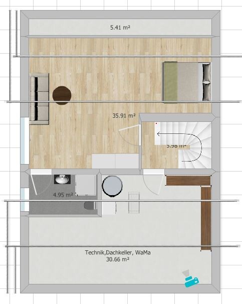

- House technology preferably in the attic since we usually spend most time on the ground floor and want plenty of space there
- Avoid standard floor plan with U-shaped staircase if possible, therefore the compromise of a V-shaped staircase with glass railing on the ground floor, open without storage under the stairs, winding stairs connecting ground floor and attic
- Lots of window area, lift-and-slide windows on the ground floor with external blinds because of south-facing side
- Kitchen and lounge somewhat separated and not too close to each other
- Ceiling height on the ground floor at least 2.65 m (8.7 ft)
- Make use of sloped ceilings in the attic space

What do you like most? Why? Open living space, open stairway
What do you dislike? Why? Bathroom/office on the upper floor

- Cannot give up: separate office

I haven’t received anything from you yet, not even in the spam folder.Oh, sorry, I thought no one had replied in the thread anymore and just noticed it now. Should I send you a private message? Or am I missing something? 😳 🙄For completeness, here are the revised DIY floor plans. Most of the providers have now mostly adopted them as well. However, I don’t have them here because they keep being removed 🙄 🙄
I always find Katja’s suggestions very good, but in my specific case, a home office would be missing on the upper floor.

A lot has already been said about the floor plans, but I still find them unsatisfactory (stairs, hallway, attic, etc.).

I always find Katja’s suggestions very good, but in my specific case, there would be no study room on the upper floor. I don’t quite understand that. There is an office on the upper floor—do you need two? Or is the attic not going to be converted?
