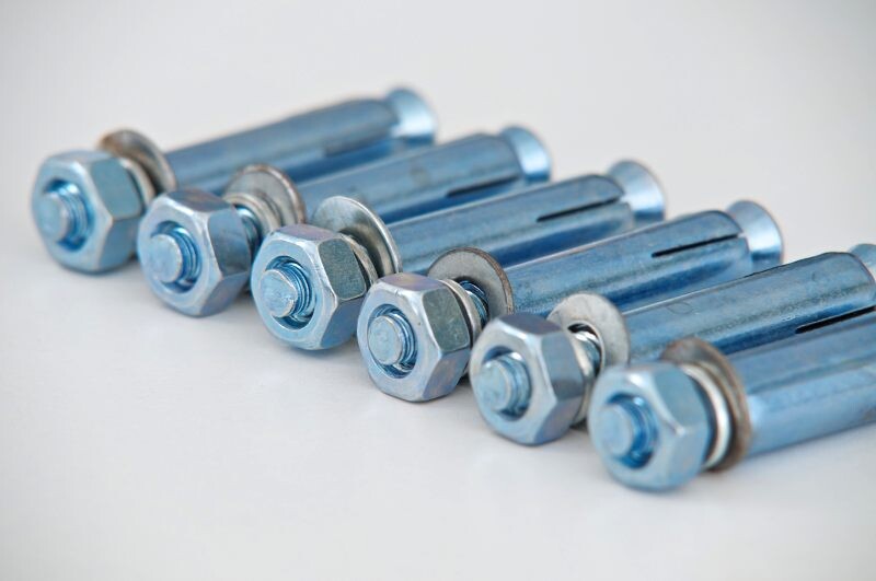

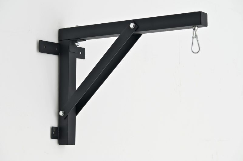

First of all, thank you very much for the quick response. Attached are some photos of the anchors, the bracket, and the punching bag (right variant).
I assume that the existing masonry is also plastered (1-2 cm (0.4-0.8 inches)?). This means that the 6 anchors are each only firmly embedded about 4-5 cm (1.6-2 inches) deep. Additionally, due to the leverage effect, essentially all the weight rests on the top 4 anchors. Since sand-lime brick (possibly even hollow brick) is much less stable compared to concrete, I now have some concerns.
To clarify the dimensions: It is a 70 kg (154 lbs) and 1.80 m (5 ft 11 in) long punching bag (lever arm), intended for training punches and kicks (jerky/impact loads).
I think mechanical anchors, regardless of type (except heavy-duty anchors), will gradually “work loose” under these conditions. That is why my initial thought was to use the chemical method (injection mortar).
