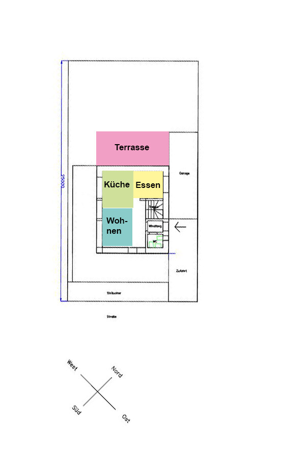

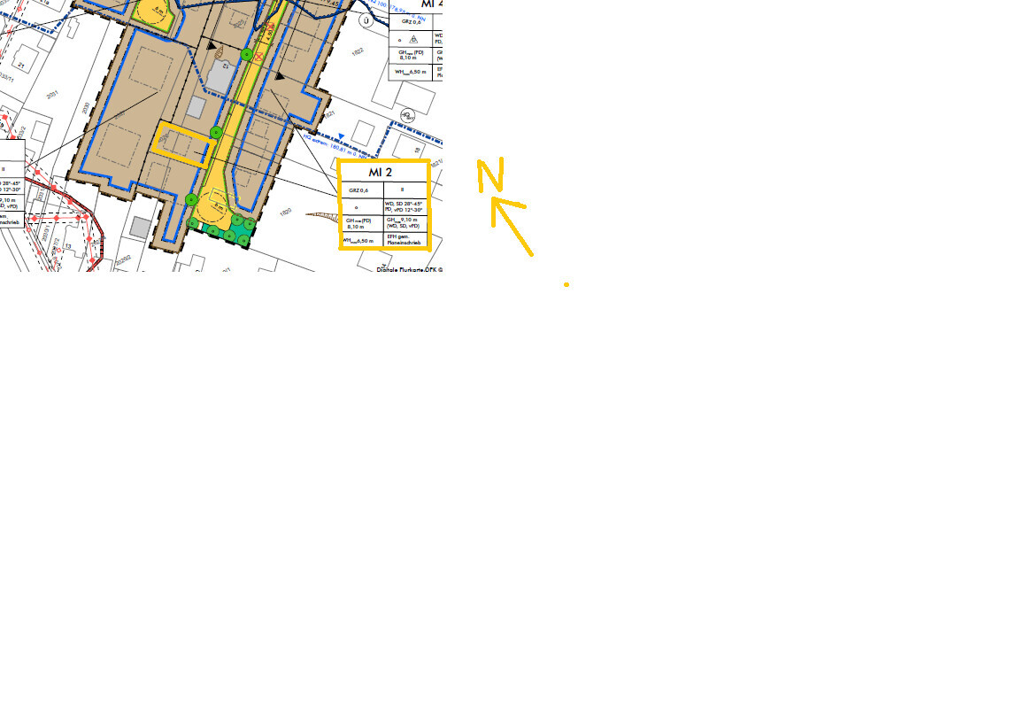

we are considering a narrow plot of 13.5 x 25 meters (44 x 82 feet). A local street (no through traffic) is located to the southeast and currently serves about 5 houses (so traffic is light). The future development of the adjacent plot to the southwest is unknown.
We would like to maximize solar gain, meaning large window fronts on the southeast and southwest sides. Here are my questions: Would a window front facing the street be advisable? Or is it better to sacrifice light and warmth there?

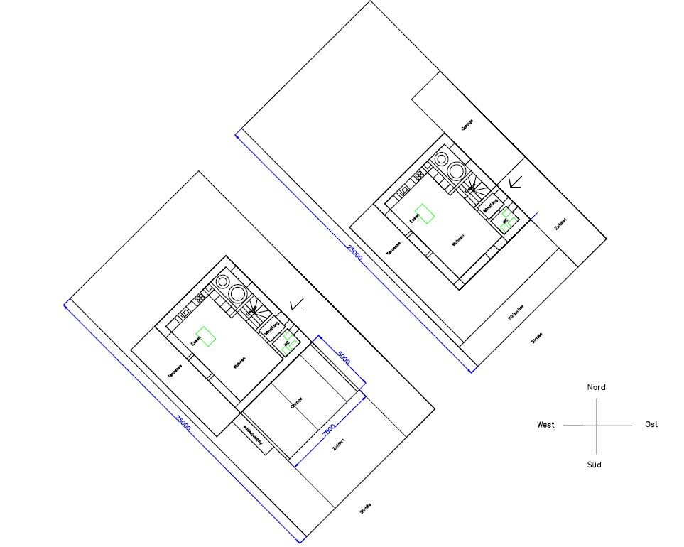

Where would be the best place for a terrace? In front of the house on the southeast side? Between the houses (worst case in a 6-meter-wide (20 feet) “canyon,” with 3 meters (10 feet) being our part, and an eaves height of 6.5 meters (21 feet))?
And where can we also fit the garages? The distance between the garage and the property boundary would be 5 meters (16 feet).
